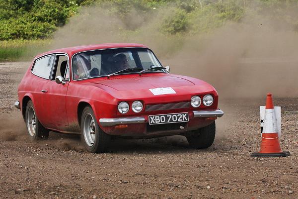

    Pictures, courtesy of Andy Manston M & H Photography
    Parked in the sunshine at the start...
    Did I mention the first test was a bit rough...
    Stopping at a marshal for a signature...
    Best test of the day at Thorpe Abbotts...
