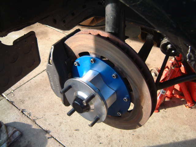

polished it up and fitted new hubs.

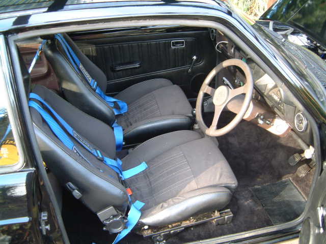

Re: minted my cossie mk2 today

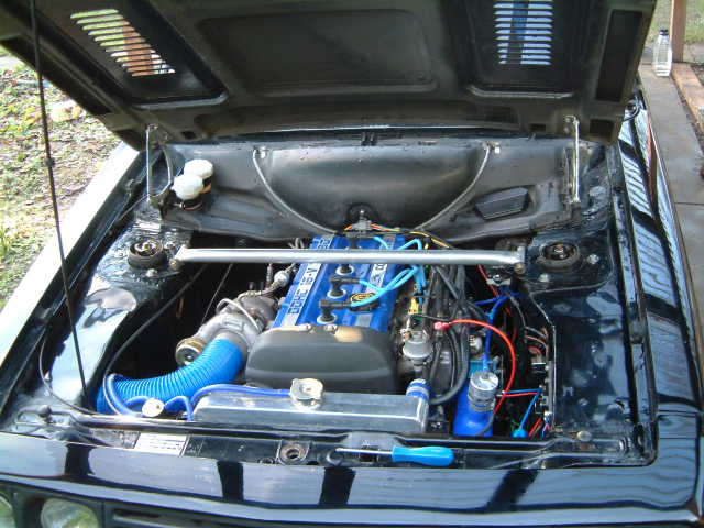

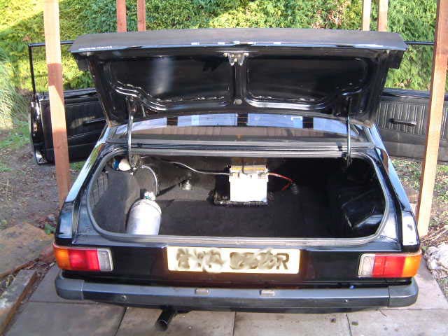

sweet scrote!! How is the nitrous plumbed into the inlet hose, does the hose take the thread ok, do the jets stay put as ive seen some siliconed in!, also you have mounted the battery in the boot, how are the exhisting battery terminal leads connected to the extension piece, just bolted i presume? or neated than that? what guage are the extended cables? nice motor dood!
Hello again MrC

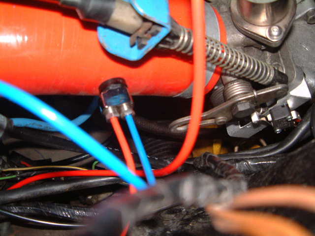

The nitrous is just fitted into the boost hose with a 'highpower systems' 'cross-fire injector' it's secure enough.
here's a picture of it before i got the better boost hoses.
it has a 'top hat' on the inside which won't come undone
There is no extension piece on the battery cable, just one run of thicker wire straight to the starter and a seperate thicker wire to the ecu/relays.sorry don't know the gauge, just 'bigger'
thanks for looking
