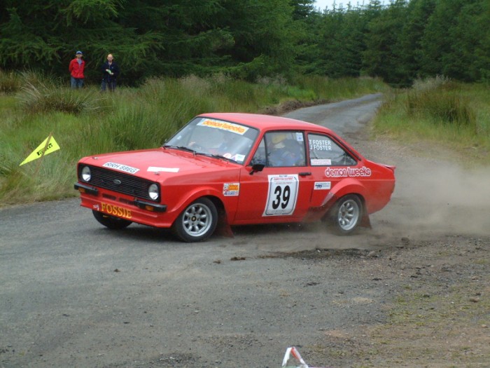

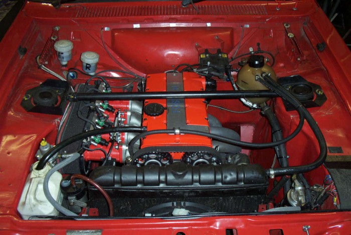

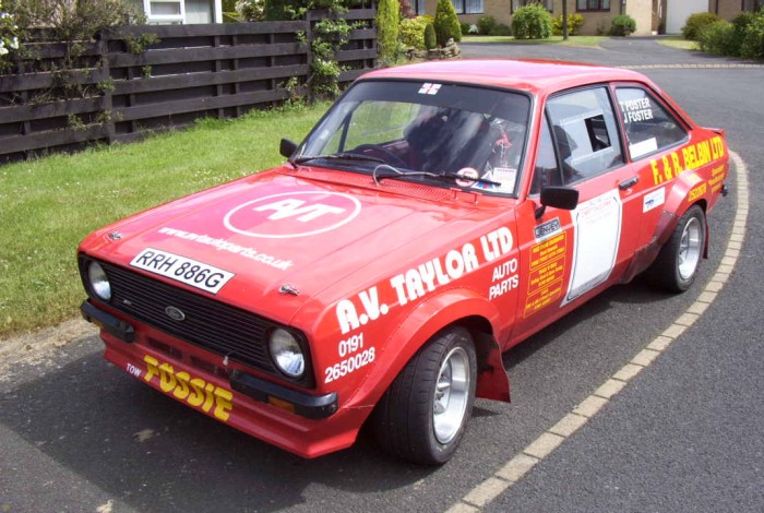

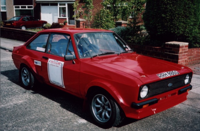

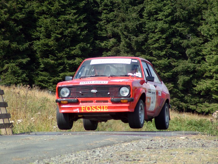

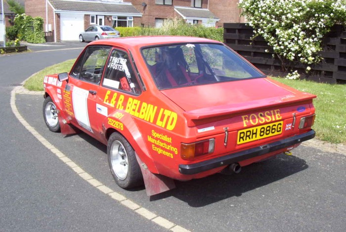

The top 2 are outside my house, 3rd one is on Otterburn ranges 2 years ago, next one is on the Jim Clark rally the same year, and the bottom shot is the latest evolution of the engine, just after we fitted it.

Power figures are nothing to get all moist about i'm afraid, depending on who's rollers you believe its either got 170 or 190 at the wheels... But boat loads of torque, from about 2000rpm! (thanks to Mr Greenald) So it is just amazingly flexible, which is a major plus point with a rally car. The powercurve is still going up when it hits the rev-limiter though, so some steel rods are on the cards so we can use 8500 and hopefully quite a bit more power.
Its way too quick for us though! Neither of us can drive it to its full potential, so no point spending any more on the motor just yet. A dog-box is next on the shopping list, before more power.

This picture was taken when we first built the car - note the 15" wheels - we thought they were a good idea at the time, but they came off pretty quick when we realised it handled like a broken sofa!

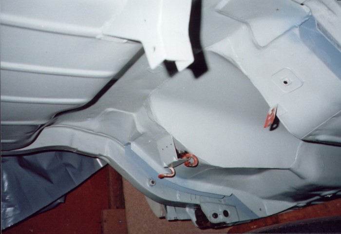

This is the only picture i've got right now under the back end, part way through the build.

Oh and thats better, thats how every Escort should look underneath.
