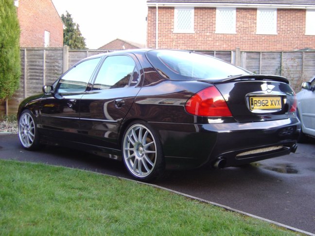

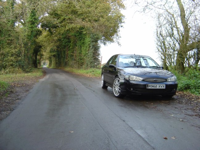

    I've been on here a while now so I thought it was about time I posted some pics of my car.
    It's a '97 ST24 Mondy with one or two little mods, 19" OZ Superleggeras & lowered on Koni/eibachs
    Here you go
    So what do you all think then?

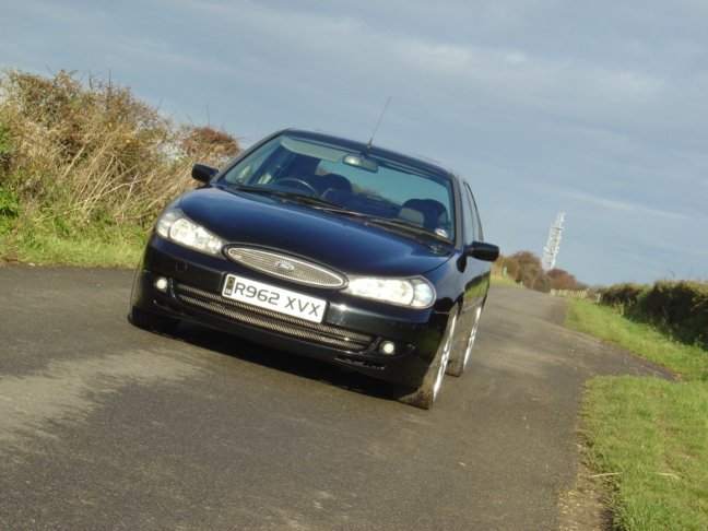

    Yikes !!! Thats nice
    Love the wheels, did you have any trouble fitting them with it being lowered ?
    and how did you do the headlights ?

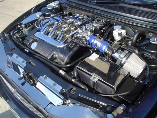

        thats a superb looking thing! Great wheels and I like the engine detailing.

          Cheers for the comments guys.
          I stripped the headlights, removed the silver part inside the unit, sprayed it panther black to match the car then added in some angel eye rings. Not a bad effect but the angel eyes aren't the brightest in the world, still passes a MOT with them wired as sidelights though.
          The wheels were a PITA to get to fit really. I was desperate for the OZ Superleggeras in 19" but they only come in a 8x19 (Focus fitment). The shop hadn't ever fitted 19's to a Mondy before & no one else I know on any of the forums had either so it was a case of fork out the cash, get them & hope they fit really.
          They backs originally rubbed when I had a load up so I had the top inner arch lip rolled & no problems at all now. I've only lowered the car 30mm but thats all I wanted really as I use it every day & didn't want a bone shaker. I'm running 235/35's & the ride quality now is no different to when the car was standard apart from it sticks to the road slighly better now
          The upper inlet manifold has been chromed & goes well with a few other stainless bits that are under there. They all match in with the carbon cover for the IMRC box really well.
          I've got a set of Samco hoses due to be here next week so I'm looking forward to getting them in there.
