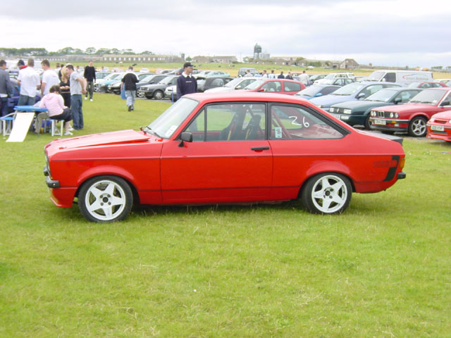

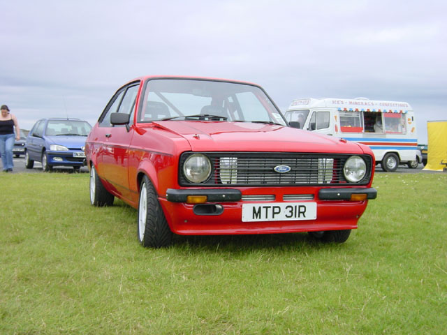

    Very nice

      Great pics, very nice escort and welcome aboard..
        Re: Hehehe; somewhere else to post pics of it!
        Wow! What a beauty!
        Tell us all about it then!

          MMMMmmmmnnn That looks lovely

            Top car matey!!

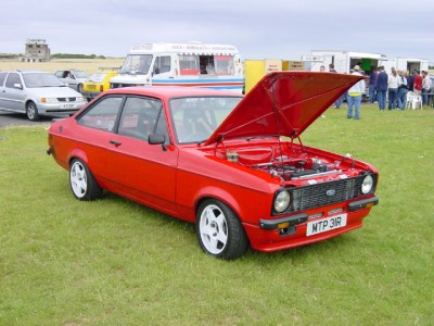

              BBitching!, with a double B, you got any pics of the engine? What's the spec?

                    Spec wise :-Cosworth powered 1976 Ford Escort Mexico MKII
                    Shell:-
                    Grp 4 spec unarched
                    Fully seam welded
                    5 linked
                    Turreted
                    Safety Devices roll cage
                    Large tunnel
                    Sparco bucket seats and harnesses
                    Suspension:-
                    Front-
                    2 1/4 ? Bilstien struts
                    Adjustable TCAs
                    Anti dive kit
                    Eccentric top mounts
                    Rear-
                    2 ¼ Leda coil-overs
                    Engine-
                    Cosworth YBB
                    Stage 3 chip
                    803 Injectors
                    Ported head
                    T 35 Turbo
                    RS 500 sized intercooler
                    Alloy radiator
                    3? Stainless exhaust
                    Pipercross air filter
                    Power- 291 bhp @ rear wheels
                    Gearbox-
                    Cosworth T5
                    Axle-
                    Grp4 Fully floating twin taper narrow atlas
                    ZF LSD
                    Single piece prop with Grp A couplings
                    Brakes-
                    Front-
                    AP 315mm vented discs
                    AP 4 pot callipers
                    Rear-
                    AP 275mm vented discs
                    AP 2 pot callipers
                    Bias pedal box
                    Hydraulic and cable handbrake
                    AP Proportioning valve
                    Wheels and tyres-
                    Front- 6x15 GRP 4 Compomotive MOs
                    Toyo Proxies 195x45x15
                    Rear-7x15 Grp4 Compomotive MOs
                    Misc-
                    12 gal Alloy tank
                    Twin fuel pumps
                    Surge tank
                    Battery in boot
                    Rgds STooF

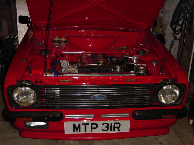

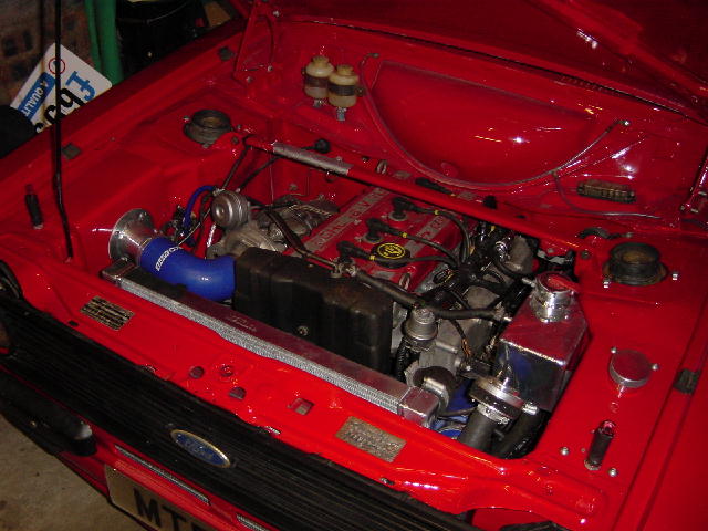

                      COOL! I especially like the way that some things have been mounted through / under the arches i.e the air box. What is the cap for on the other side of the bay scot, just in front of the top suspension mount, power steering?
                      • Scot
                        • 93
                        Just the windscreen washer bottle.
