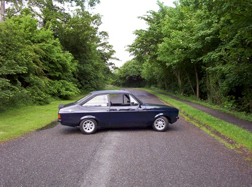

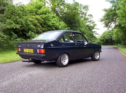

          7jx13 Superlites with 185/60 Kuhmos-lowered 3" at the back n' all
          Gonna get some 2ltr capri struts after hol, fit them with avo inserts, 2 1/4 coil conversion, then get the rear springs decambered, 175/50 tyres so that i can get her real low......

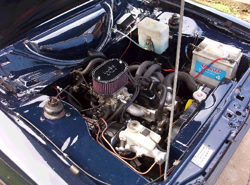

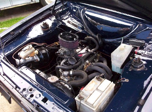

                some more including the engine bay resto i did.Took me 6moths that bugger did but the again i only earn £200 a month... replaced,painted and cleaned everything fitted, bare mettalled and painted the whole bay,replaced 1.1 engine with a 1300GT-fully rebuilt it and fitted a fast road cam, unleaded head, 32/36 DGV carb, performance manifold and exhaust,heavy duty valve springs...e.t.c..
                Me and medad did all the work ourselves bar the unleaded head(obviously)...Hope a like the pics...

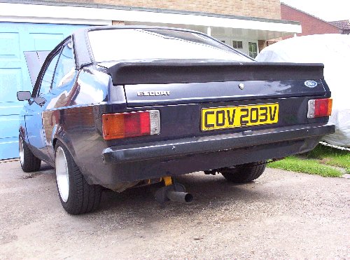

                        If your thinking of lowering it some more, then I would get that exhaust tucked up a bit more, back box looks like its hanging a bit low to me.
                        BTW were you trying to do handbrake turns in those first pics

                            lol-its a disused road(great for the mk2)
                            Steve-yeh the exhaust hangs low-got crappy Deflex poly ones on and theyre very long so let the exhaust hang down too far...Will get some shorter ones when i start after hol
