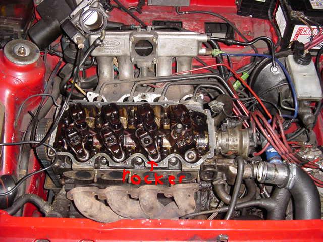

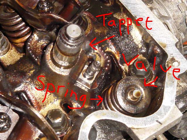

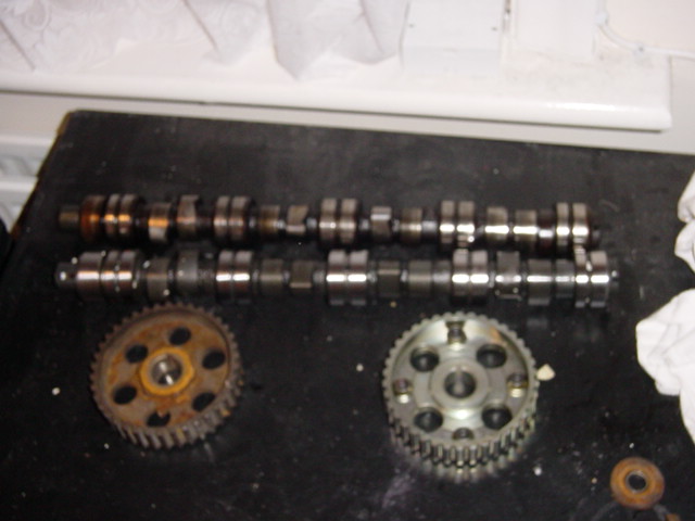

    here you are keez!!
    Just remove the rocker arm, slide out the old tappets, you can then slide out the old cam, whack in your new one, chuck all the new tappets in, and bolt on the rocker arms!!!
