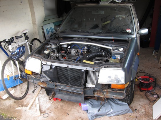

Car is currently sat looking a bit sorry for itself grubby in the garage

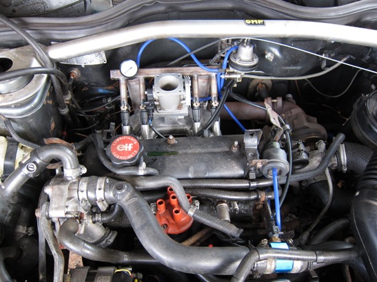

Engine currently waiting me to fab up the final boost hose and connect the fuel lines so that I can try firing her up.

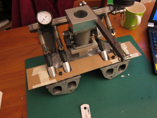

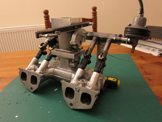

Custom fuel injection setup. It's a stock R5 manifold that I welded injector bosses into. The fuel rail is slightly awkward, but had to be to avoid all of the other parts in the way. Quite pleased with how it worked out though.
(Please excuse the ugly aluminium welding, I'm fairly competent at tig'ing steel but definitely could have picked an easier project for my first attempt at welding aluminium!)
Cardboard is temporary.

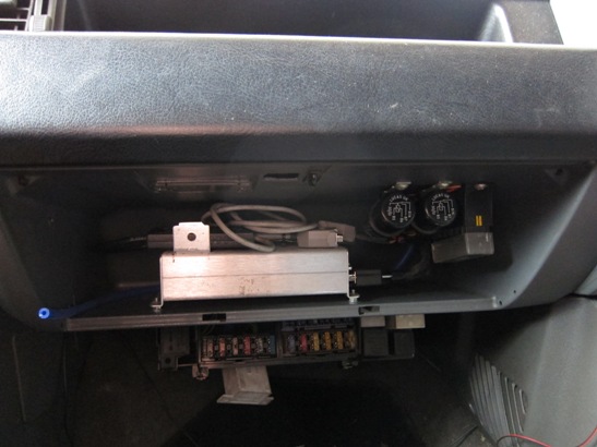

ECU, Lambda controller, relays and fuses all stashed away in the glove box.

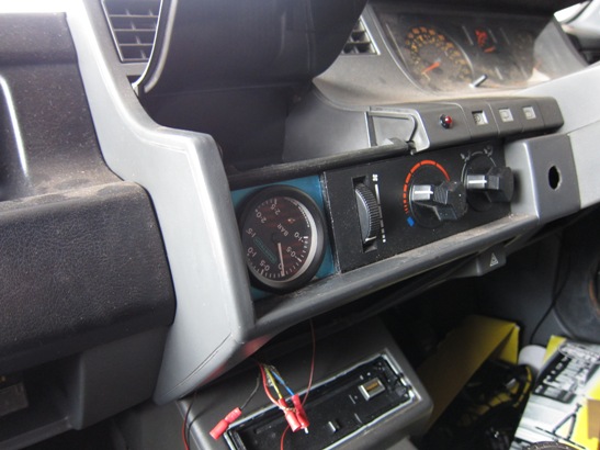

New boost gauge in the dash so I can keep an eye on it when the laptop isn't plugged in.

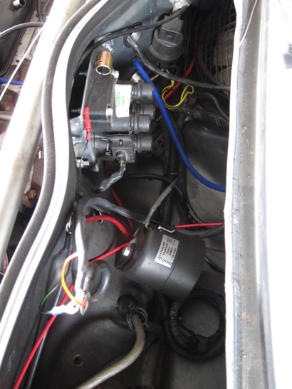

Ford coil pack is mounted the other side of the bulkhead/firewall to keep it out of harms way and temperatures down.

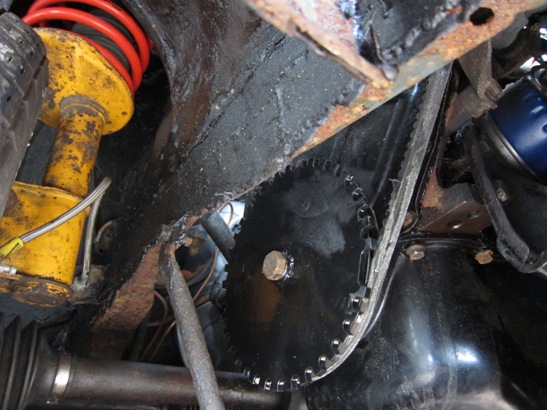

36-1 trigger wheel in the crank pulley. Hall effect crank sensor is hiding just out of shot.
