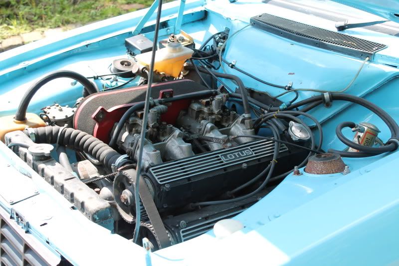

    So, Earlier this year, I find myself in the fortunate position of having some spare cash about, and lookig for a toy, stumbled upon DAC28Y, a genuine Talbot Sunbeam Lotus, which had been off the road for a huge amount of time, now, I have to confess, this was originally bought to "titivate" and sell on at profit, to allow some more to be spent on the Rover, but when I sat in the car, a wave of something passed over me, and it just felt like home. So, needless to say, I bought the car, and got her back home, with the idea of when my new big garage is built (not long now!), it would be my first project, however, call it fate, or whatever you want, but a little trip up to R.A.C.E to see my good mates Phil and Mick, turned out to be a little more expensive, but massively rewarding the other day. I entered the yard only to see a clean looking, unarched Sunbeam rally car hiding in the corner, and to truncate this story, I bought it. End of.
    So, what now, the car is great, lovely, rot free shell, new seats/belts/extinguishers/Logbook etc, so, if I so desired, I could go do a rally in her tomorrow, but she does need some attention, just little details, but nothing major. Long term, I hope to build her into a full, works(ish) spec Historic car, with alloy arches, door skins and bonnet, proper lump etc, this may mean me having to sell the Rover, but for now, I will se how that goes, as I know I will take a huge kicking on that.

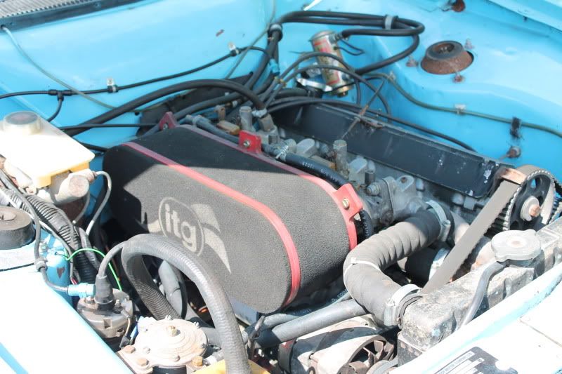

          Great read as always. I love these cars. Pity body parts are so rare these days. Looking forward to reading your updates on this as much as I do when seeing your posts about rover.
          One slight bit of advice and I'm no mechanic but the fuel pump in the photos located in the engine bay will never really work well. They are designed to blow not suck. I learned the hard way when my rally car used to starve herself of petrol off the line when I had the fuel pumps up the front. Move it back beside the tank and you'll never have a problem!
          Looking forward to your updates!!

            Thanks for that, but the fuel pump is the first area I intend to sort, it has god awful rubber hoses with jubilee clips, sorry if that offends anyone, but I would much rather have something well up to the job.
            So yeah, a few jobs to sort before I would even think about using her, but a damn good basis to start.
