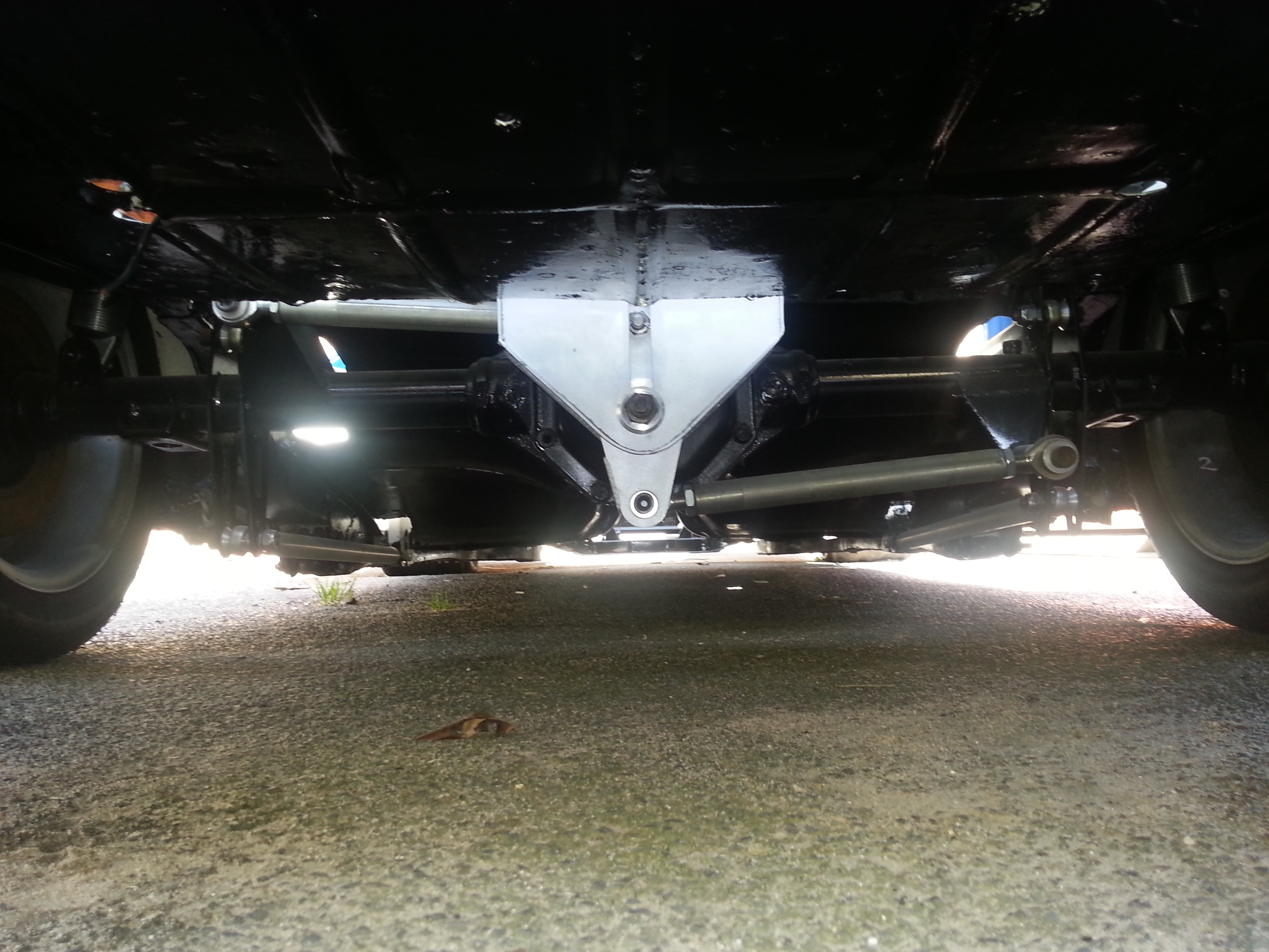

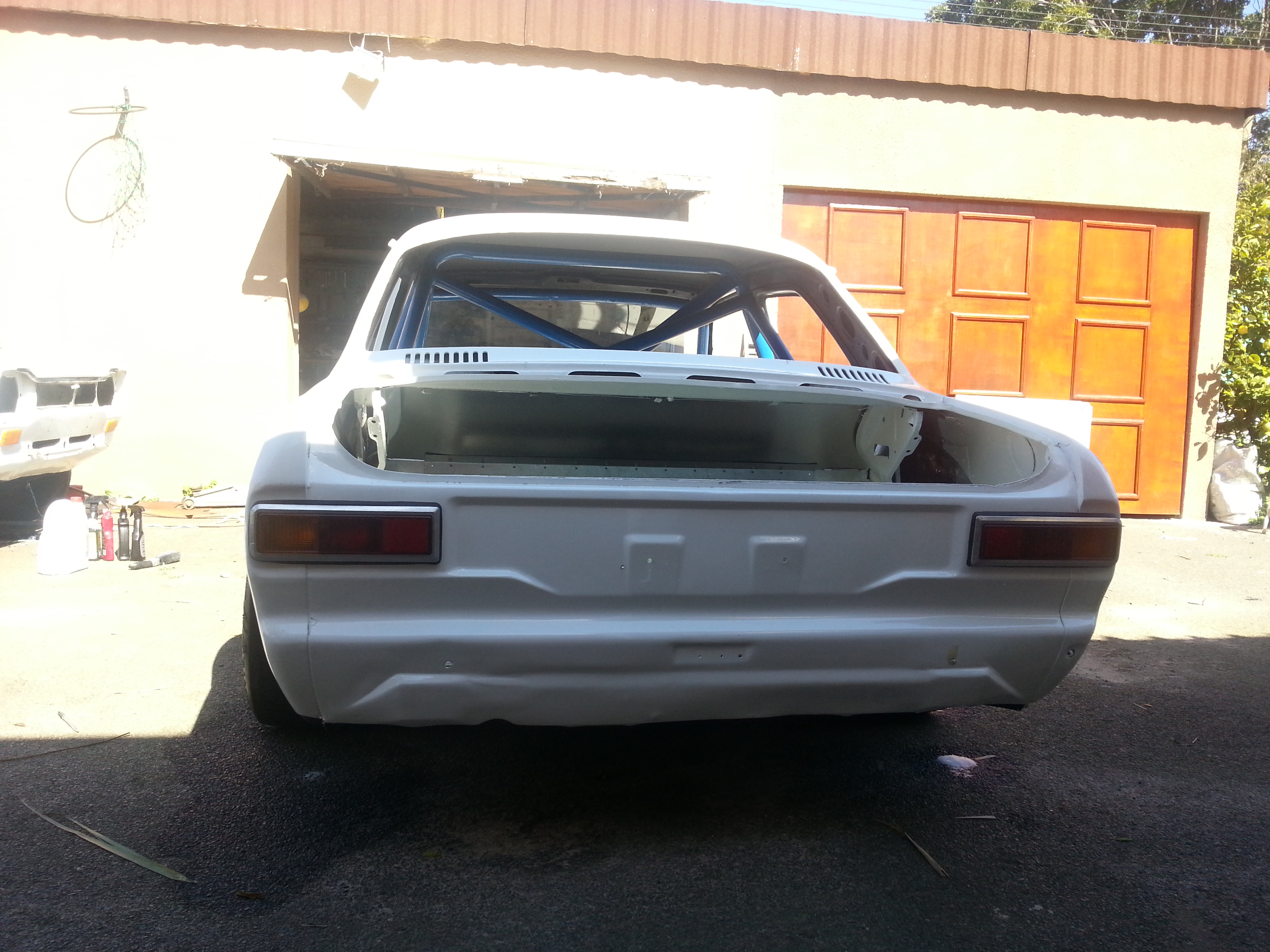

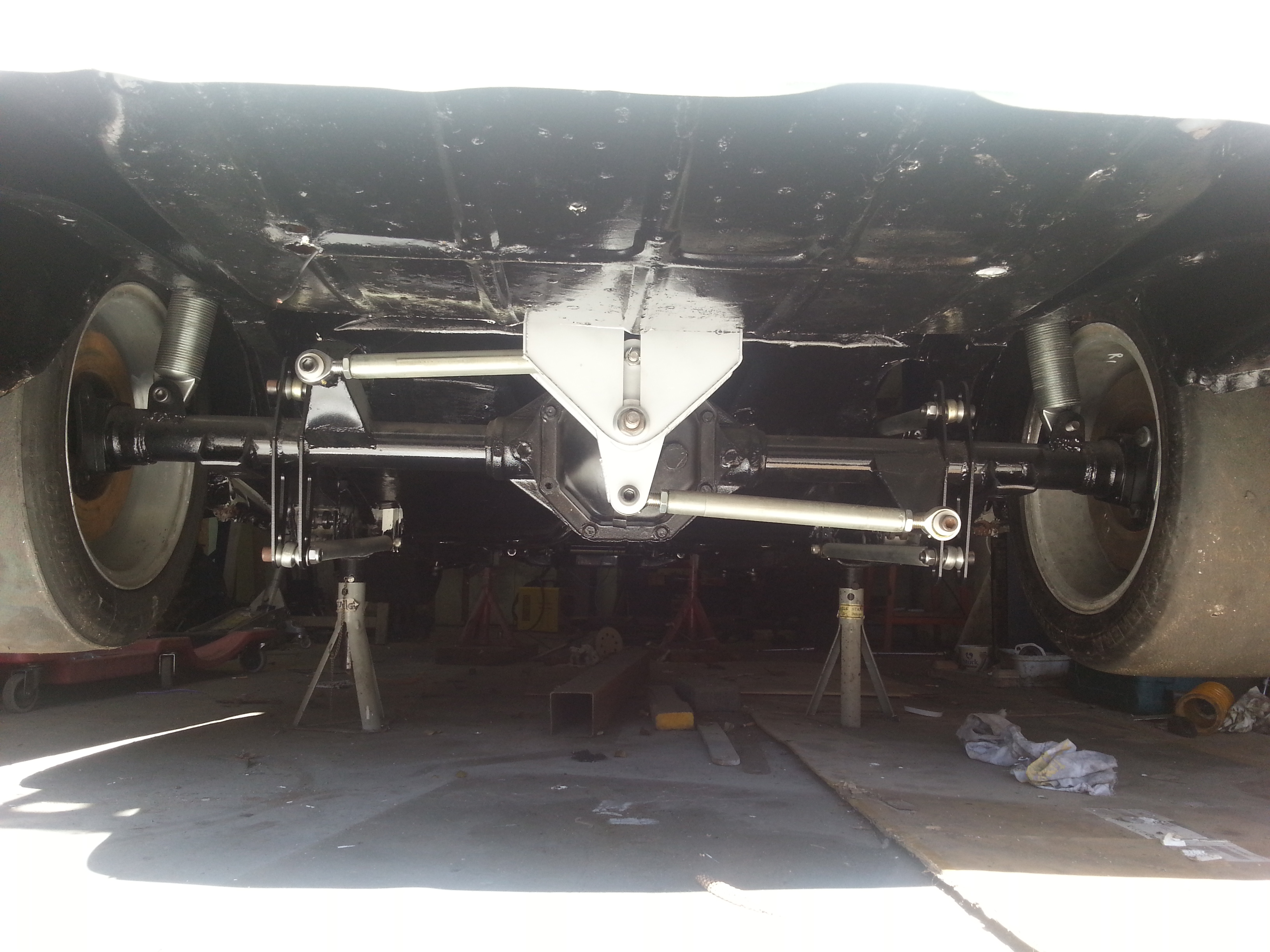

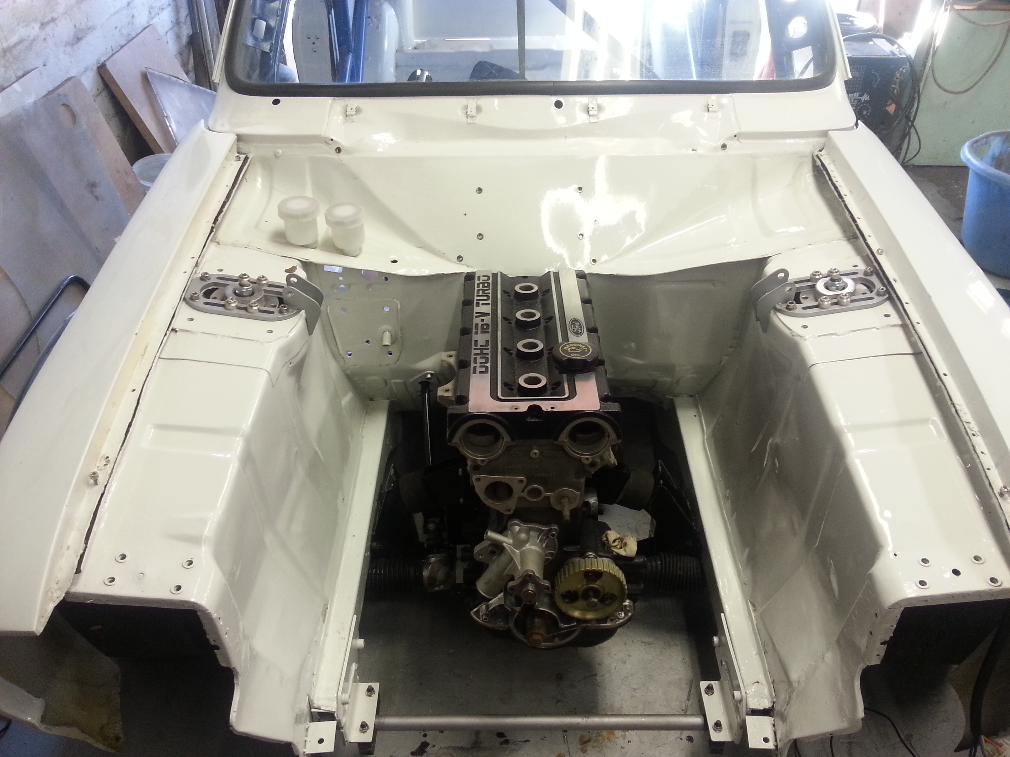

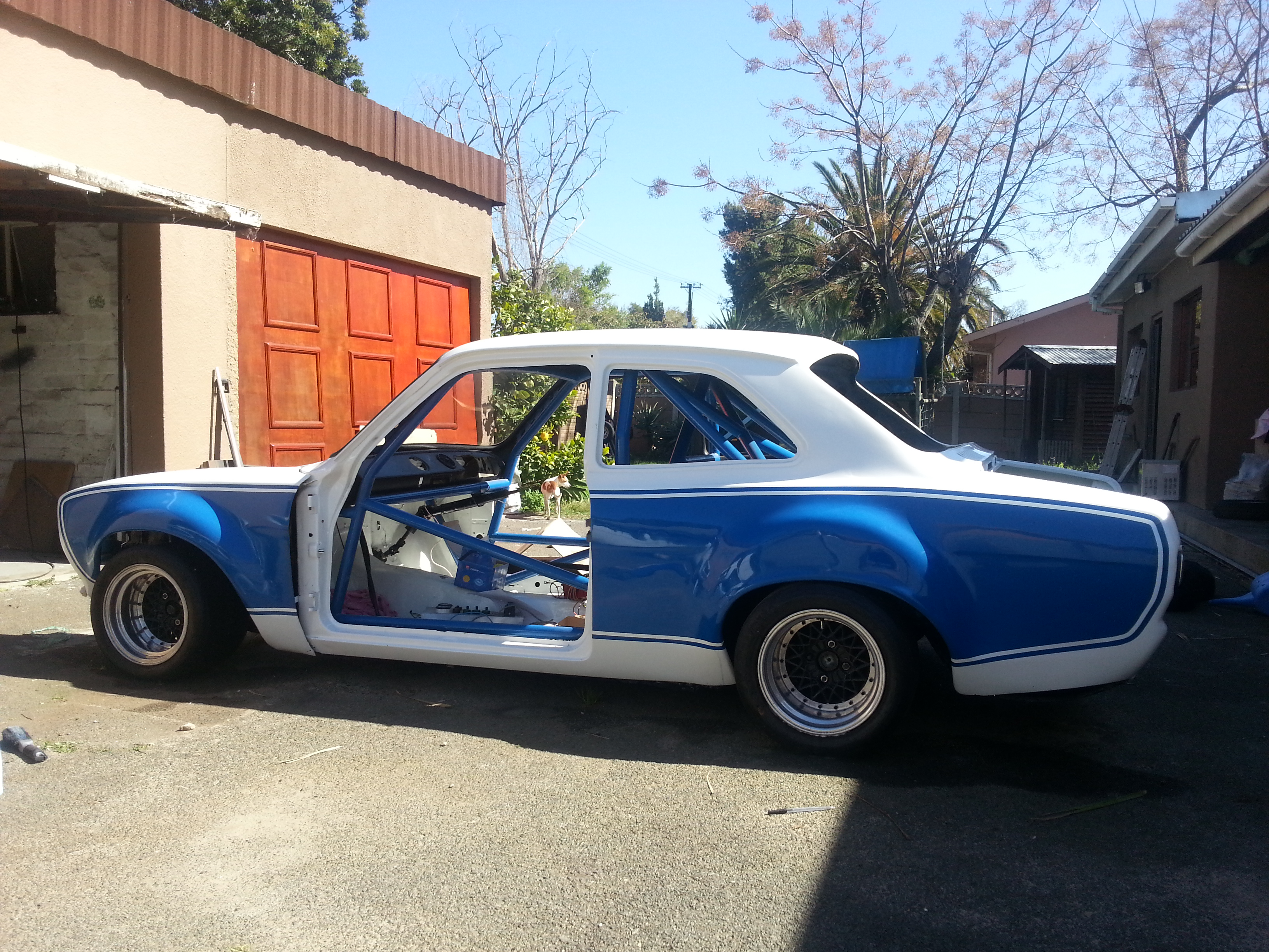

    Some pics of my Mk1 I've been building over the last 2 years. 85% complete now
    All fab work done by me
    Specs :
    2.1 Pinto
    48 Dellorto's
    Type 9 box
    Tilton double plate 7.5" clutch
    MSD Ignition
    5 Link rear
    Borgwarner 4.1 lockdiff
    10" split Compomotive's

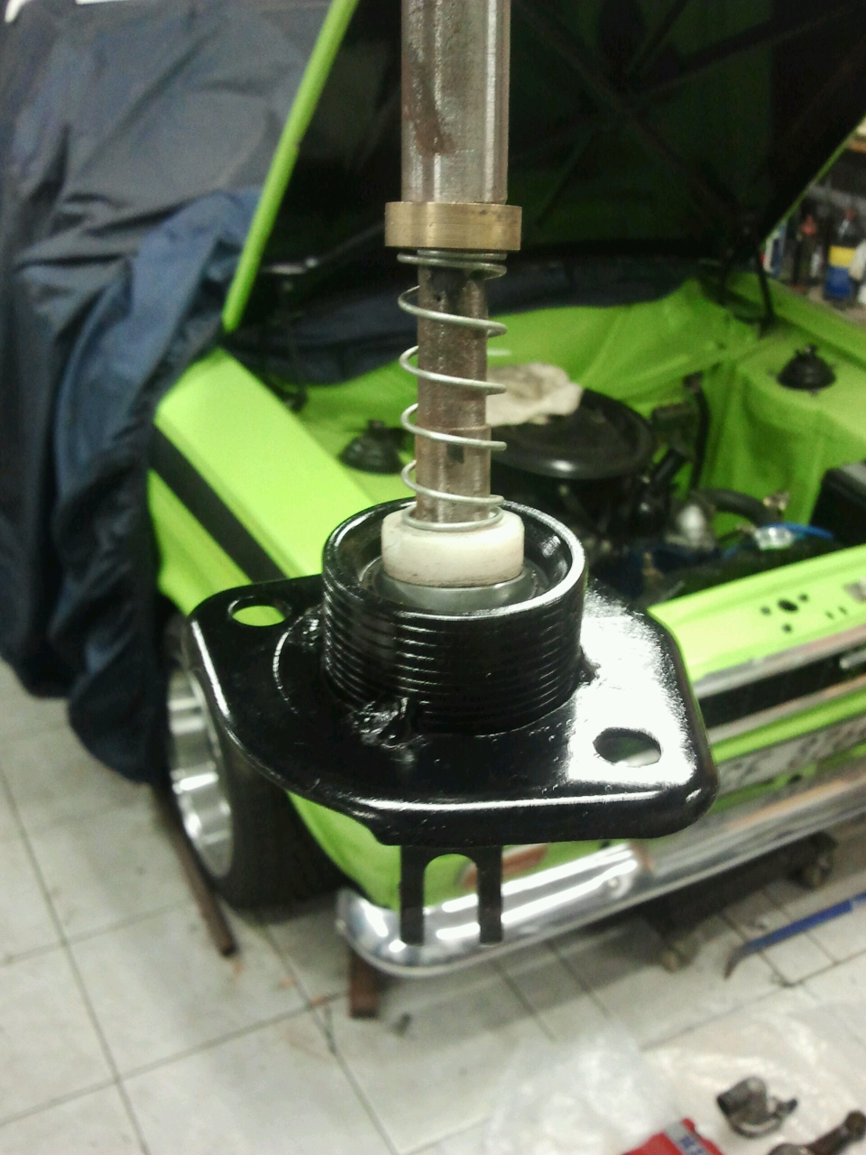

    Adjustable coilovers front and rear
    Adjustable camber plates
    Some random pics : First time car has come off axel stands with rims and tires fitted
    Pedal box
    Painted the car in Ford South Africa's dealer team rally car's colors

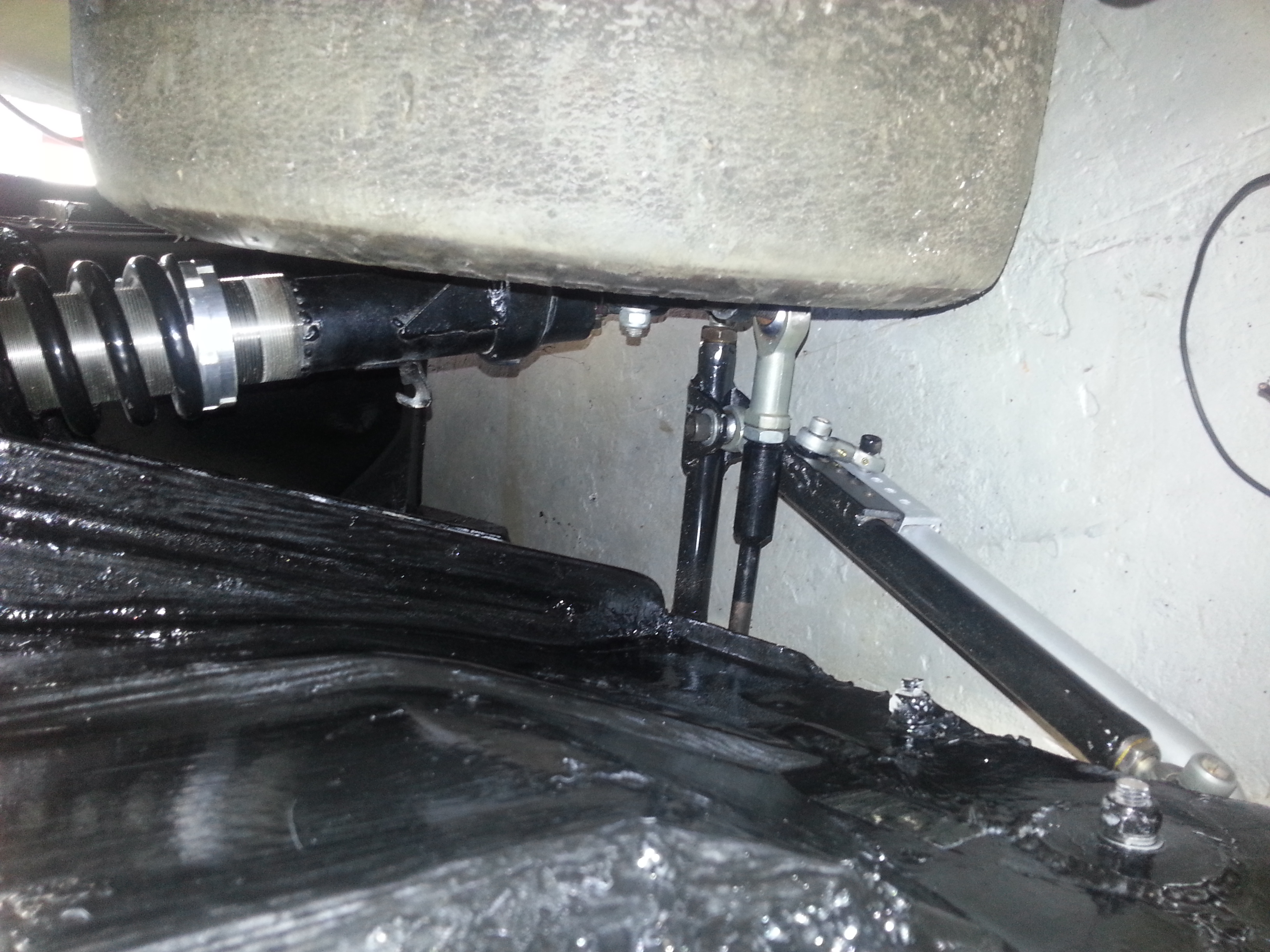

                    Re: DarthVader's Classic Mk1 Escort
                    Hey dude,
                    Nice work there.
                    Could you tell me what brand of black paint you've used on the underside?
                    Ad
                    • DarthVader
                      • 3354

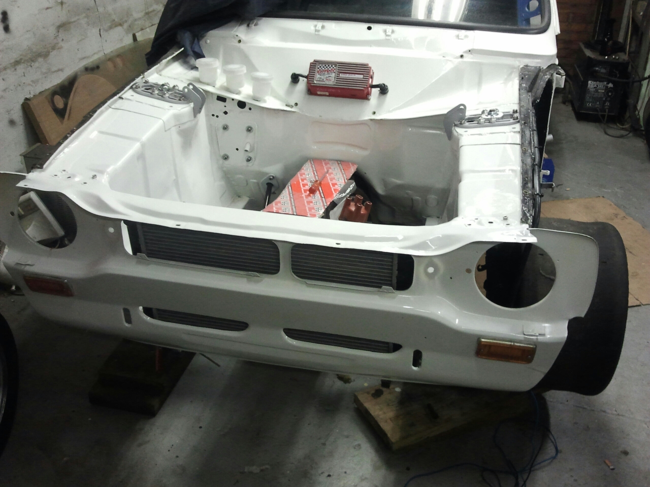

                      Longman, quick drying truck enamel and foam paint roller

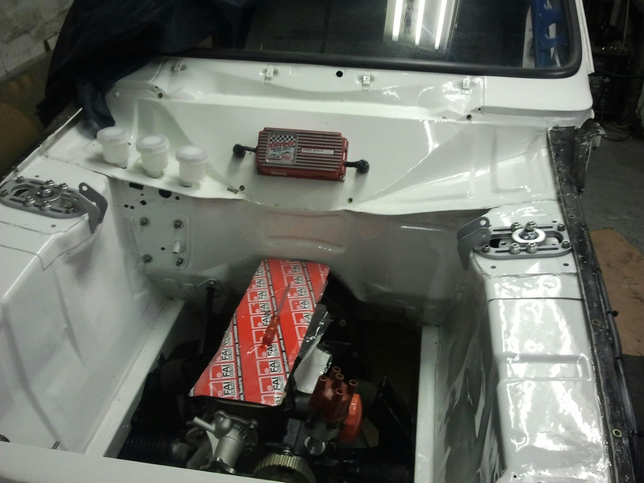

                      Trying to keep engine bay clean of wires and pipework is proving to be a pain in the ass.
                      MSD mounted - have made fibreglass mould of heater bubble and pulled fibreglass copy, this will cover MSD any anything else I can think off.

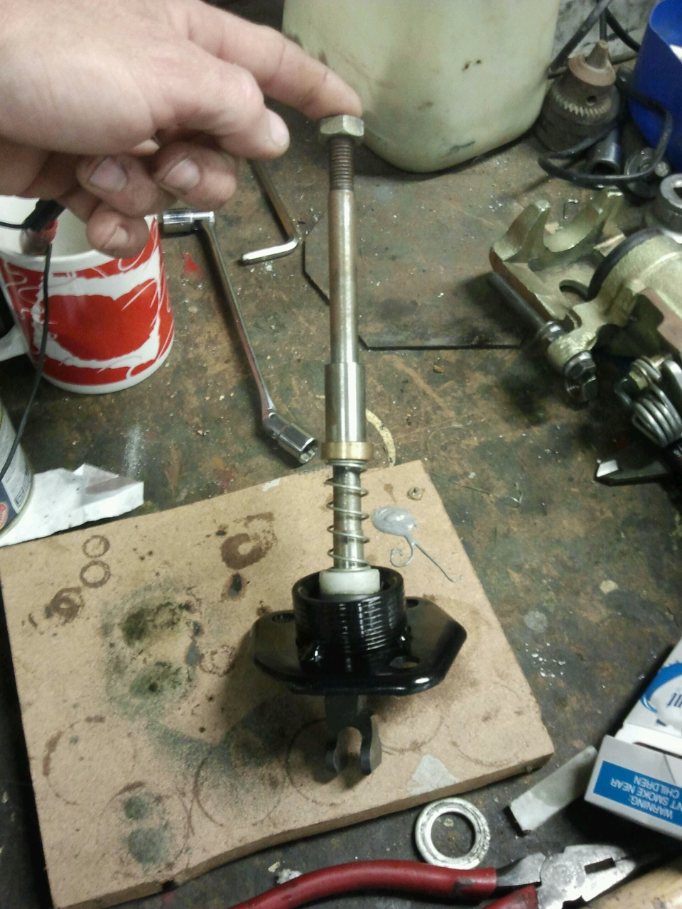

                      Quickshift I made a few months ago

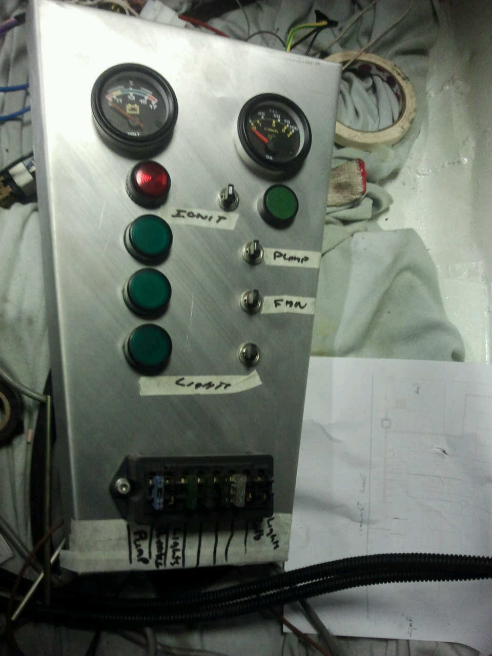

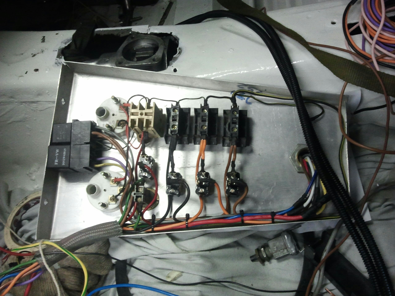

                      Switch panel coming on

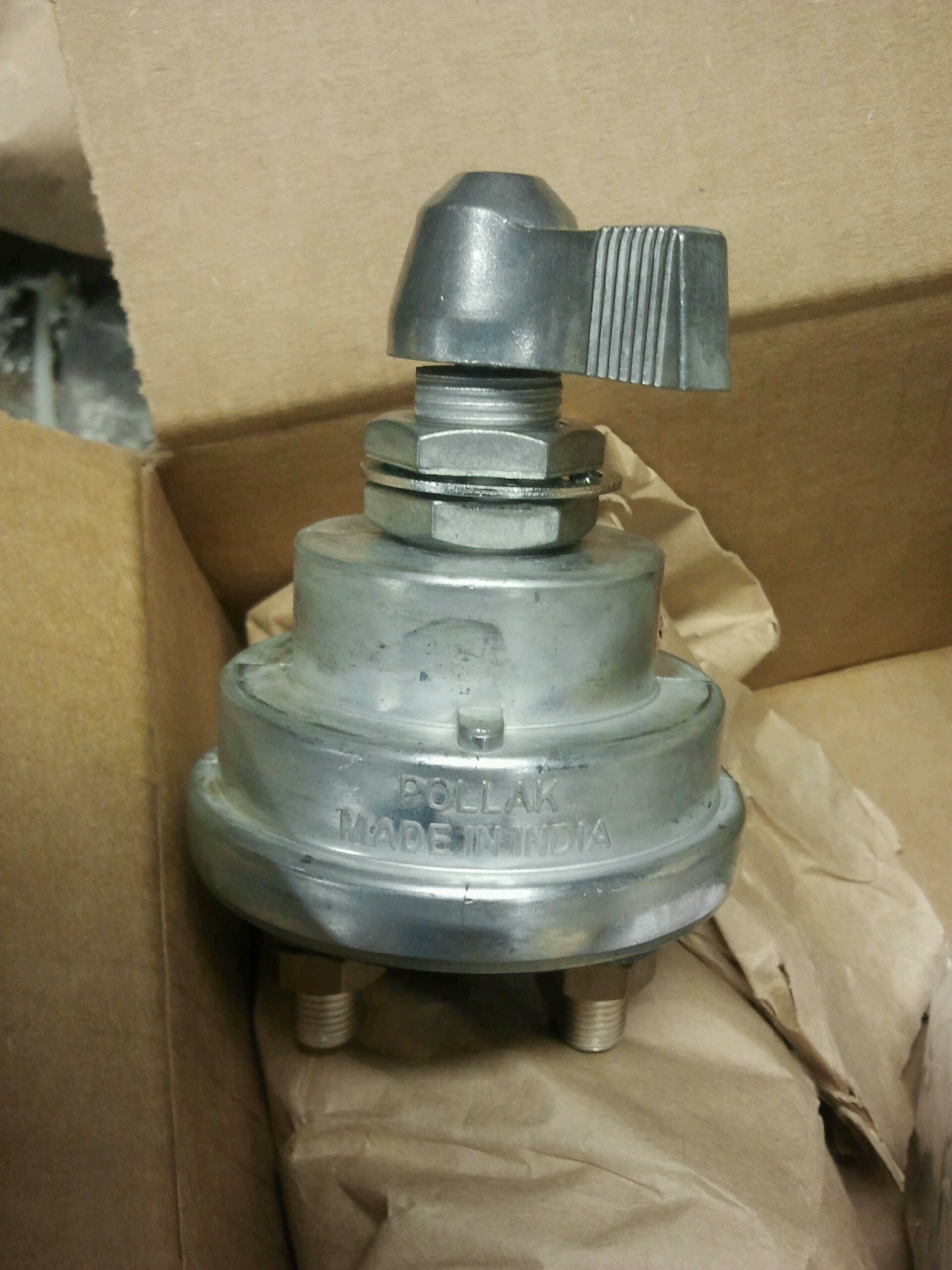

                      This arrived from USA today - $15 each ex postage, best buy all year so far. Saved me a whopping equivalent of 90Uk pounds if I had to buy them locally in RSA

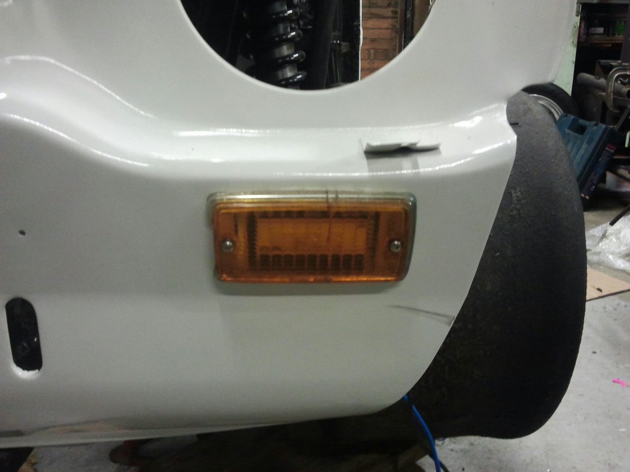

                      In our series we need working lights/indicators. Because mk1 indicator backing's are so scarce here I decided to use amber LED lights behind lenses. No problem with bulbs comming adrift as well

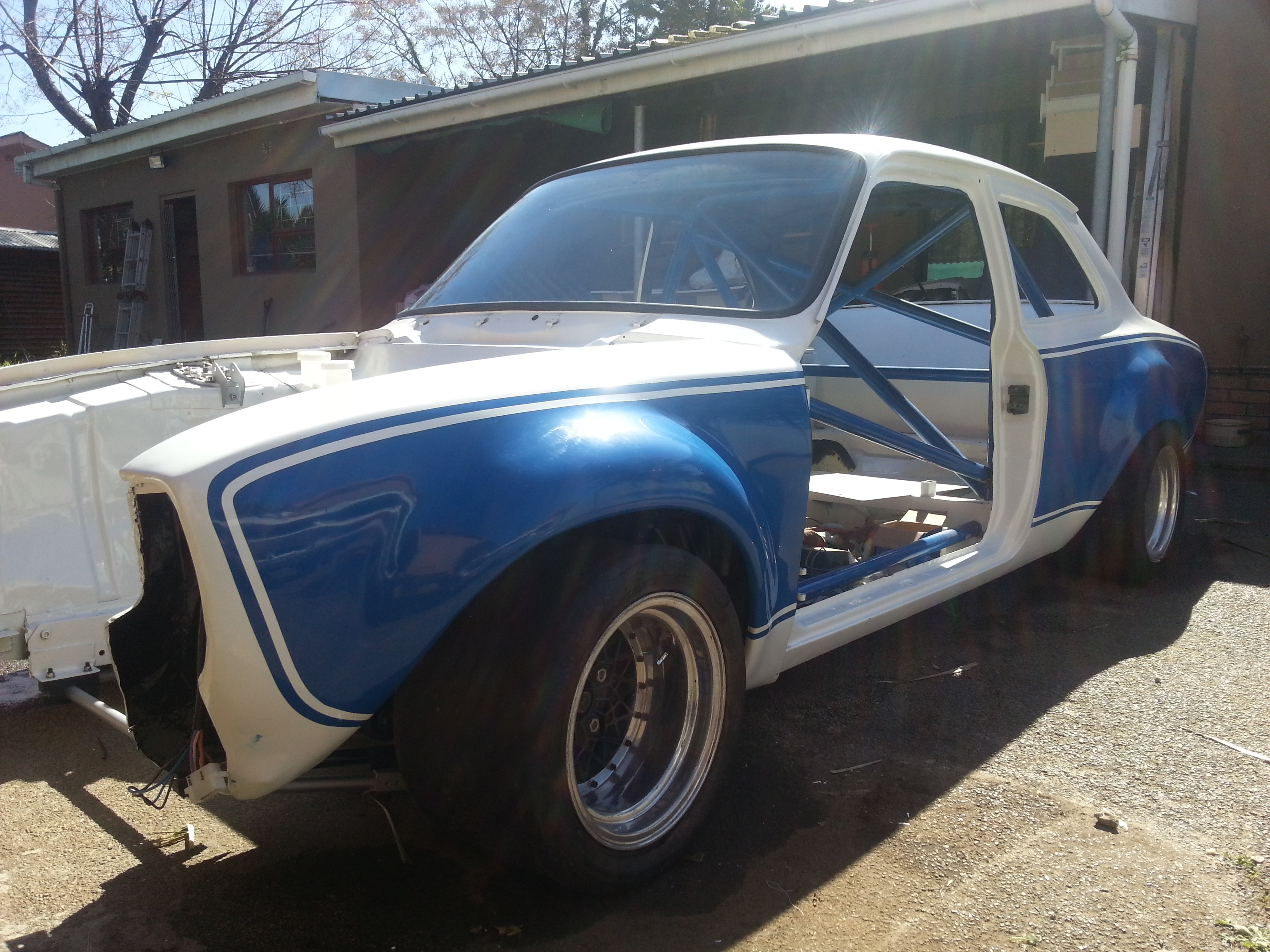

                      General view from front
