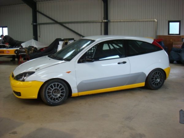

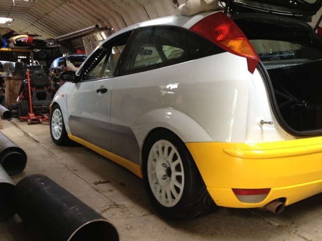

Sorry about that my phone froze anyways here's a few pics of the focus. It's an ex btcc production class focus built by Gr Motorsport for the 2001 season it was also ran for 3 consecutive years at the Macau touring car race before being retired.
She was bought in September and was prepared for the last round of the tin tops at oulton where it was competitive in qualifying but a shortage of 4th gear put us 13th, we started well but developed a miss fire and it just seemed to get worse so it was retired.
She will undergo a comprehensive rebuild over the winter.... -

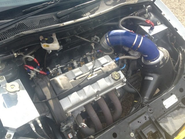

It was built in 2000/1 by Gr Motorsport to the new production class regulations at the time which in short meant that it had to retain the original silhouette, inlet and engine/gearbox configuration ie zetec engine with an fia controlled CR and the original plenum. It also had to retain the Mtx75 gearbox casing.

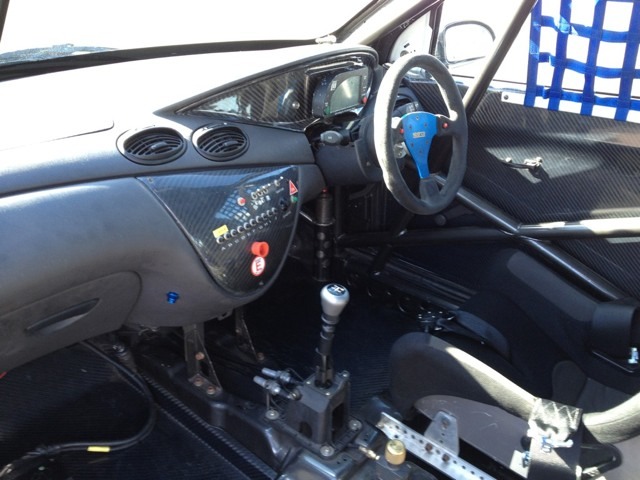

Brief car spec as bought.
Focus mk1 chassis, never reg

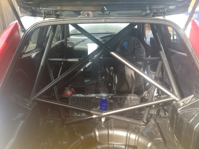

Fully integrated t45 cage to touring car spec, tied in to all shock mounts fully gusseted air jack tubes etc.
Air jacks.
All steel panels.
Full glass.
Carbon interior panelling
PI research system 2 dash
Pectel t6 2000 ecu
Zetec st 170 engine, Vvt delete
Cosworth rods, pistons, standard crank,
Mild head porting and mountune cams.
215bhp @ 7300rpm
X-Trac 5 speed dog box with trick diff
Penske 3 way dampers
Alcon callipers front and rear
Speedline corse magnesium wheels
Custom rad and oil cooler combo
Etc etc etc.Comment

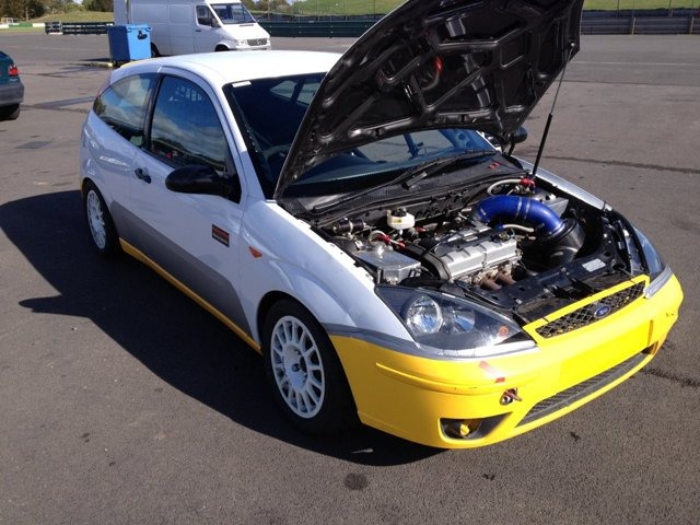

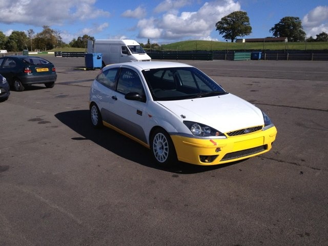

We managed to get her home safely and had a good look round it when it was off the trailer.
Before the first race we knew it needed certain things to get it trackworthy.
The safety equipment needed to be brought up to date so we bought a new fire extinguisher and belts.
The suspension hadnt been rebuilt for 8 years so I took it to Penske, they charged me £650 for full rebuilds and dyno testing. Which compared to £6000 for a new set seemed quite reasonable!
The brakes seemed visibly ok so we left the seals.
A rain light was fitted and the ecu was sent to Tdf at Huntingdon because for some reason there was no dash coms, they advised that the motherboard was on its last legs but they managed to fix the driver for the fuel pumpwhen it was ready I dropped it off for the ecu to be refitted and for a run on the rollers to check it over, it seemed to go through the gears ok and made 215bhp. I was quite happy so booked a test at mallory on a Wednesday morning.. For a shakedown.

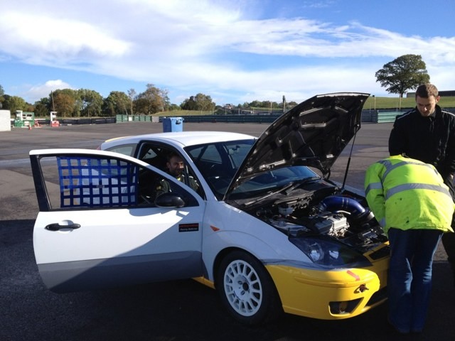

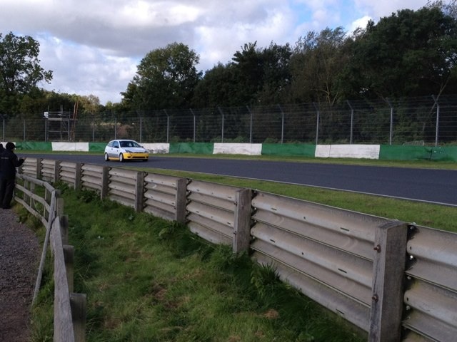

Managed to get to mallory to shake her down and me and Tom managed 10 laps each....... With no brakes. Traced the problem to the vacuum off the plenum being missing I can't believeComment
Focus running in the tin tops
We didn't spot it was missing. Apart from that she seemed fine.
because of no dash commsI managed to fit a capillary guage for the water temp and with a rev limiter oil pressure and temp warning light drove the car like that.Comment
