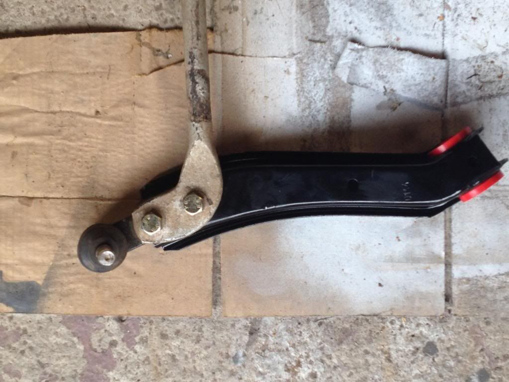

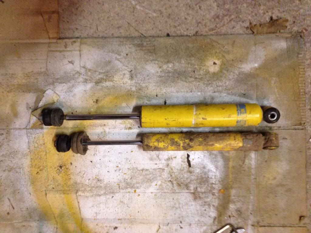

This year we have struggled a bit with some inconsistent handling that has got worse through the year and a very tired engine! So over the summer, no events since the end of June and because of tree disease cancelling an event only one left at the end of November, I have been rebuilding the car and trying to find the source of the strange handling. I'll update below on progress.

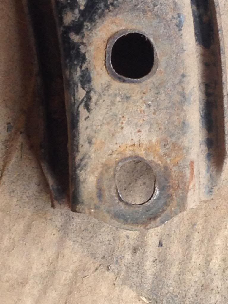

i used 2 look after some novas for oval racing and that ovaling was a common thing on the ns tca the best way around that was a rosey joint (if your regs allow)
