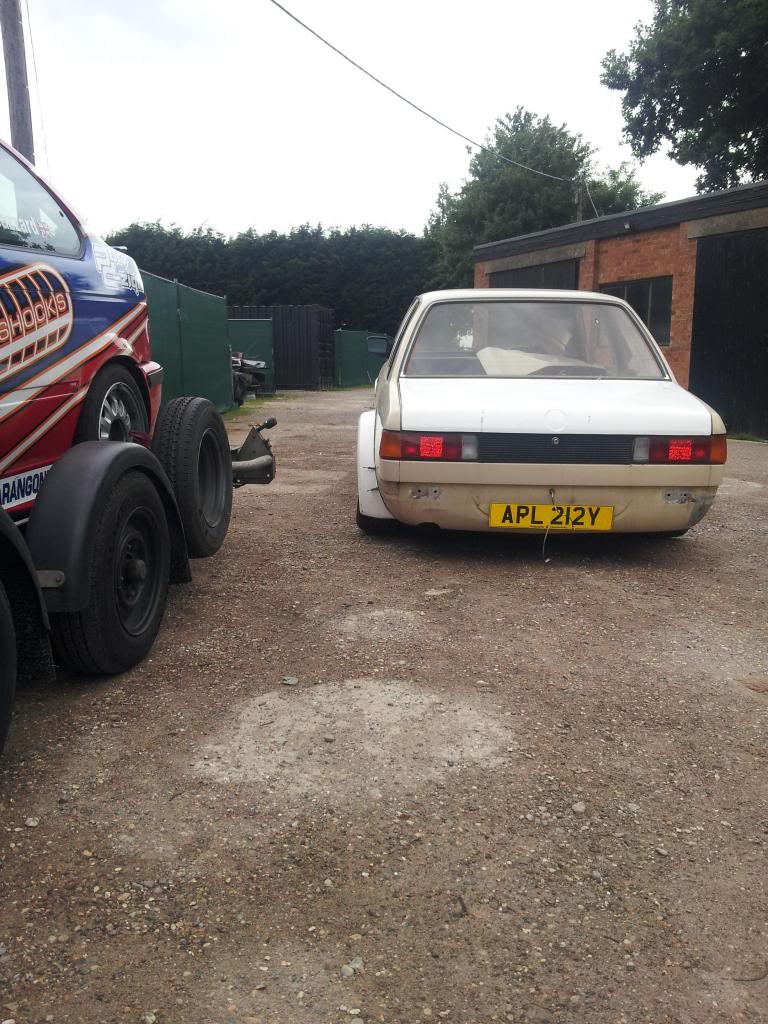

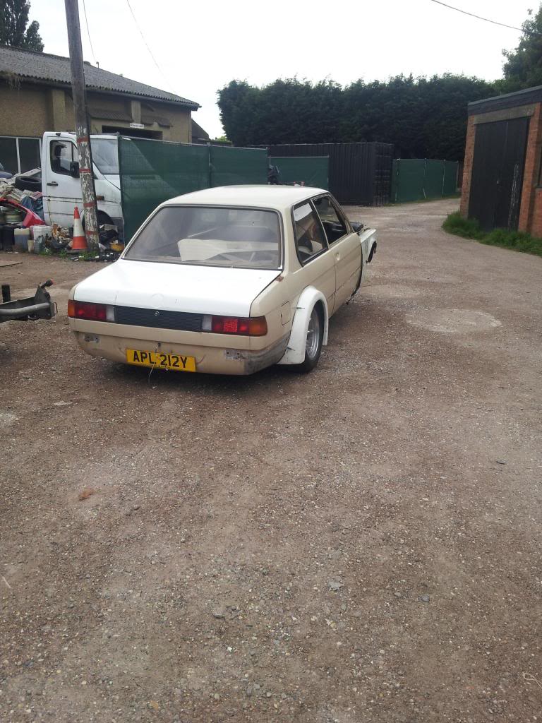

    Since starting to do a few sprint events and track days back in 2011, I have wanted to put together a replica of an old Group 2 race car. Finally this year I snagged a really nice, non sunroof 316 base car on which to base the conversion. I also had the arch kit and fiberglass panels ready to go on, once the shell had been stripped, caged and painted.
    First task was to get everything over to the workshop.
    Once the shell had been stripped, all the glass removed and the sound deadening chipped away, there were just a couple of repairs needed beneath the front and rear screen rubbers. The rest of the bodyshell was excellent.
    The original Group 2 cages were pretty poor by todays standards, so I opted to go for something a bit more comprehensive. I also tied it in with the diff support and went for 2 diagonals. I had to put the driver side door bar a little lower, as I have a disability and getting into a fully caged car can be a bit awkward. It's still good and strong though.
