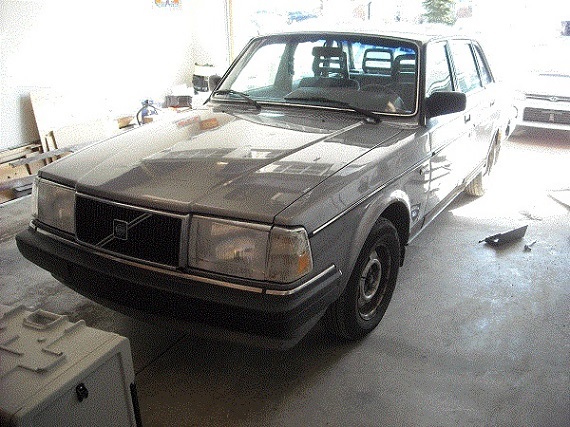

    Well figured I would throw my build up. So forme, like many of us the want to play with cars on gravel started young when I spectated a few events with my dad when I was much smaller. Got to go for a ride after one of the events with one of the competitors and was pretty much sold.
    Fast forward a decade or so and here I am with a 240. Very lucky to have gotten it for free from my cousins after expressing interest in it. It was going to me or the scrapers so better off with me...maybe
    So about a 1.5 years of teaching myself to work with metal as I built this thing and here is where I have gotten. The goal is basically a giant ford escort. Towers, 4 link, panhard. Motor will remain stock for now until I have a few more bucks. I have been gathering parts for this and it will stay naturally aspirated.
    Tossed the volvo 1031 and went for a toyota 8 inch which I think i've seen a few folk on here stick in various projects. 4.88 cw&p with a supra lsd. The lsd will have the breakaway torque increased with a weir shim kit.
    Gearbox is a mustang t5 with v8 ratios (2.95 first) I rebuilt it with new bearings, syncros, fork pads. This will do for now but will probably look into a proper close ratio box when it comes time for a motor.
    For now just a photo of when I brought it home and I appologize for the low quality photo. Im still playing around with what works for size/quality to post on this forum.
    Suggestions, advice and comments always welcome! I am here to learn!

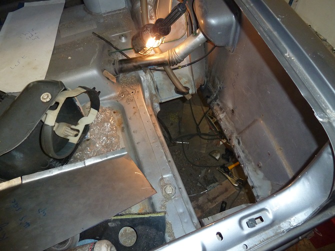

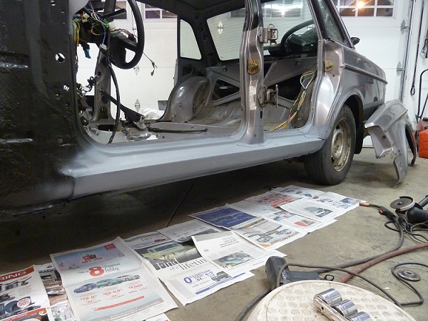

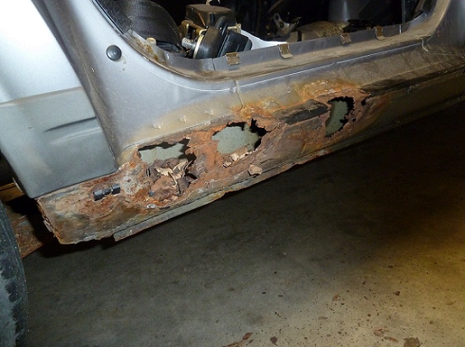

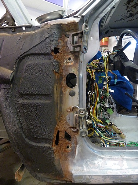

    The car has done quite well for 25 years of calgary winters but sadly they salt the roads to death out here and it had taken a bit of a toll on this car with 300,000km on the clock. Both rear rocker panels were gone as was the structure on only the drivers side door oddly enough. Got lucky and scored some patch panels for the rockers from an old high school shop teacher amoung many other things. Sorted the door area with just some sheet metal plate. Click image for larger version
ID:	2015012Click image for larger version
ID:	2015013Click image for larger version
Name:	rot be gone.jpg

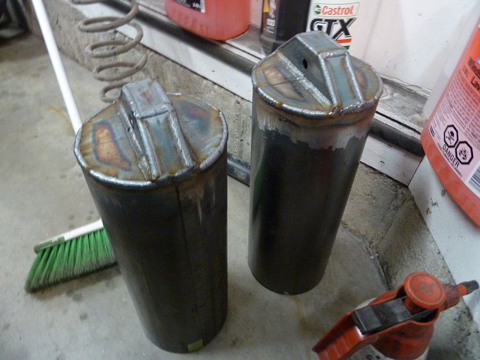

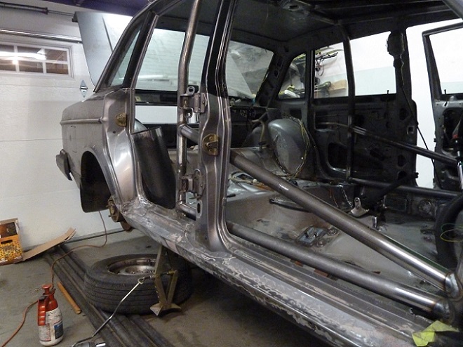

          So to continue on which updating the last years worth of work here is some more photos. Built my own towers. They are designed to accept ford sierra bilstien coilovers. Also got the beginnings of the cage in there.
Name:	bigginings of towers.jpg
ID:	2015016Click image for larger version
ID:	2015017Click image for larger version

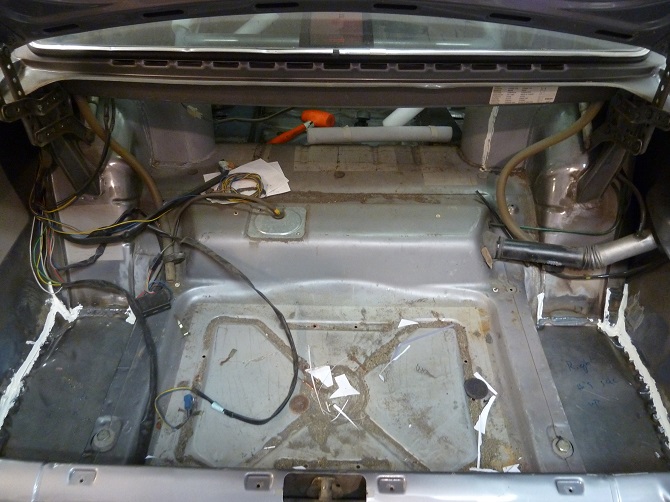

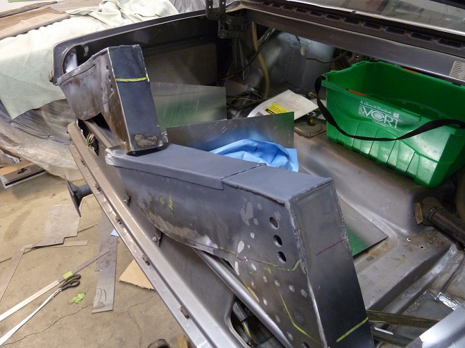

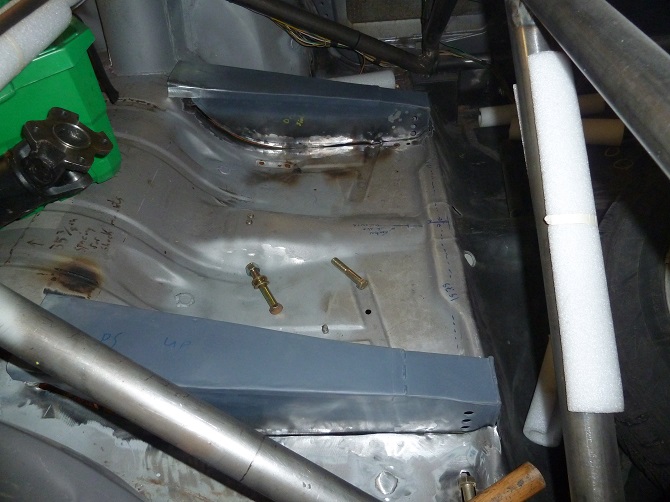

            Cut out the big bulges (known as butt cheeks in the volvo world) in the boot floor. Some research showed that they get destroyed with longer travel + gravel. After running the suspension through its full travel I believed it.
ID:	2015020Click image for larger version

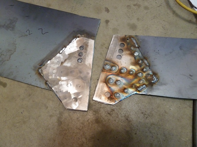

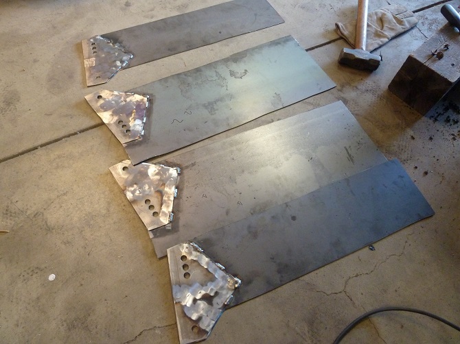

              Then built my own 4 link boxes. I was originally going to use escort boxes/ links but figured it would be a bit small for rally use in this car.
ID:	2015022Click image for larger version
Name:	4 of them.jpg
ID:	2015023Click image for larger version

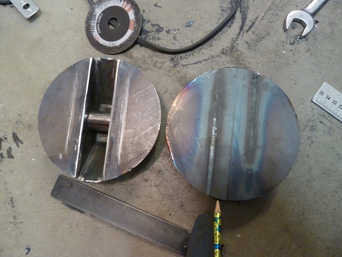

                So in they go. Using escort dimensions and adjustings slightly as needed. I recall needing to narrow the placement of the boxes by an inch in order to avoid the need to cut into the framerails. This is probably due to the fact that the bushings going in them are nearly double the width of the group 4 escort ones I got initially.

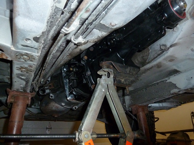

                Rebuilt and test fitted the t5...

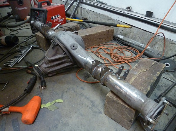

                Cut all the brackets off the toyota axle and welded new ones on.

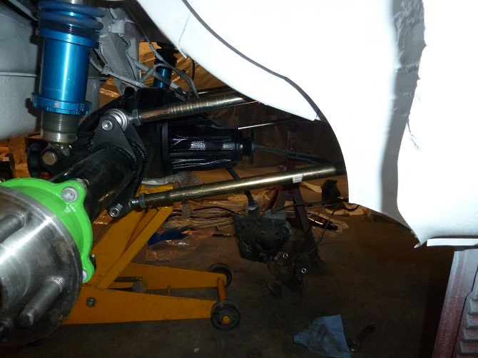

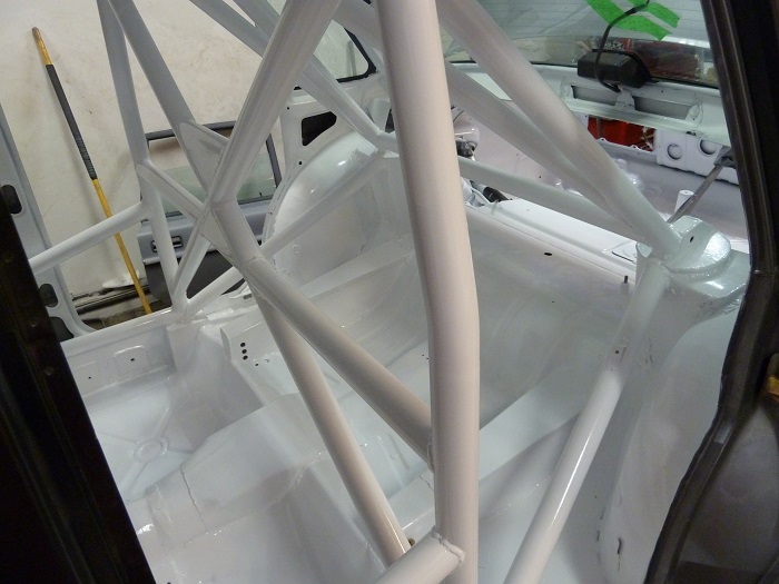

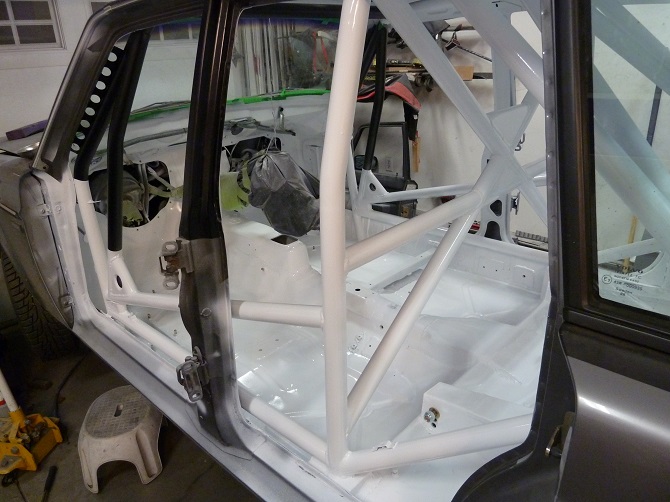

                  After discovering that the now 1 peice driveshaft hit the tunnel I had to alter the back portion of it. Then painted it. aaahhhhh, there is light at the end of the tunnel.
                  And that pretty well takes this to where the car is at today.
Name:	more paint!.jpg
ID:	2015028Click image for larger version
ID:	2015029Click image for larger version
Name:	axle installed.jpg
