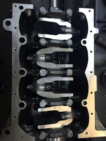

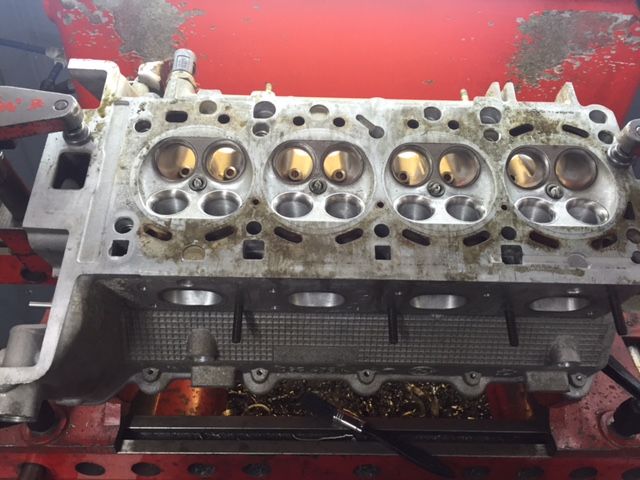

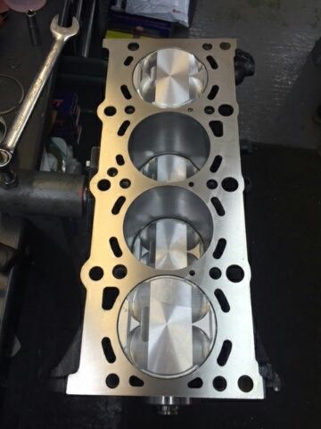

        haven't updated this in a while
        currently still waiting on the engine to come back. been doing a few jobs like moving the relays and the fuses for the spots inside the car to try and tidy under the bonnet a bit.
        but here's a few pics of the engine build that's been sent to me. currently the block and the head are done but waiting on a custom head gasket to bring the compression ratio to 11.8:1, hopefully it wont be long now
