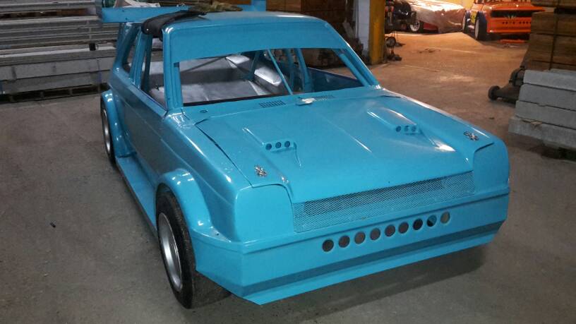

    Picking up this bad boy tomorrow it's on ford running gear brand new 5 link and comes with a type 9, I'm in 2 minds pinto on 40s or zetec on weber 34/36, or even a vauxhall red top on 40s. Just want opinions haven't got loadsa money to chuck at it, if I went zetec it would be run on a esc pack and red top would be on a distributor.. Will get more pics up tomorrow night, hoping to race it at Arena Essex and Swaffham Raceway.

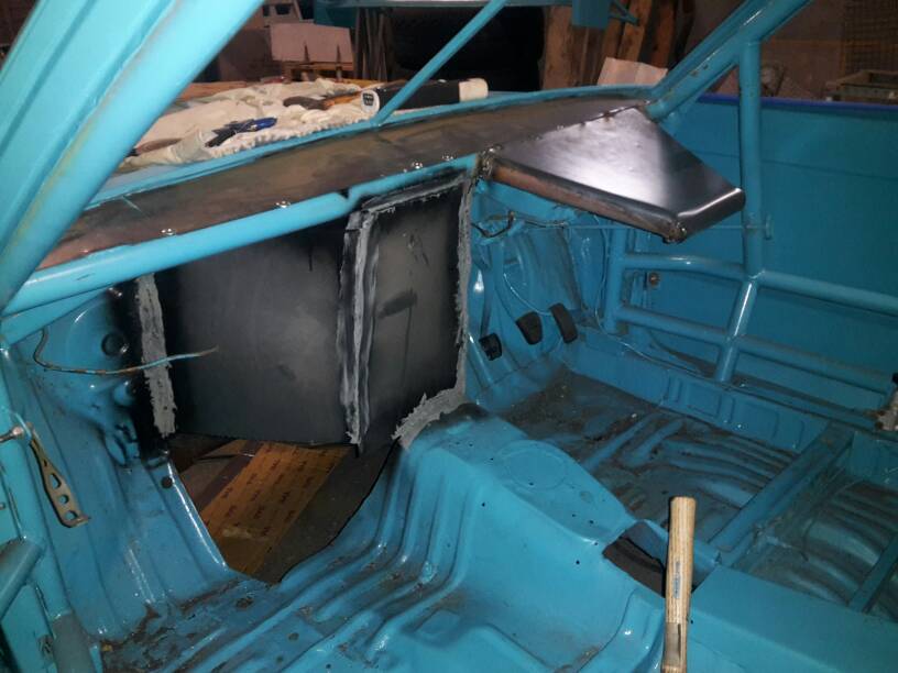

              Kp60/61 hotrod

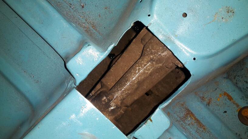

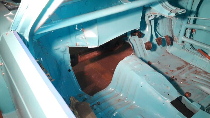

              Little update we've cut some of the bulkhead and tunnel away so the zetec can sit as far back as poss,

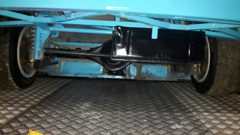

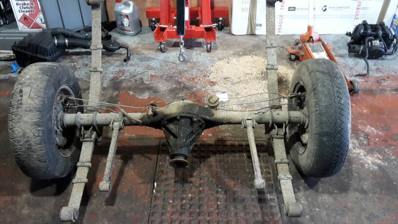

                  Not really an update bit treated meself to this find today an old 1600e cortina axle with the 3.7 diff very cheap aswell

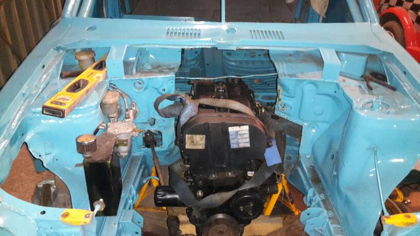

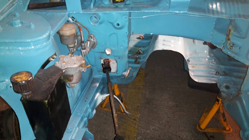

                    Kp60/61 hotrod

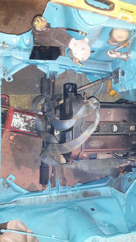

                    Little update we've trial fitted an engine ready to make the mounts up tomorrow night, still got some cutting out to do for the inlet and carb and gear lever, but got it where I want it and looking good.

                      Re: Kp60/61 hotrod
                      Getting the hang of this now. Did ya put the Cvh sump on?
                      • bensrod
                        • Feb 2012
                        • 66
                        Yeah had to redrill the bolt holes

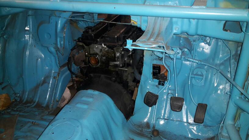

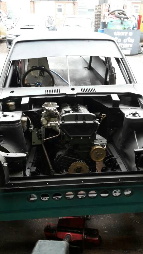

                          Kp60/61 hotrod

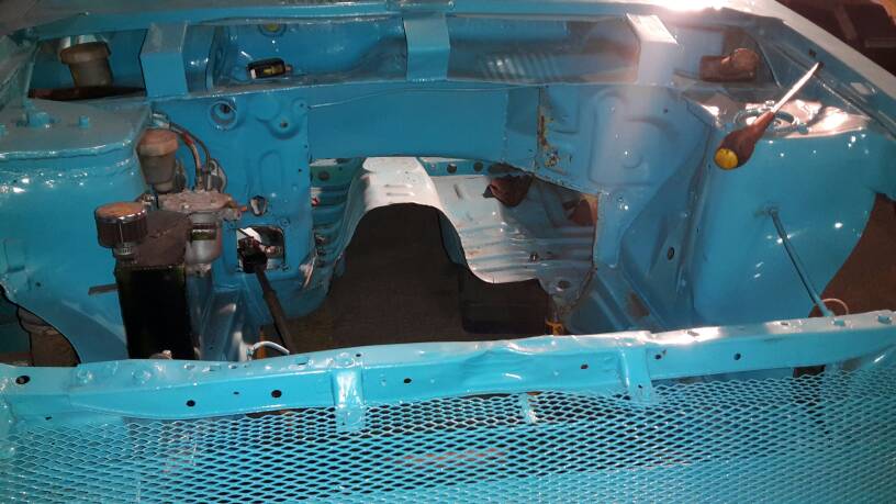

                          Been away from the site for a while but as you can see the fire wall has been put in aswell as the inside painted, we've also changed from zetec to the rs2000 i4 engine
