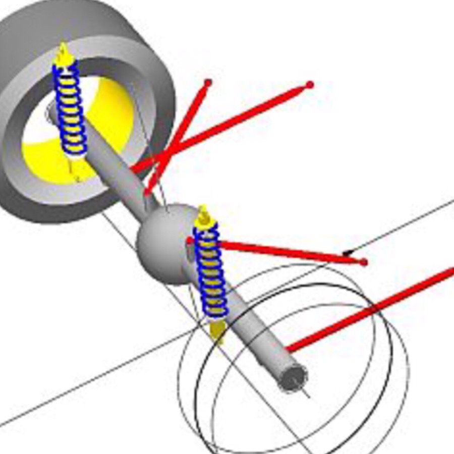

    This is the basic setup, however it has leaf springs

      Re: 4 link MK1 with inboard turrets SATCHEL LINK
      Can't see how that functions with the tie rod mounts in different places requiring them to pivot / travel in different arcs?
      Tramp bars and a panhard is less complicated and works.

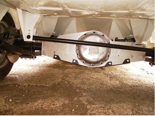

Name:	FTW47 4 link.jpg
              All the world cup cars were built to the same spec. Here is FTW47H, this one was built buy British Vita
              I said works world cup cars
                Surprised to see a panhard rod on that set up, the angled top links the way I understood it was to remove the necessity for it ?
                  Originally posted by James Jordan
                  [ATTACH=CONFIG]82216[/ATTACH]
                  Wrong in so many ways, not as in period, it's a fully floater for starters. May correct reg but not the same as it was. No panhard rod , not used until mk2s
                    Colr6 is correct no need for Panard rod with angled links (its the whole point of them), These are the pictures Oakfields posted when they advertised the car a couple of years back. But this style of 4 link set up is correct for those world cup cars.
                          Quote from the sale of FTW48H.......
                          The rest of the drivetrain was equally “bomber,” with an overdrive 5-speed ZF transmission and a limited-slip Atlas third member. The rear suspension was basically normal Escort, but with the addition of rather weird diagonal radius rods that appear to have been intended more to keep anything else from breaking than to improve handling. It was a conservative but effective approach. Mikkola in FEV 1H won, and all five cars finished in the top ten.
                          From the photograph and from the description above, these axles don't appear to be 4 linked as shown in your diagram so my comments from #3 stand
