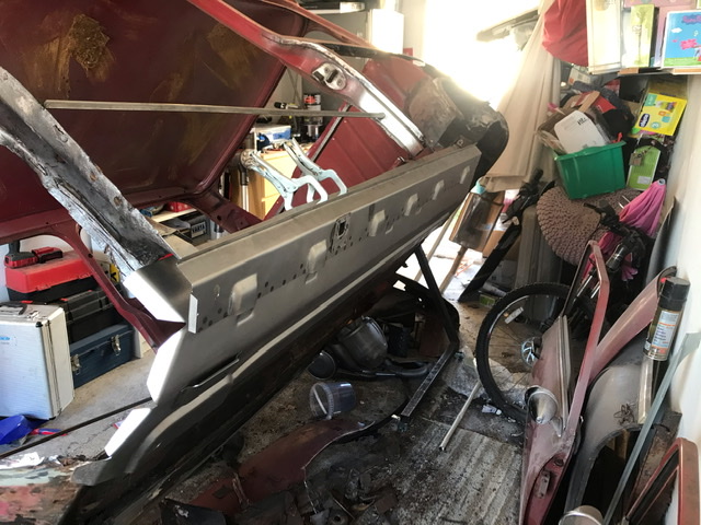

                    Managed to get a little time to sort the garage a bit and make some room. Managed to get the new panels roughly lined up to see where I’m cutting so I can get cracking over the weekend.

                      Just about finished cutting the rotten sills and door step out. A few little things need a repair before I can fit the new panels but we’re getting there.

                            Finally got the floor piece, inner & outer sill fitted today. Door step next then the heel board repair panel, rear arches and then the quarter panel.
