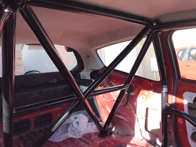

    As you may have seen my Mini build, this is project no2. I decided since the Mini is a long term build, I would need a little something to get me back out competing. So I decided to build a budget road rally/Targa car.
    I bought a cosmetically and mechanically challenges Citroen C2 VTS. It had a few issues which were rectified and the build soon got underway. All the work was carried out during the summer when we were locked down here in Wales so here’s some pics of the build so far.

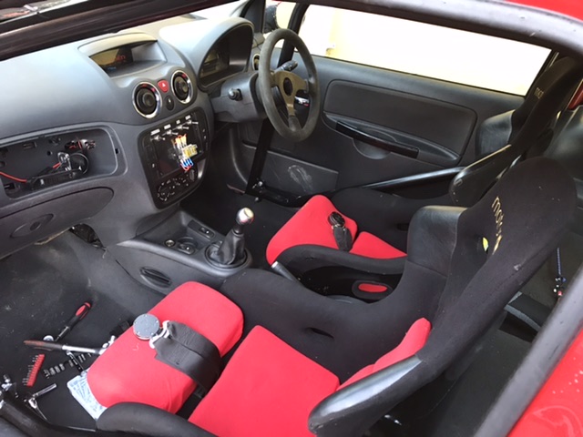

    Quick run down of the spec is. Its got a 4-1 manifold which has been de-catted ABS/TC has been disconnected, All road rally wiring has been done, spots, fan, interior light etc..., It has some fat KONI orange shocks paired with diesel springs for extra ground clearance for the whites and tracks, bucket seats, 5 point harnesess, 6 point bolt in cage.
    Still to do, new brakes and fluid, sump guard and underbody protection, perspex front windows and some chunky tyres.

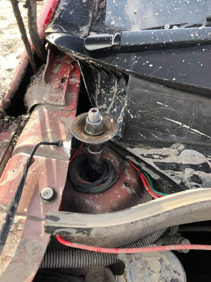

                  So the 1000 Tests didn't go to plan unfortunately. I decent run through test 1 placed us 11th overall and we carried that pace into the second test. Unfortunately towards the end the roughness took its toll and both top mounts failed and we lost the exhaust aswell as a puncture so that was it.
                  Positives to take away from it is that after over 3 years of not competing, the cobwebs were well and truly blown away and also, the little C2 surprised me with its speed. It'll be repaired and strengthened but not sure where to go next. Debating keeping it as it is, upgrading it's spec and getting a Motorsport UK pass to do stages or sell it and get something else. Time will tell but for now it's been cleaned and put to one side whilst I get back to family life and do some more work on the Mini.
