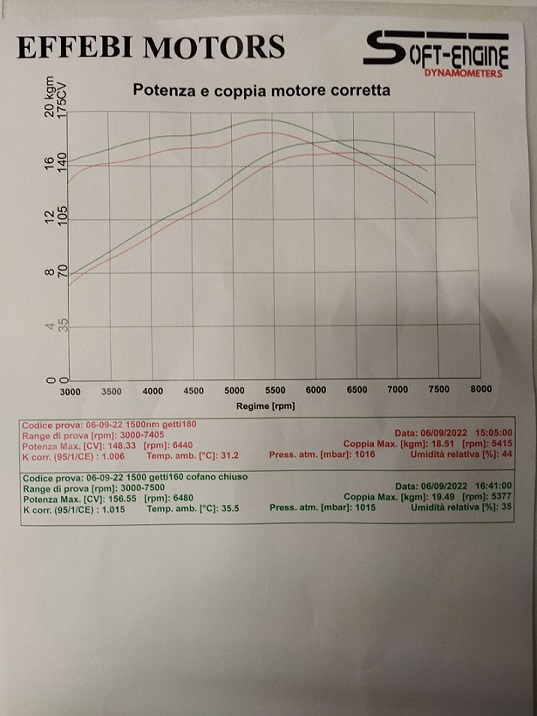

                        After the engine blew, I bought a new head from Vulcan, a stage1, RL31 cam, went 11.3CR.
                        Did the engine work myself, rebored and honed, polished crank, checked conrods. Then lightened the flywheel to 6kg. Pistons are custom made from an italian company, not the best accuracy unfortunately, luckily I'm not chasing the "ultimate power", so I made it work, otherwise I would have had to skim the pistons and rework the CR.
                        Turned it on and it was getting hot like crazy, It turns out it was the thermostat valve stuck, so probably I blew the engine because of that, now I'm running without it, and with the electric fan it works ok, I'll probably do some kind of blockage of the grill in winter rallyes.
                        Went on track to bed in the engine and do some fun laps, but the engine did look way too lean, so it went on rollers the week after.
                        Basically the main problem was air restrictor, so we changed it from 200 to 180.
                        On the rollers we went from 180 mains down to 160, now it is on 12.8afr on high revs.

                        This is the rollers graph, low line is first try. After the first try we did a pull with the bonnet open, it was 6hp more. It was also 35 degrees, but I don't know how the software account for that.
                        So basically the engine free to breathe is around 160hp and 200nm of torque. It looks quite low HP relative to the torque. we only tried to switch ignition timing around, but with no gains. I'd like to try again switching a little the cam timing, just for curiosity.
