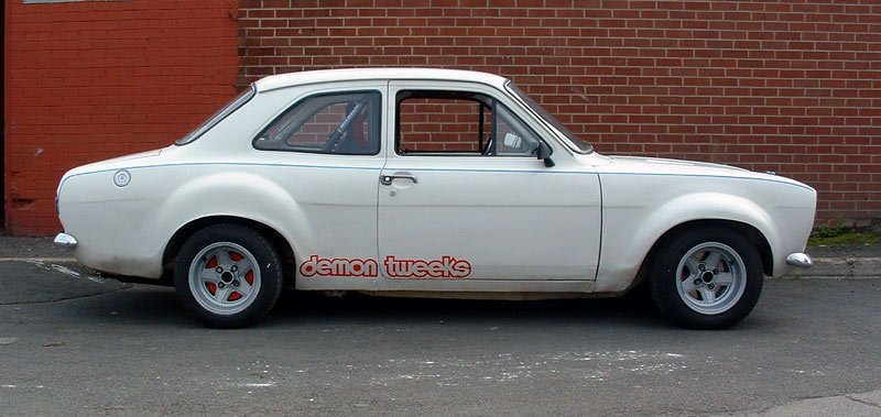

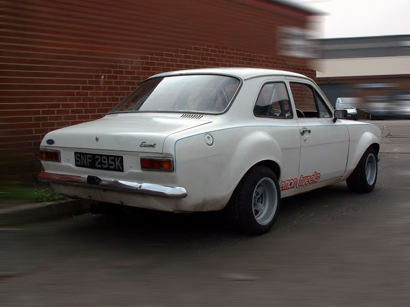

    The first one is my Mk1 Escort 1300 XL
    Watch this sapce as the car's being rebuilt as we speak - this is the spec / pics up until it was last out at Elvington at the Retro Cars track day in Oct 2003
    Body:
    Glass fibre front wings with bubbles, glass fibre rear bubbles, enlarged & strengthened box section tunnel and gearbox housing, cut back and braced bulkhead, box section inner wings (heavy guage steel), fabricated slam panel, alloy firewall, all lines through the car, Capri tank, solid extra guage steel chassis and floor pans, all underside is seam welded, solid and rust free. Battery in boot -
    Engine:
    Fitted with 3.5 Rover V8 Engine - 9.35:1 which was 155 bhp when standard The exact spec is unknown but power is estimated at 200 - 220 bhp. Holley 390 CFM four barrel, Model 4160 - Street carb on Offenhouser inlet manifold, John Eales Development baffled and trapdoor'd sump, Carter fuel pump (fitted in boot), Marine fire retardent fuel hose throughout, Lumenition ignition system, twin 4 to 1 tubular manifolds to straight pipes with Cherrybombs - sounds fantastic - being rebuilt with Piper Fast Road cam kit new internals etc. so should be sound when done
    Transmission:
    Rover 5 speed manual box, 1 piece prop,
    Atlas axle with LSD. Braided hoses.
    Suspension:
    Front: Bilstein 2.8 Capri shocks. anti-dive kit.
    Rear: Turreted coilover shocks, 5 linked
    Brakes:
    Front: Caprisport GTR 260 Kit
    Rear: 9" Capri drums
    Braided hoses all round
    Wheels and Tyres:
    8x13 5 spoke Compomotive MS Racing alloys with 205's on the front and 225's on the rear
    8x13 Lotus Steels with Michelin Pilot SX 20/54-13 slicks
    Interior:
    Stripped out, Corbeau racing seat, centre console, firewalled, Recaros, 2" Luke harness's, rear roll cage.

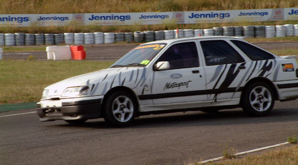

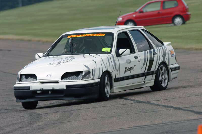

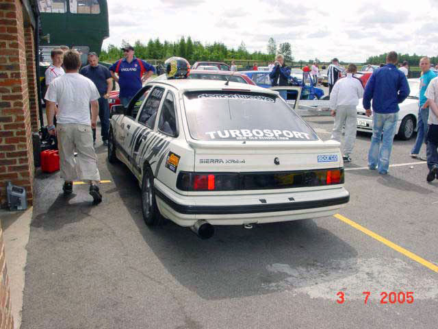

    The second car is my "temporary" track car
    Sierra XR4x4 - Tigger
    It's a car I now share with Ken (RSEscorts) while I get the V8 put back together. Rick B previously owned half of it for the same reason. The inspiration for it came from Dave's (RS2000Custom) "The Gimp"
    A cracking car which owes us very little and has done numerous track days, frequently quicker than much more exotic stuff (although not down the straights) - see the vid clips from the last Durham & Derby RS Owners day from Croft - http://www.northernbloke.com/t-drsoc2005.html
    Body:
    Standard with the addition of a subtle Tiger Stripe kit and blacked out windows
    Engine:
    2.9 litre V6 bored out to 3.1 with lumpy cam etc. Details unknown but it was, alledgedly, built by a rally team mechanic so goes pretty well.
    Transmission:
    Standard.
    Suspension:
    Uprated Koni's all round.
    Brakes:
    Standard.
    Wheels and Tyres:
    Front: Oz with Michelin Pilot's.
    Rear: Oz with Michelin Pilot's.
    Interior:
    Was Sierra Cosworth but is now stripped.
    Steering:
    Standard.
    Pics show the car at Brunters, Croft, Langbaurgh and Donington.
