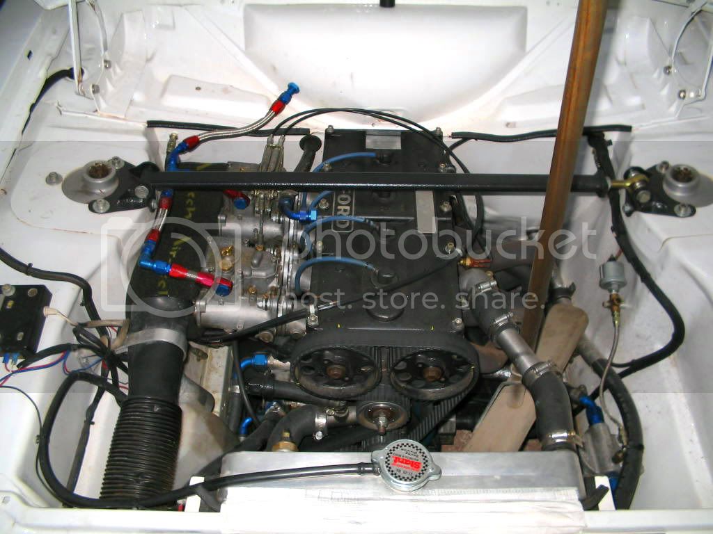

    My m8 maintains race cars so I snapped these while at his shop. As far as I know the car runs BDG on 48's, Quafe 5speed Type 9, LSD, Bilsteins in the back and coil overs in the front. Front also has adjustable TCA's, Willwoods and Superflex bushes all round. Rear only has a panhard rod setup for now.
    We were checking the car because of a misfire and then my m8 wanted me to take the car for a spin to see if all was ok, then the battery died on us Anyhow hope you enjoy.

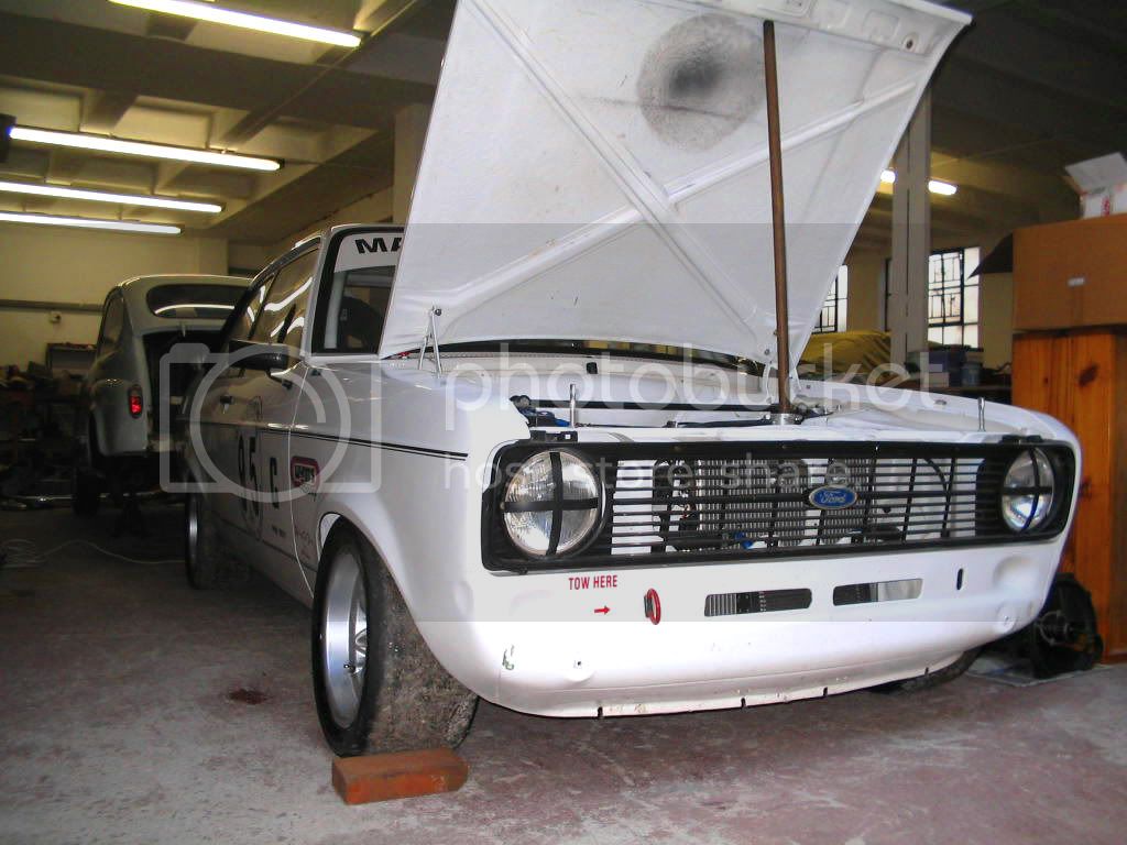

    that looks a sweet motor there my friend , i'm interested in the fiat 600 in the background though
    • redracer
      • Aug 2002
      • 344
      Re: Historic Mk2 BDG
      I stripped that Fiat 600 almost bare , we are doing a restoration.

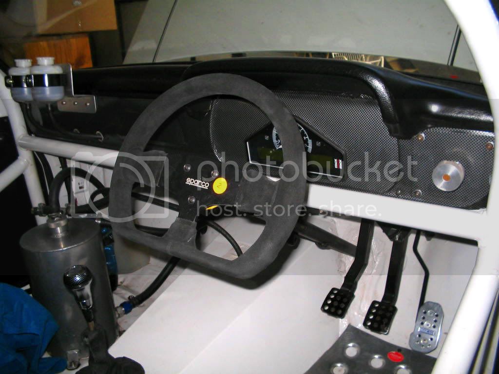

        Very nice car but surely that oil tank isnt legal in the passenger compartment is it ?
          I will ask my m8 about that, but see the same on lots of race cars here

            Nice looking car, bet that BDG sounds the nuts.
            You must have different regs to us cos looking at this pic we wouldnt be allowed to leave the dry sump tank exposed inside the car, or run non braided pipes from it.
            We also aren't allowed to put the brake reserviors inside the car anymore as brake fluid is highly volitile
            Fair dues though its a lovely neat well prepped car kept nice and simple
