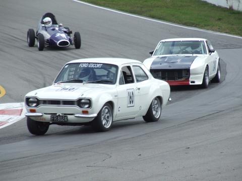

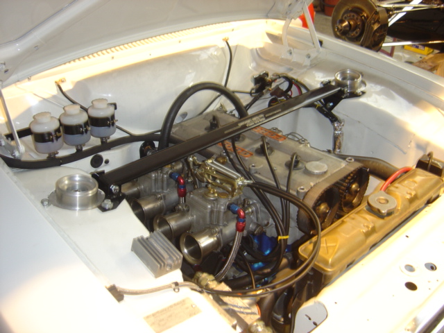

    Some more pics:

          Looks like an excellent prepared car !!
          May I ask where did you get the full-length drain-sump from?
          And does it have lowered rack mounts (with cranked steering arms)?

                  Hi Miniliteman
                  Thanks for your comments about my RS1600.
                  I think the BDA drysump came from Burton Power - they have tone of BDA stuff.
                  I'm not sure I understand your other questiion - I don't think the steering arms are cranked - they look normal to me. We race to pre 1973 preparation standards so I've not done a lot of later mods to the car as I'll only get into a bitching session with our eligibility guys. We're racing this weekend at Mosport so I'll take a pic. of the setup for you.

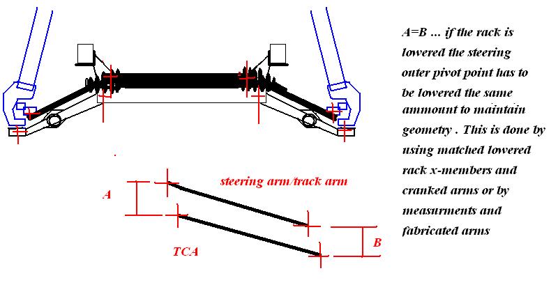

                    It does look like your car has a lowered rack height x-member with standard angle steering arms.
                    Have you checked for bumpsteer?

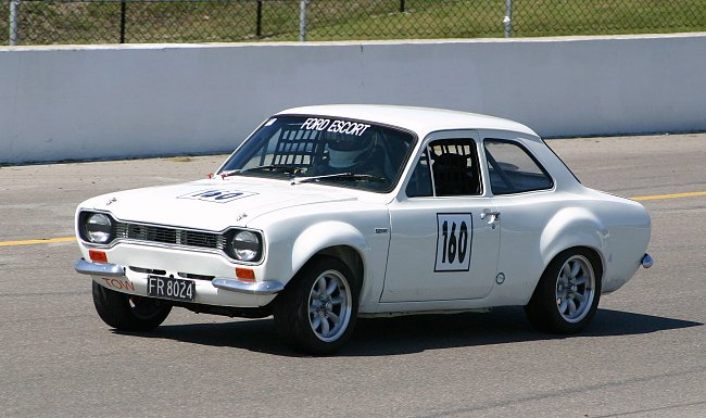

                          We also race in the dry - here's me at Corner 2 at Mosport on Saturday.
