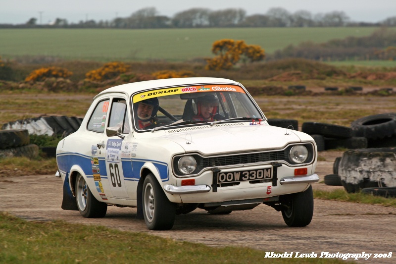

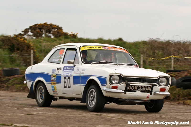

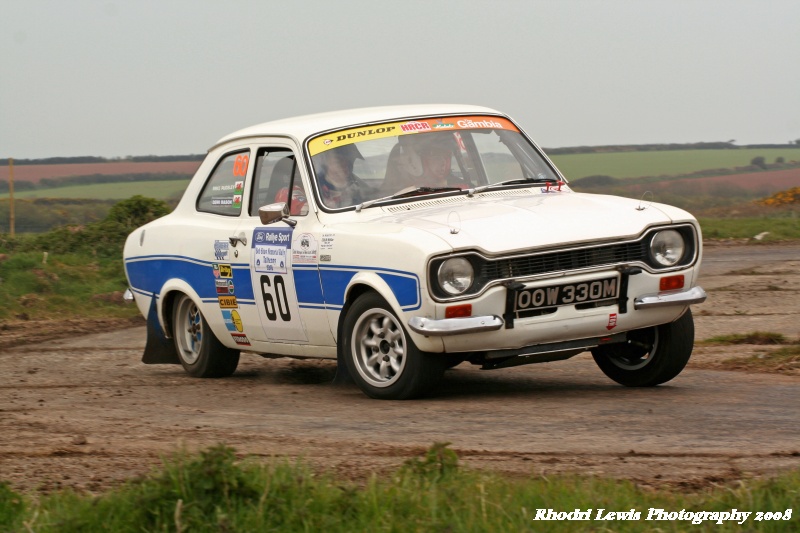

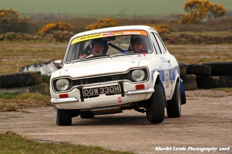

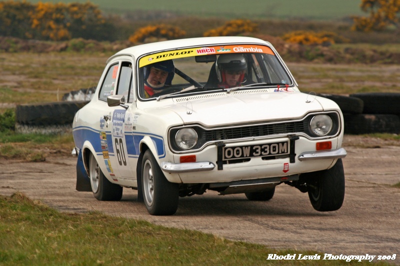

                  Had a good day out, forecast was rubbish but wrong as usual with dry weather all day . This was a round of the welsh tarmac championship so some quick cars were there.
                  Dewi Mason was in the co-drivers seat for this one, his second time in my car. 1st stage was slowed a bit as a Nova had hit a BIG farm trailer into the road leaving very little space to get past.
                  The car went well and we up to about 6th in class but on the very last stage the rotor arm failed & we lost about 4 minutes . This has happened to me before so I had a spare one in the pocket of my overalls, we got a finish but the damage had been done as there were just a few seconds separating lots of crews. Think we finished a few places from last .
                  Rhodri Lewis took these excellent photos & kindly gave permission to post them here. Thanks Rhodri
