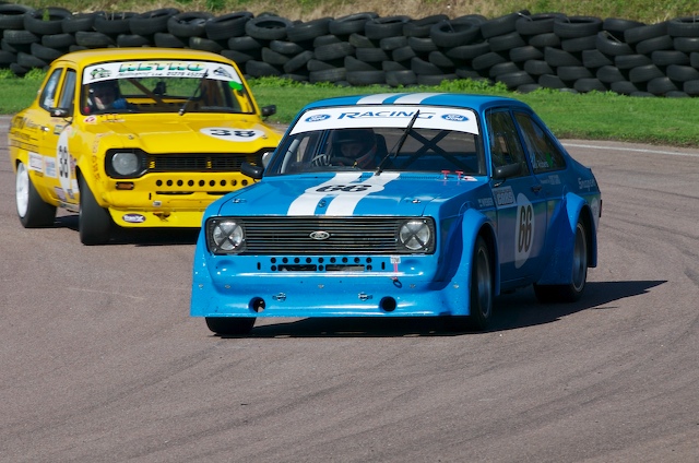

    here's some info on my car as requested by gary@retro
    the car was bought back in 1998 for £50 as an mot failure it was a horrible beige colour but had only done 53000miles with two owners it only needed a headlight ,brake line and very small patch on outersill to pass it,s mot .
    i had at that point been helping roger burgess sort out his newly aquired sprint car and decided i would turn my escort it a sprint/race car

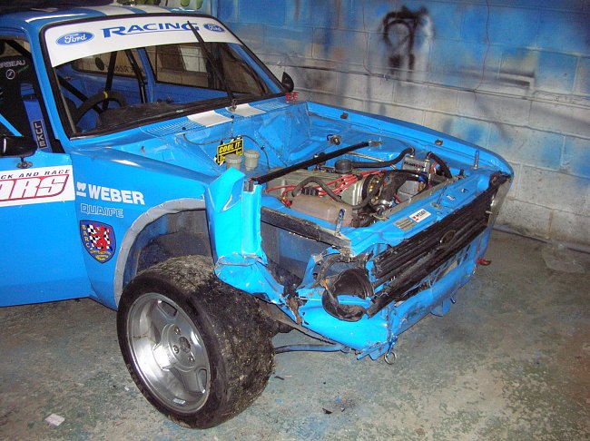

    lots and lots of money later the car got finished ,i sprinted for acouple of seasons then decided to race and was told the trc series was the one to do and so i began first year found myself in class a due to the rules not allow 5linked cars first 3 overall
    last year completed in every round normally just managing to hold mr pipe in his clean yellow escort ,was do very well with the class (now d) title going down to the last race were i unfortunally got involed in an accident ,so i fininshed 2nd overall
    the car as now
    engine 2.0 litre pinto ,big vavle head kent ht1 cam ,forged piston unkown make ,steel rods all lighten and balanced along with the crank and light weight flywheel 4blade paddle clutch running with moddified dizzy and twin 48 webers producing 187.3 bhp
    gearbox quaife pro 5speed
    english axle 4.4 diff tranx lsd
    gaz adjustable front struts
    adjustible tca,s ,eccentric top mounts
    2.2 quick rack and rs 2000 arb
    wilwood 285 disc kit at front
    sierra rear disc at rear
    avo rear shocks
    5linked rear end
    running on 15"revolution rfx avon slicks and yoko ao32r for wet
    body shell lighten were poss with fibre glass bonnet ,boot and doors an zakspeed grp 2 wheel archs and spoiler
    weighing 780kgs at snetterton

      yes indeed. I was gutted when i saw the accident at Brands last year
      Didn't realise you were running an english either Alex!

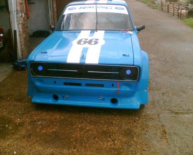

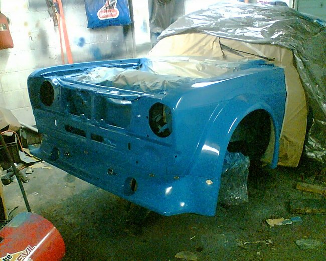

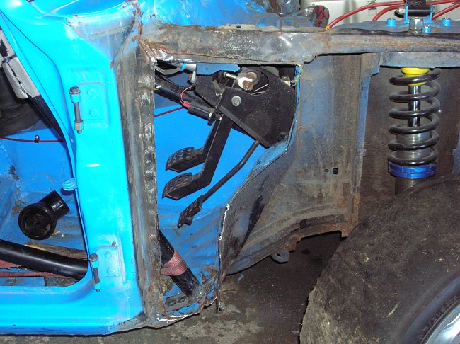

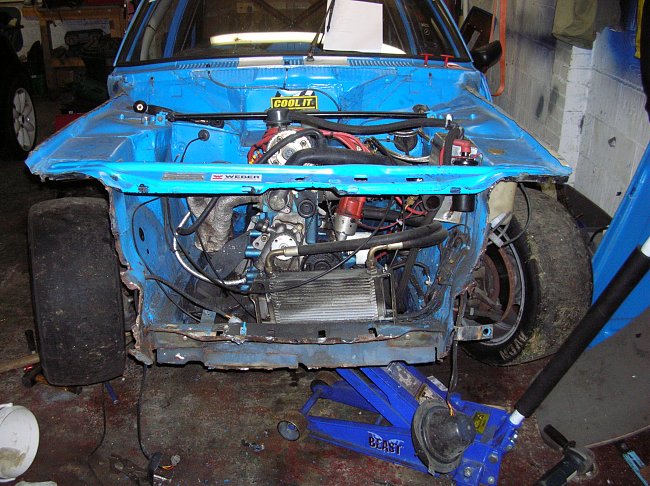

        yep it still runs an english axle and fingers crossed it hasn't broke yet!,the car is all back together again all ready for the season to start, so lets see if the old cars can give some of the modern kit a run for there money, also must say a big thank you to my bro for all the work in helping me get the car back together and all the work he does with me on it through the years

          Thats the 1st time ive seen the damage. Lokking good boyo. See you at Lydden.

            nice neons al

              nice neons al
              Do they suffice as lights as per dtrc regs? I was wondering what to use

                i hope so ,the regs say the car must have forward facing lights in postion of original lights ,lots of cars last year used household downlighters(12v) bike lights .i decide not to refit the 7"sealed beams as i broke 4 last year manly through stone chips hope this gives you some idea
                  Im using 12v household down lights, with neon lamps inside
