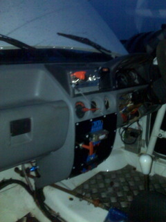

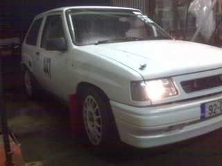

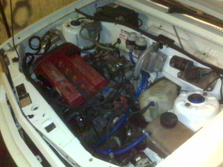

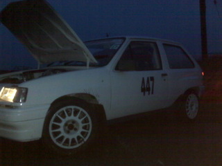

    just as im waiting for my sunbeam to be painted and have nothing to post i said i may aswell show my rally car.. its a nova powered by a suzuki motor mated to an opel box with quite a few modifications to say the least. built her in 04/05
    pics not great sorry.. this lil lady has sum bark n can go like stink, uprated hubs,big shafts and cv joints,competition suzuki preassure plate and opel paddle clutch,hockley hub bearings,tarmac coilovers,vw caddy rad

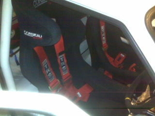

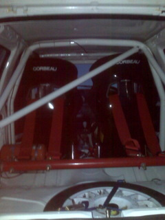

    shell fully seamed top to bottom,front to back, reinforced spring plates rear, white underbody, sparco cage, full rewire, plumbed in, harnasses,hand helds etc, quaiffe box with hockley diff and big side gears also quaiffe gear stick and turrett, cobaru revenge seats,carbon door cards, omex limiter, four branch,engine full race spec on 45s,full stainless,speedline corse wheels,2l gsi brakes including rear discs with ferodo race pads all round,corsa electric power steering,all brake and fuel lines fully braided,pedal box,spherical top mounts, elliot 3 clock dash,shell finished in dianond white,poly bushed throughout,strengthened bottom arms etc etc.. list goes on and on.. so on that note better go before you rwd boys start slaggin haha..

              Whats involved in the gearbox adaption and why do it.
              ipresume as the suzuki box is a weak point, but surely there are replacement parts to upgrade. Is the opel box that much tougher. what is it from whats necessary to fit.
              I know a whole country full of Suzuki owners that would love the answer to their weak gearboxes on the back of their turbo swifts.
