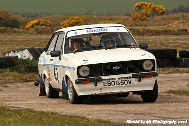

                              Re: Harrier Rally Car
                              Hi All,
                              Pics from latest event at Talbenny on the weekend.
                              Not a good day!!
                              Stage1, Knocked axle loose on some tyres and it swung around like mad!!
                              Stages2, Axle came off again as one of the lugs was wrecked so it swung around loads again and caused lots of spins!!
                              Stage3, leads fell of dizzy several times, stopped to put them back on several times losing loads more time, axle came loose again
                              Stage 4, after bolting axle back on guess what happened, it fell loose again
                              Stage 5, very good clean run and was great, axle held on by a ratchet strap at this point!!
                              Stage 6, car cut out in start queue and had to be bump started. Car then cut out at haipin after all lights on dash went off and couldn't be restarted, end of day.
                              Loads of problems but fun anyway and highlighted the areas where I need to invest some time and cash. Pics below kindly sent to me by Rhodri Lewis.

                                PS Told you front suspension was too soft!!!
