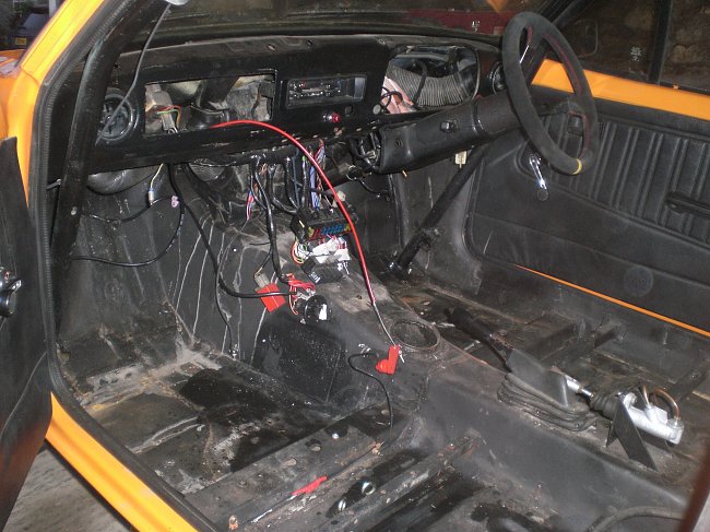

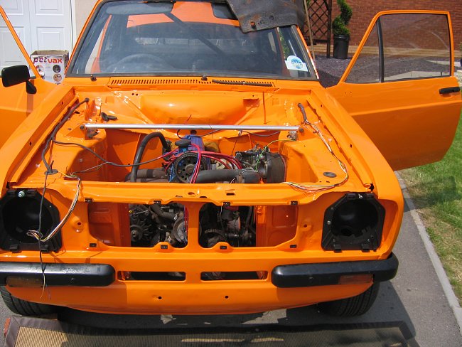

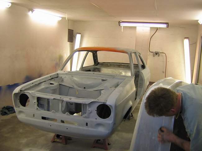

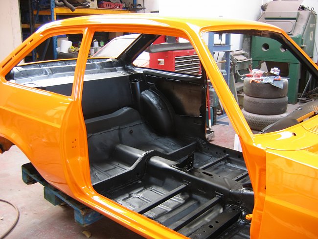

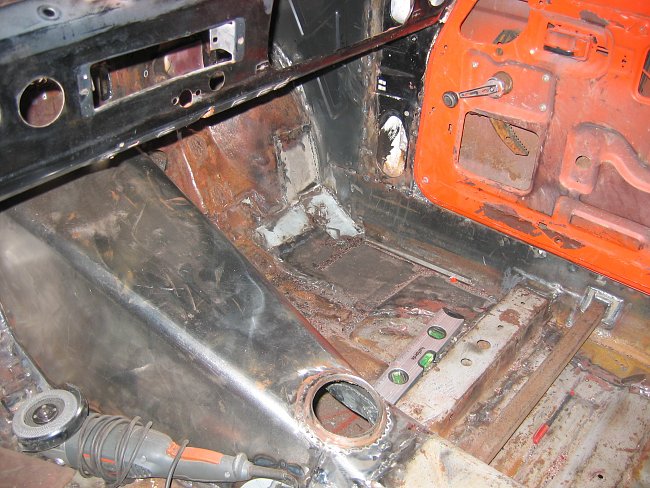

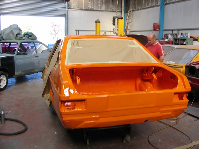

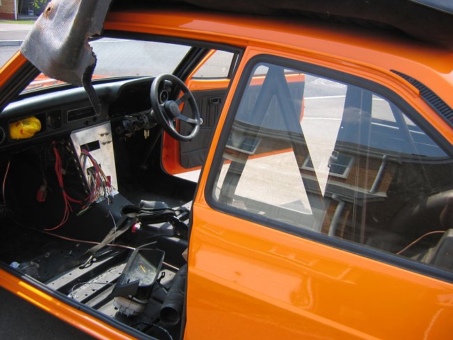

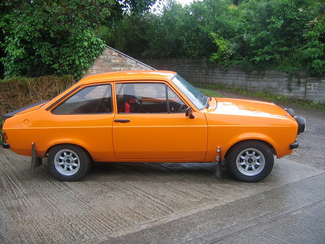

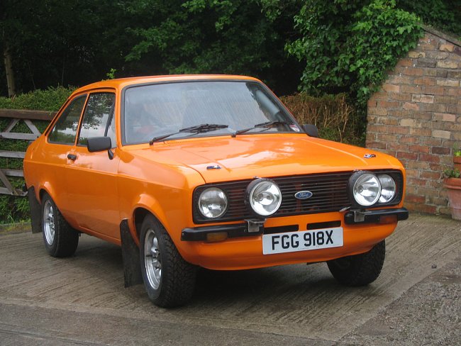

    Thought i'd put some pics up of my new mk2 mexico road rally car that i bought last week. The previous owner carried out all the work. Brief spec of the car:
    SHELL
    SEAMWELDED AND STRENGHTENED
    BIG BOX TUNNEL
    TURRETTED
    CAGE WITH DIAGANIAL AND DOOR BARS
    FIBREGLASS BONNET
    VW ORANGE 2 PCK PAINT
    ENGINE
    2.1 WITH 2.25 PISTONS
    GRP1 HEAD
    VALVES 44.5 IN AND 38.1 EX
    BRONZE GUILDS
    PORTED AND POLISHED
    HIGHPRESSURE OIL PUMP
    RL 31 CAM DOUBLE SPRINGS
    SINGLE 45 WEBER
    ALLWAYS RUN ON VR1 RACING OIL
    RUNNING GEAR
    5 SPEED TRAN X WITH 2.39 FIRST GEAR
    QUAIFE SLIP 4.7 CWP NEW
    ONLY DONE 1 EVENT
    COMPRESSION STRUTS
    BILLIES FRONT GRP1WEDGED
    BILLIES REAR TURRETED
    NEW PANHARD ROD AND TRAMP BARS
    NEW SPRINGS F AND REAR
    NEW BIAS PEDEL BOX
    PRINCESS CALIPERS 1144 PADS
    VENTED DISCS
    SIERRA REAR CALIPERS 1144 PADS
    NON VENTED
    ALLOY TANK AND BATT HOLDER IN BOOT
    TWIN FUAL PUMPS
    AND TWIN SPARE HOLDER
    SPARCO SEATS
    NEW WIRING LOOM ALL FUSED AND RELAYS IN CAR
    ASHLEY 2 .25 EXHAUST AND MAINFOLD
Name:	Bare shell1.jpg

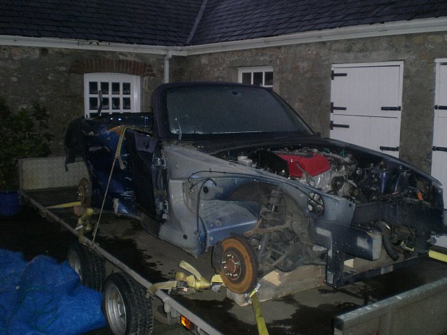

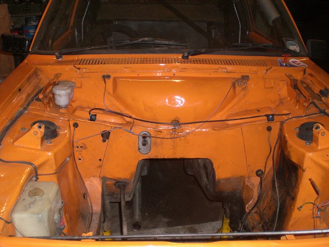

                      Just thought id give a bit of a update. The old pinto and gearbox have been sold. The car is stripped down and another honda vtec powered escort is on its way.

                          nice1 wayne.ye i will probably need some help with somthing in the future. the engine is out of the s2000 now and a jems crossmember is on order.
