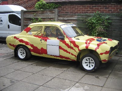

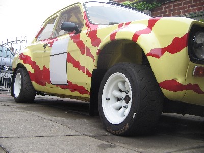

    As we're about to get our car back on the road after 2 years, I thought it was time to start a thread.
    The car is co-owned by myself and my brother (Beany on here).
    It's been in the family since 1981, and used as a rallycar since 1987.
    I know the colour scheme won't be to everyones taste (not very retro), we painted it like this about 10 years ago, trying to copy the Seat Cupra works rallycars!

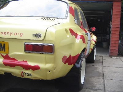

    The car is sitting a bit high at the moment - there's no engine in it yet, and the rear needs lowering a little.

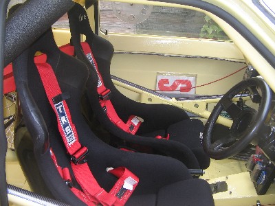

    Whilst it's been off the road, we've made a few improvements, most of which have come from reading various threads and posts here on Turbosport.

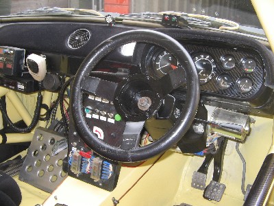

    We've had a new rollcage fitted, which picks up the suspension top mounts, and should make the whole thing much stiffer.
    We've fitted a Corsa power steering column, which I would never have attempted until I read on here how relatively straightforward it is.
    We're going to try different front suspension geometry, and play around with spring rates to improve the handling.
    We swapped our semi-floating baby Atlas for a fully floating wide one (the early single bearing one - couldn't afford a twin taper one!).
    We've added a flocked dash, and other bits and pieces which hopefully give it a better finish.

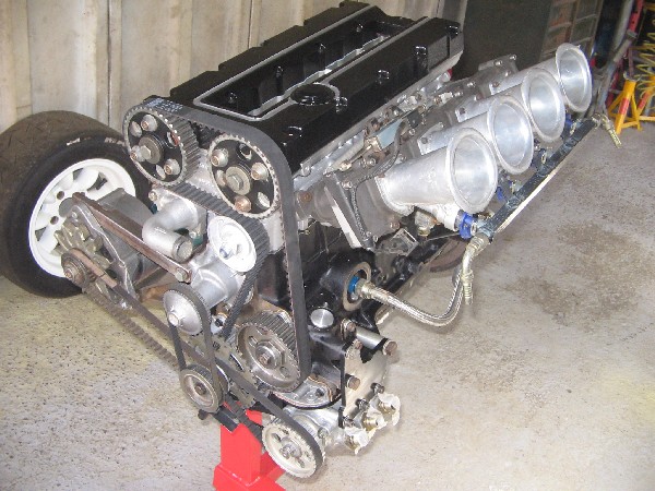

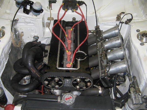

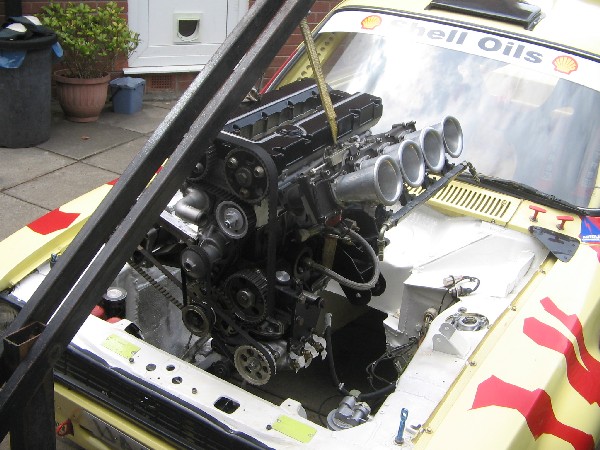

        We got the engine back this week....
        And put it back in after we'd found all the bits that we'd taken off it over a year ago...
          Re: MK1 Escort Tarmac Rally Car
          Tasty looking engine that good luck with the rebuild

            Great looking engine there mate! All the best with it!

              very nice car, not sure about the paint though, nice looking mill,so what spec is it,cc stroke etc,love the injection set up,after ideas on that front myself.

                Thanks for the comments (and for not being too harsh about the paint scheme!!).

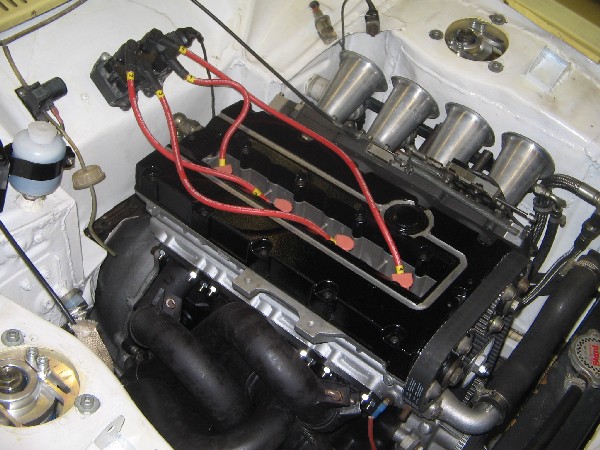

                The engine is now intalled, and the engine builder came round tonight to start it up with us (he insists on this, which is great).
                The only issue was the starter didn't disengage, so will probably require shimming a little.
                Brief spec of the engine is:
                Big valve head, with L1 and DA10 cams
                205 block bored out to 93mm, short stroke (72mm I think) billet steel crank, forged rods and pistons. This gives a capacity of 1956cc.
                Slide throttle fuel injection and DTA management.
                With it being a short stroke, it doesn't give huge torque, but the builder has played with the cam timing to try to give us a bit more than the old engine.
                This is the first time we have had an engine professionally built (usually buy second hand, and before going to Cossies, we built our own crossflows), and up to now we're really pleased with the results.
                The normally aspirated Cossie is being replaced with Duratecs, Honda's, and even Volvo engines in rallying, but hopefully we can still give it go. The Duratecs particularly are giving huge power and torque outputs.
                Next week it will be going on the rollers to be mapped.

                      We've had a busy and frustrating time with the car over the last couple of weeks, including taking the gearbox out 5 times to sort the clutch out.
                      Anyway, we're really pleased with the engine, which has now been mapped, and is giving 262bhp at 8248rpm, and 188lbft of torque. The torque figure is a big improvement over the last engine.
                      We had a short test with the car at an outdoor kart track in Preston (never got it out of 1st and 2nd gear), and have a list of problems/niggles to sort out before this weekends rally.
                      First impression is that the new engine pulls like a train compared to the old one, but we won't really know until it's out on the stages.
