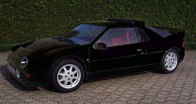

      I turned a white RS200 black once for someone...
      The thing to do when doing any colour change IMO is to seperate the bits with the colour you want to change onto another layer then save the layer as a backup (as it takes some time to seperate nicely) and past another layer with you coloured bits and work on them from there. I'm sure I went through the process for this in the Gulf Capri thread.
      Capri Thread, Look at page 3
      I also usually double the size of the pic before working on it as it helps smoot the finish after you resize it back afterwards.
      For the black stuff I'm sure I just used a mixture of the ttols available. ie Negative image etc. Until I found something close then touched up the remains by hand. It's important to note it very rarely comes out really nice without some manual touch ups.
