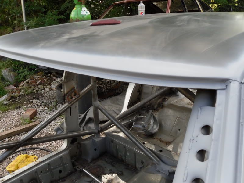

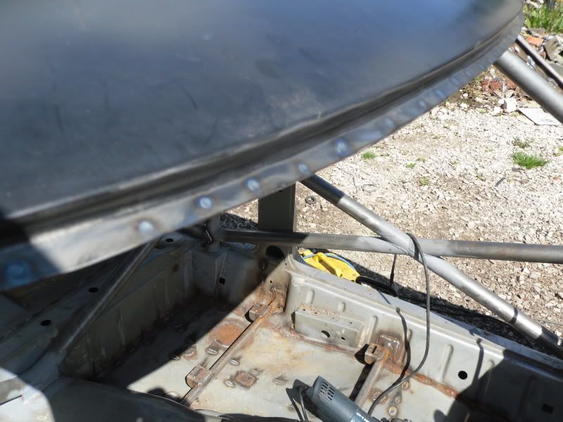

    Roof on for a trial fit, not being final fixed until the cage is welded in...........

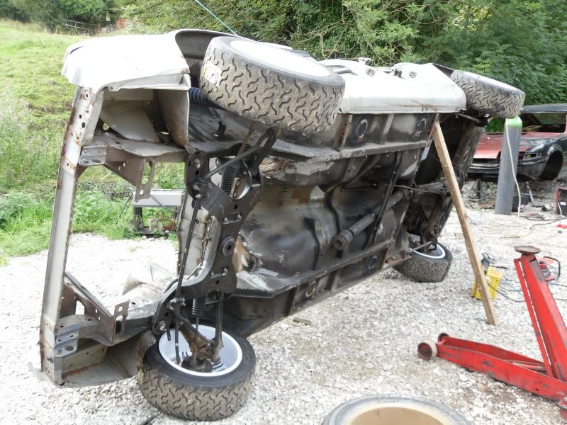

    Impressive amount of droop/travel.......

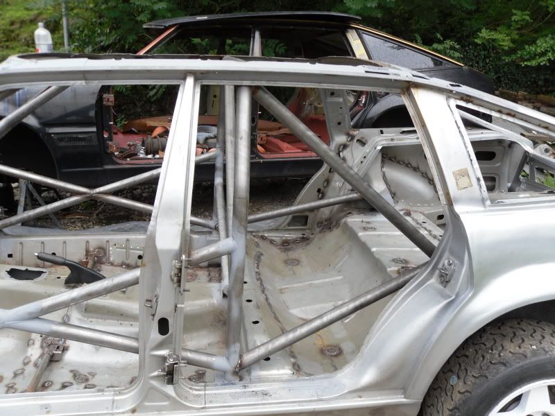

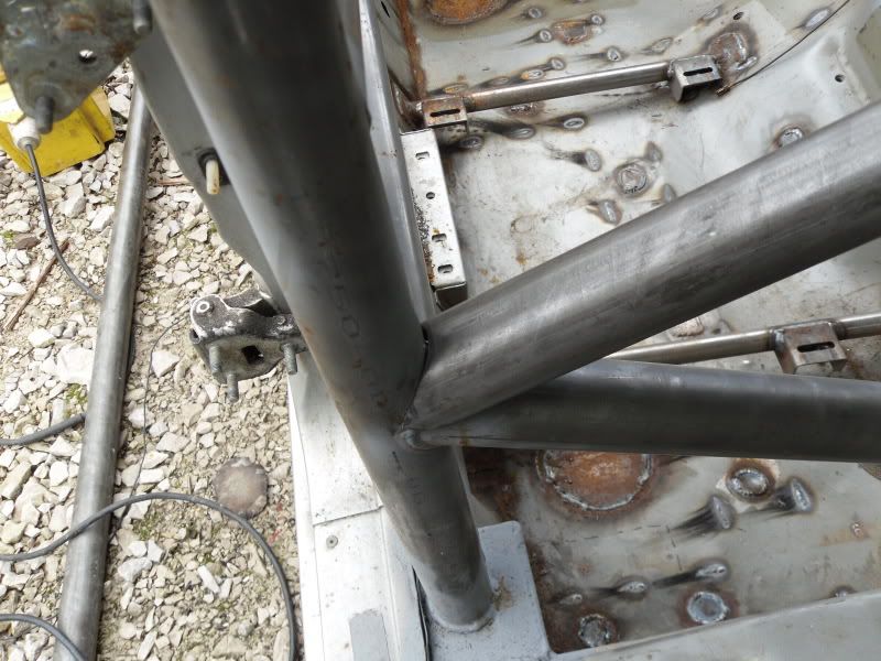

    This cage is only a mock up, bought very cheap but won't be the finished item, I am having an exact replica of the Group A cage built eventually..........

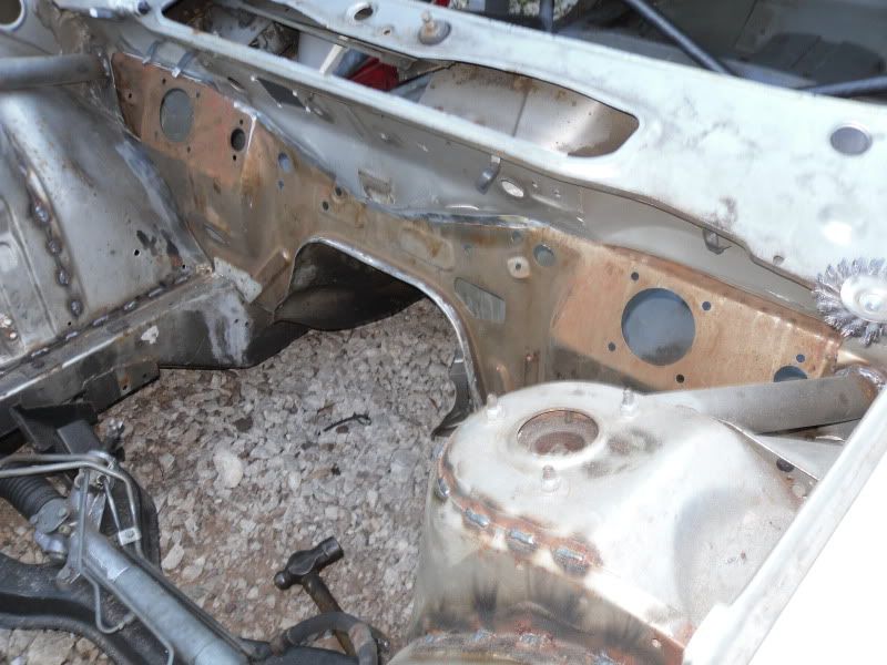

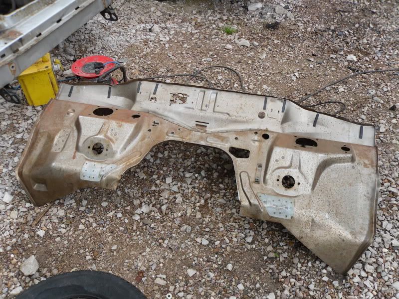

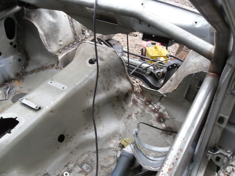

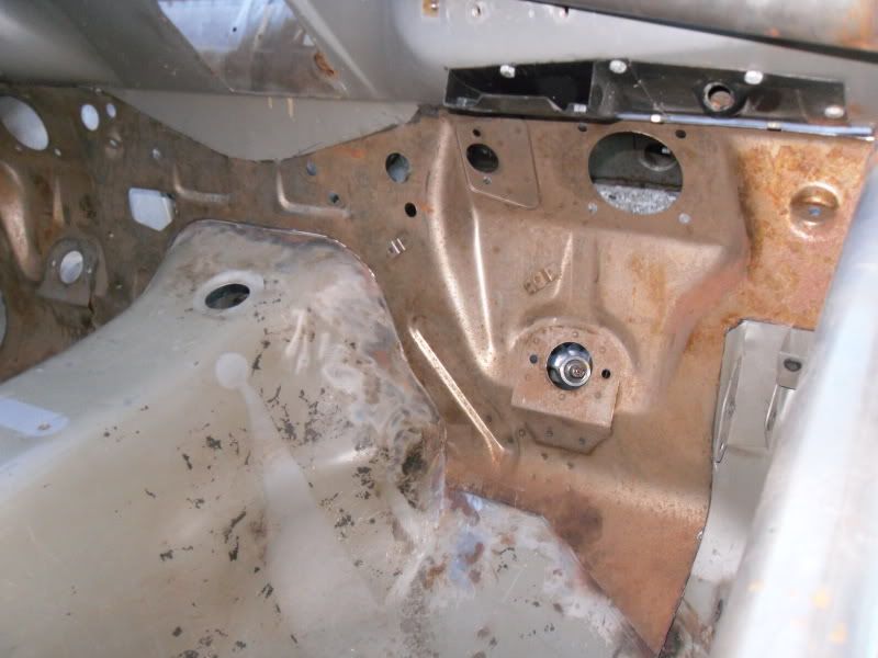

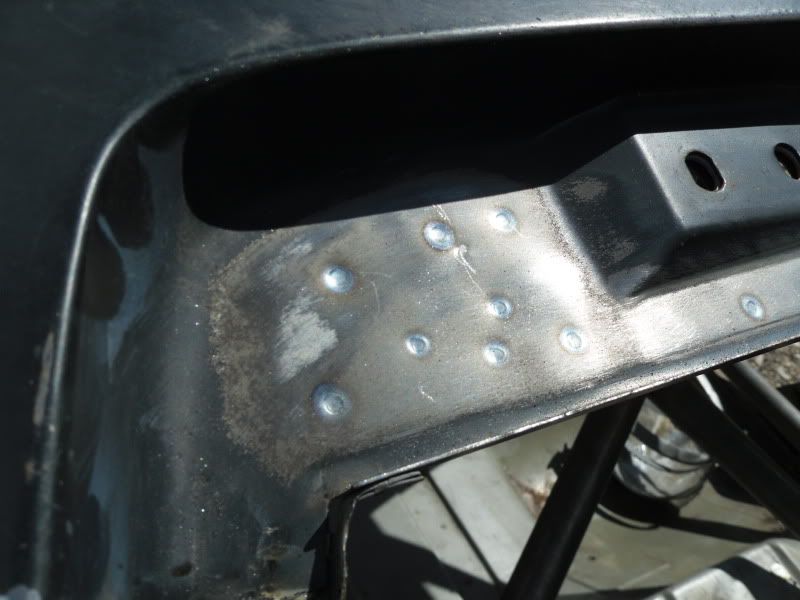

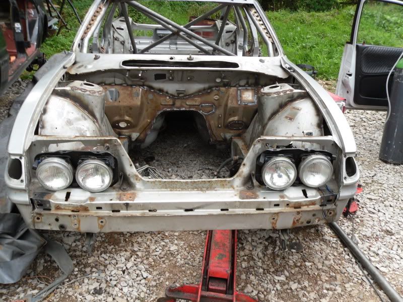

    Some pics of the rot spots in the bulkhead, had a weigh up yesterday and I will definitely treat it to a bulkhead panel........

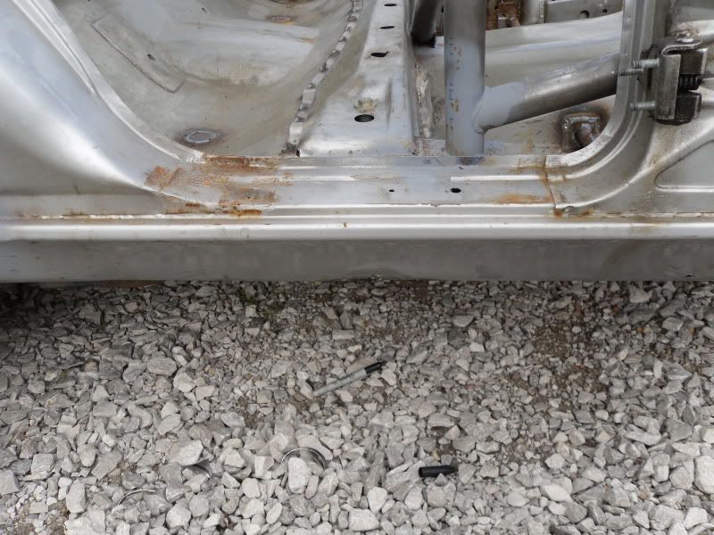

    At least the inner wings and chssis rails are all sound........
    The underside is extremely good..........

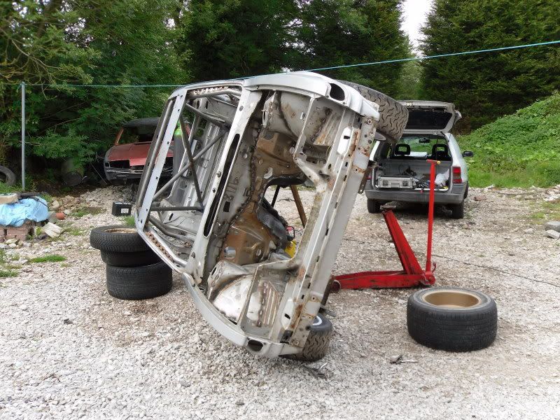

    started removing the bonnet, then took the drivers front door off, and this happened!..........
    So finally back down, doors off etc.........

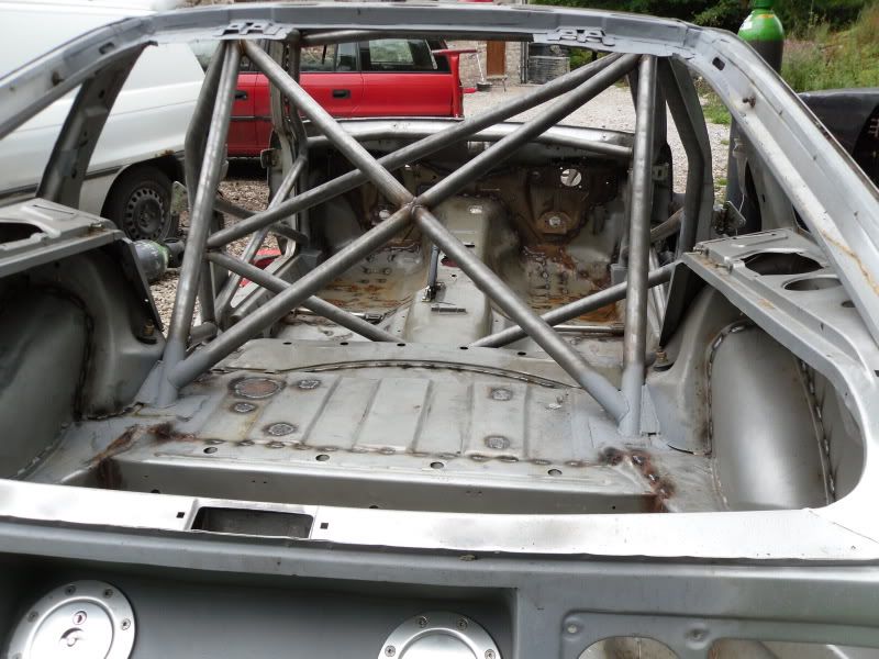

    And finally, the big one, cage done, really pleased with it.....................

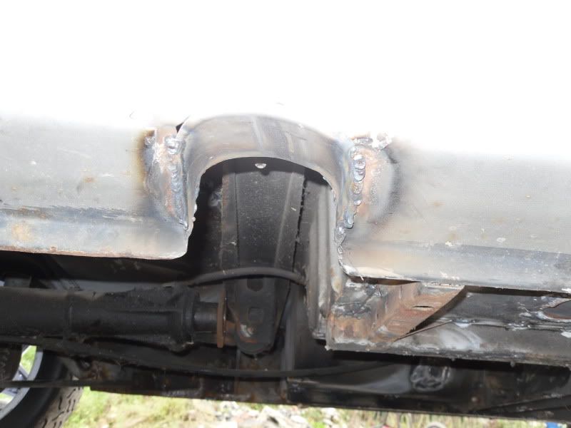

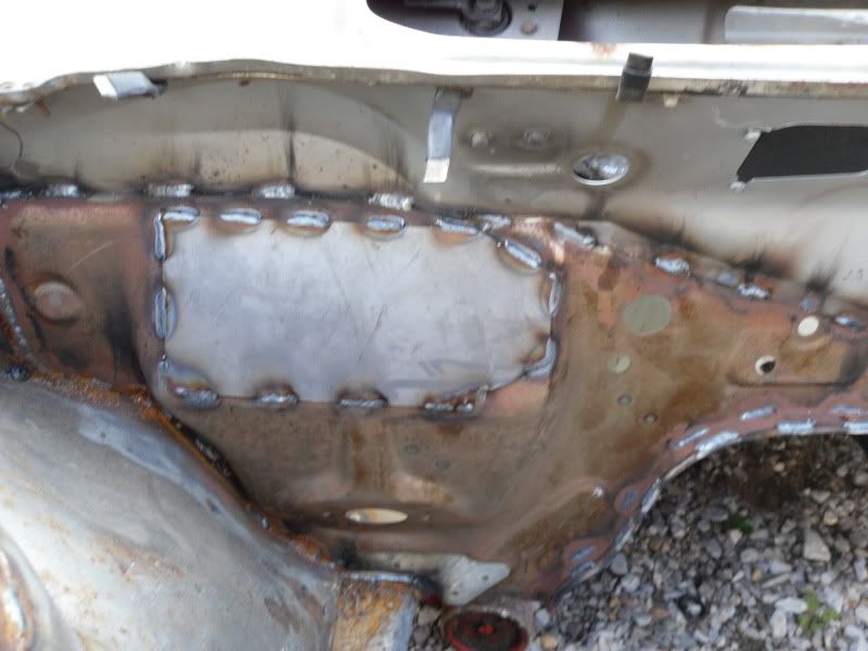

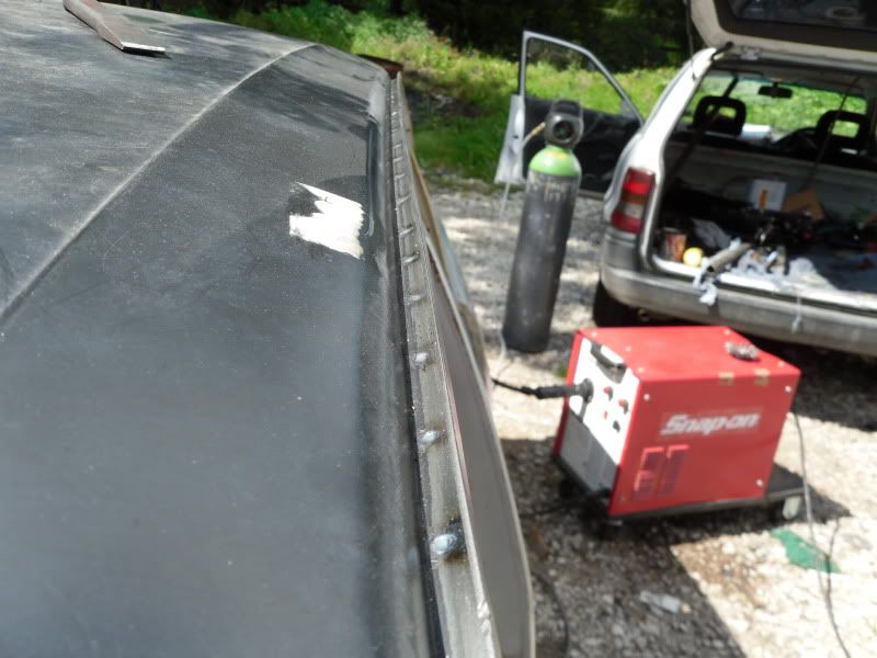

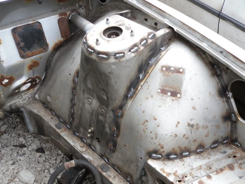

                            Well, productive day and a bit, got most of what I wanted to done, then ran out of welding gas! "Oh bother!" i said [:p].
                            Anyway, pics as usual............

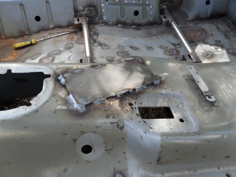

                            Firstly, fit this...............
                            In this hole here........
                            Offered up for a trail fit before welding....
                            Stitched in..........

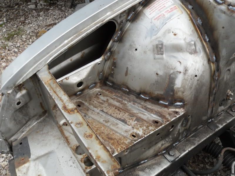

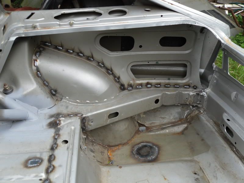

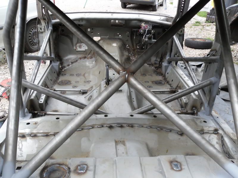

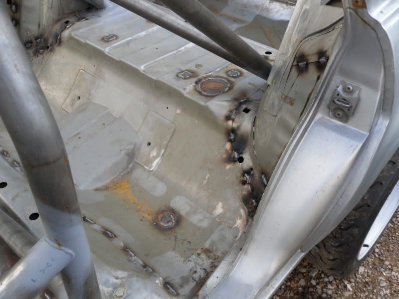

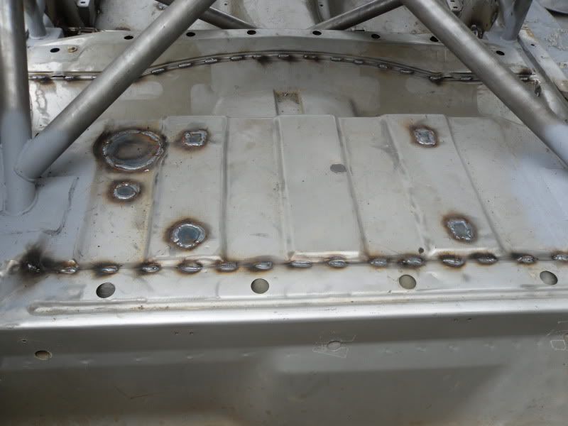

                            Purists will note that I haven't really done it the "Factory" way, by unpicking all the spot welds and re-spot welding it in, instead I hav just fitted part of the panel and stitch welded it in to match the rest of the seam welding, it also over laps at the bottom where it meets te chassis rails effectively double skinning it for added strength..............

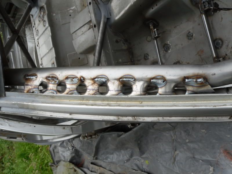

                            I also wanted to finish off doing the seam welding on the underside, so I can get some paint on the inside, not one for welding upside down................

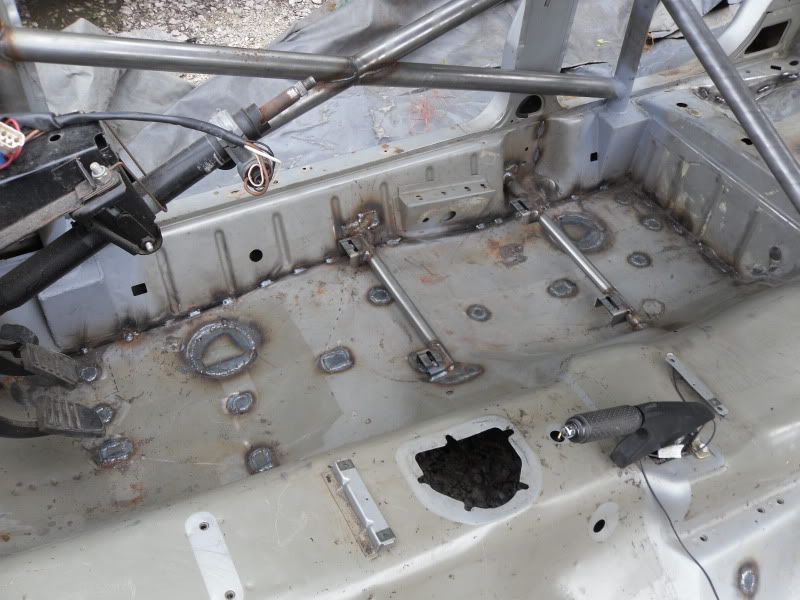

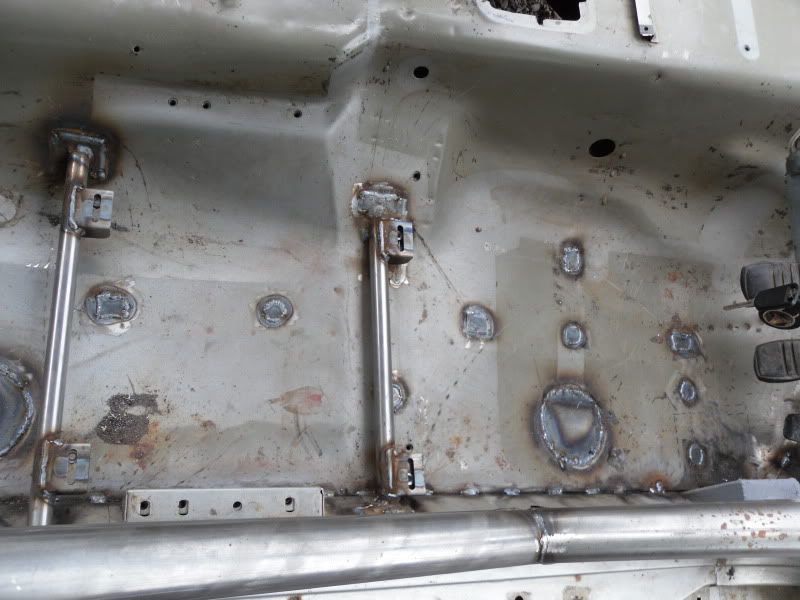

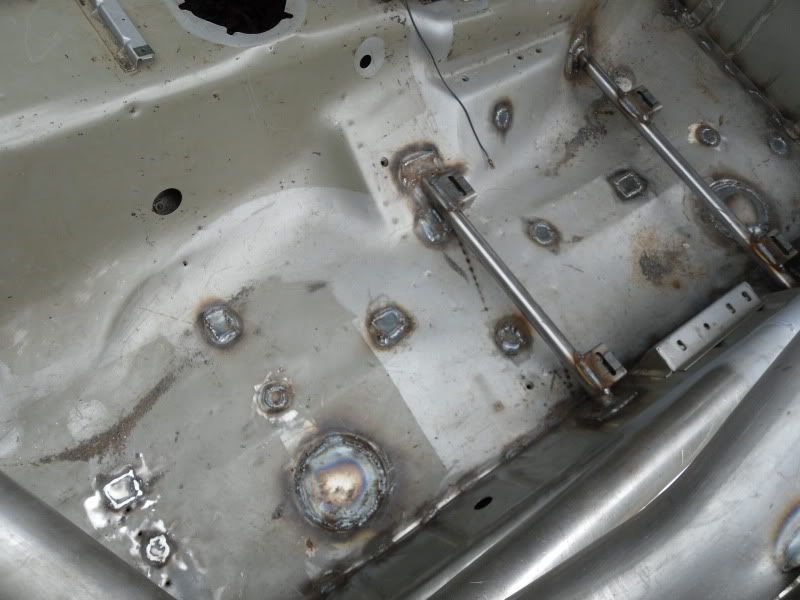

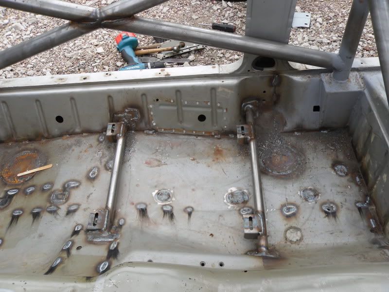

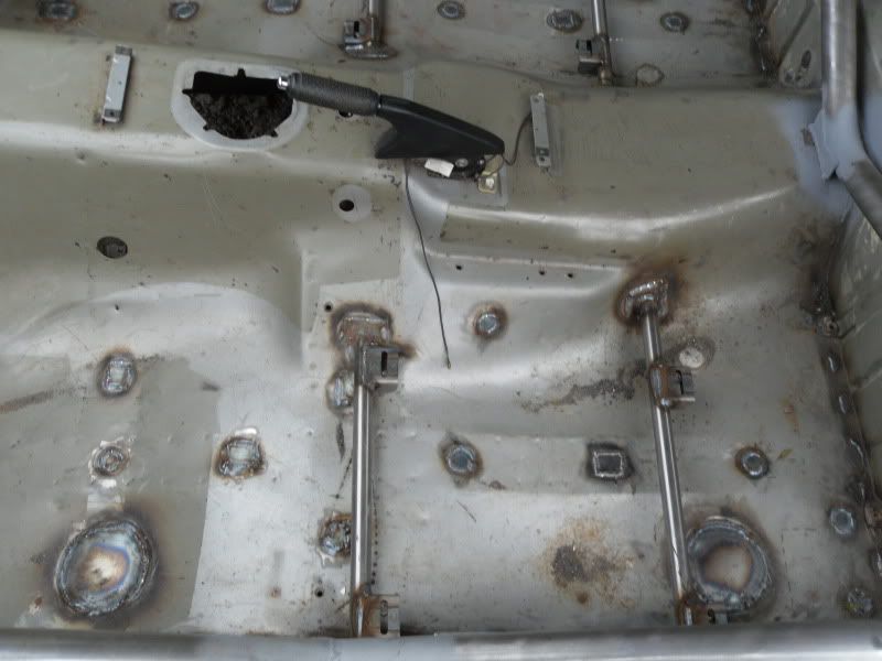

                            Last, but not least, when I ran out of gas, I attacked a job that I had been avoiding, drilling the original seat mounting brackets off.........

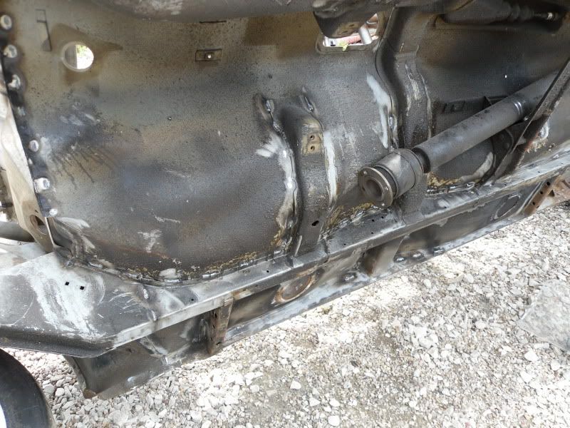

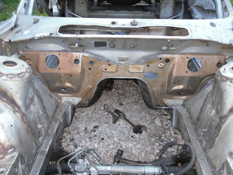

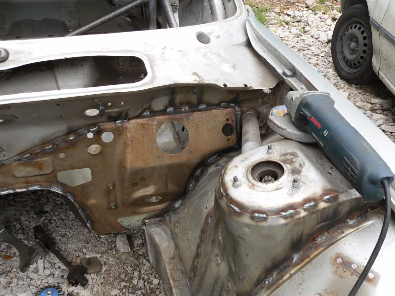

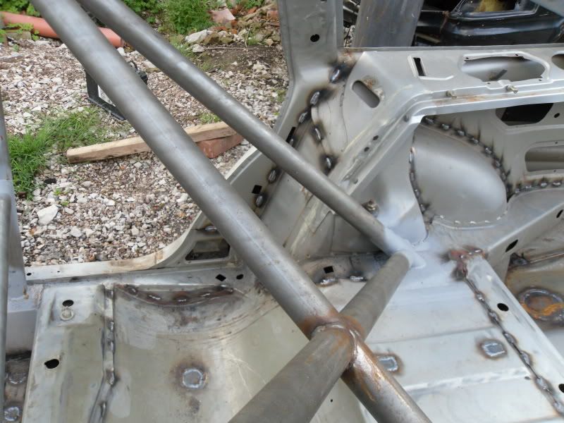

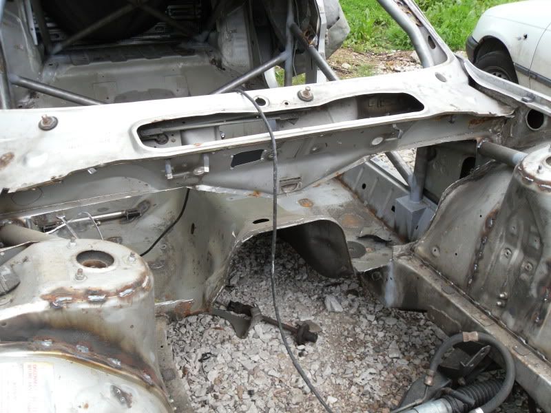

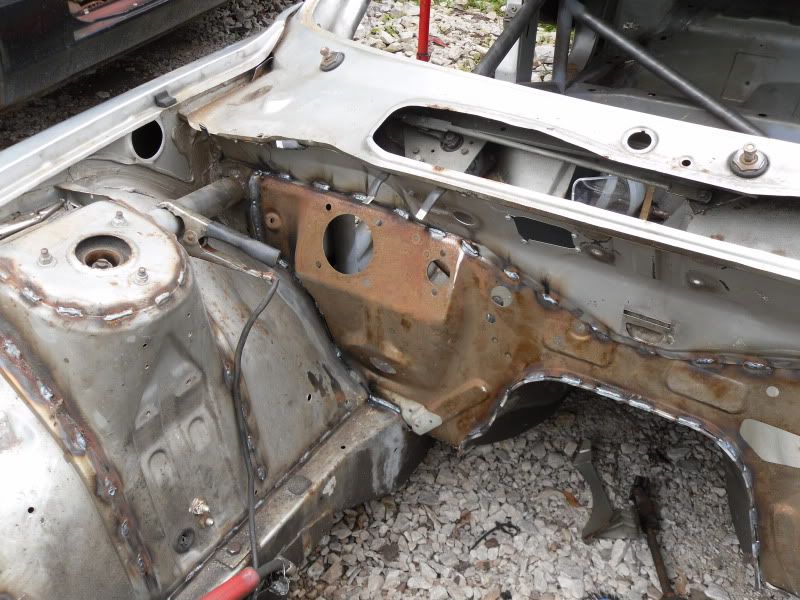

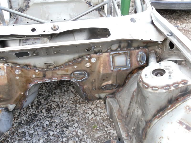

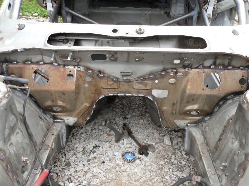

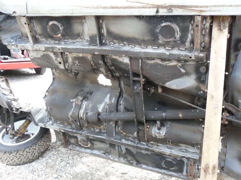

                              Update guys, been very busy, holes in bulkhead welded.............
                              Note that I have also welded the holes for the heater pipes, that won't be returning!

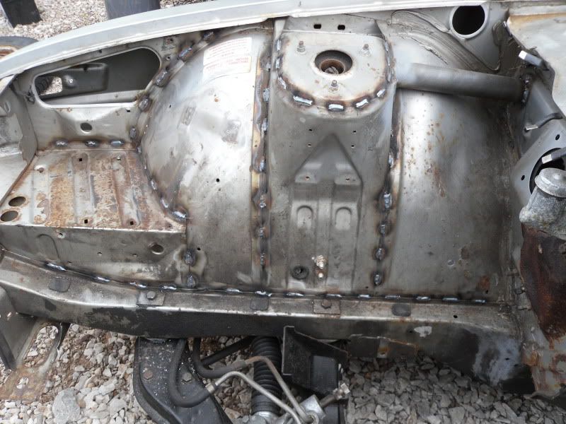

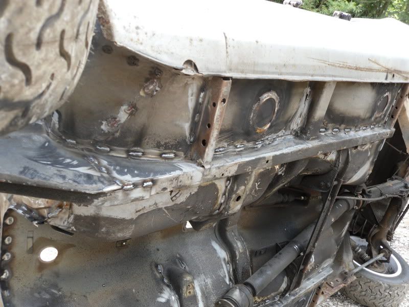

                              More seam welding..........

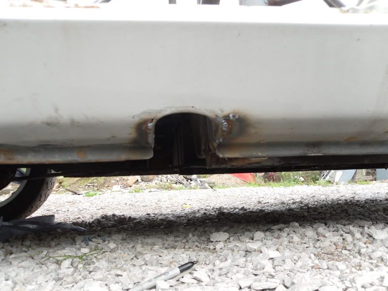

                              Anyone like to guess where the exhaust may be exiting from?..........
                              Right here...........

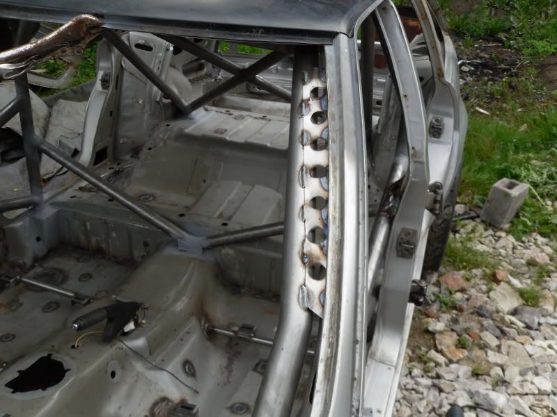

                              Note that the welding isn't finished, tis was the point where me gas ran out!

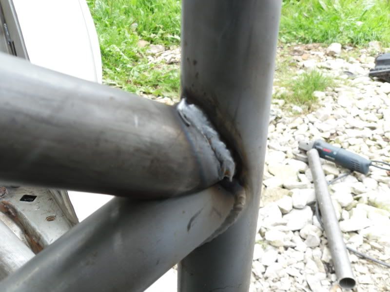

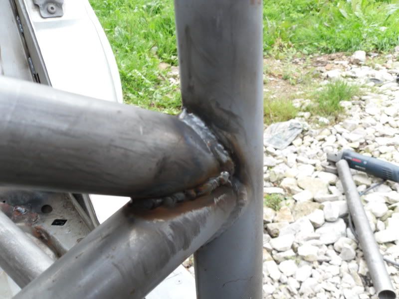

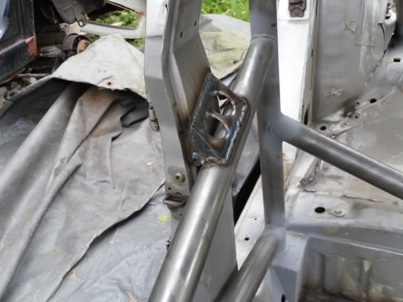

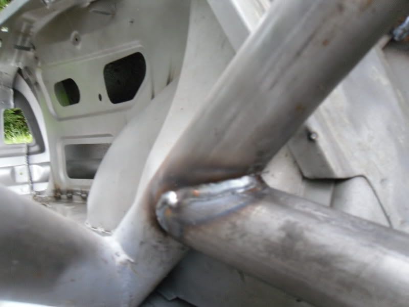

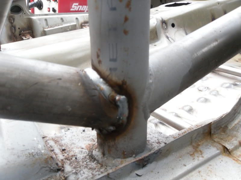

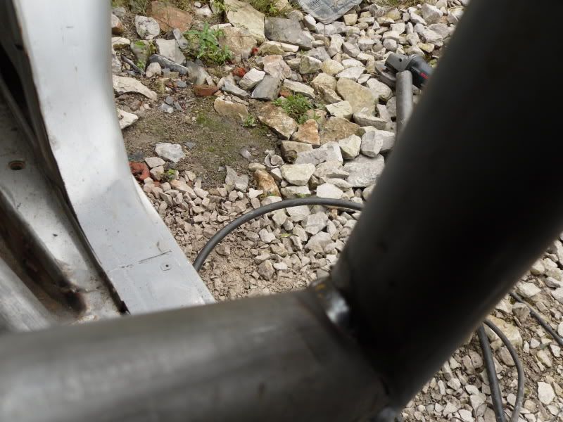

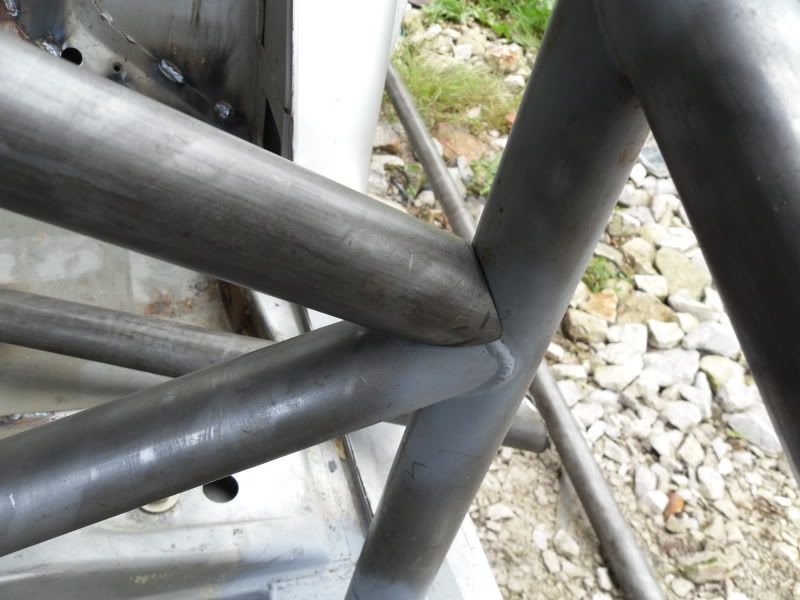

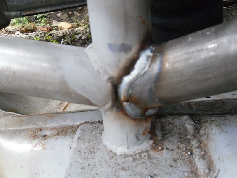

                              Some bits of extra cage that I wanted to add, I should have asked the cage guy to do it, but it was too late when I picked her up......
                              Tacked in place..........
                              Welded.....
                              Another few bits............
                              Now i'm happy.........

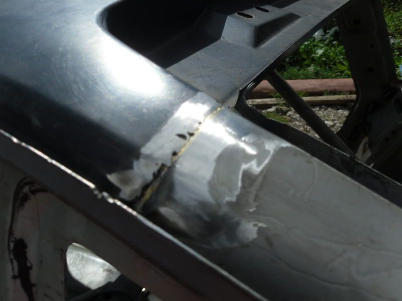

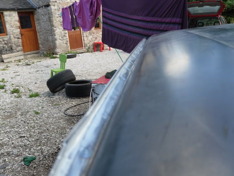

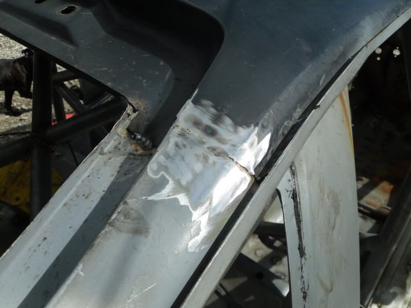

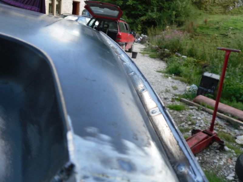

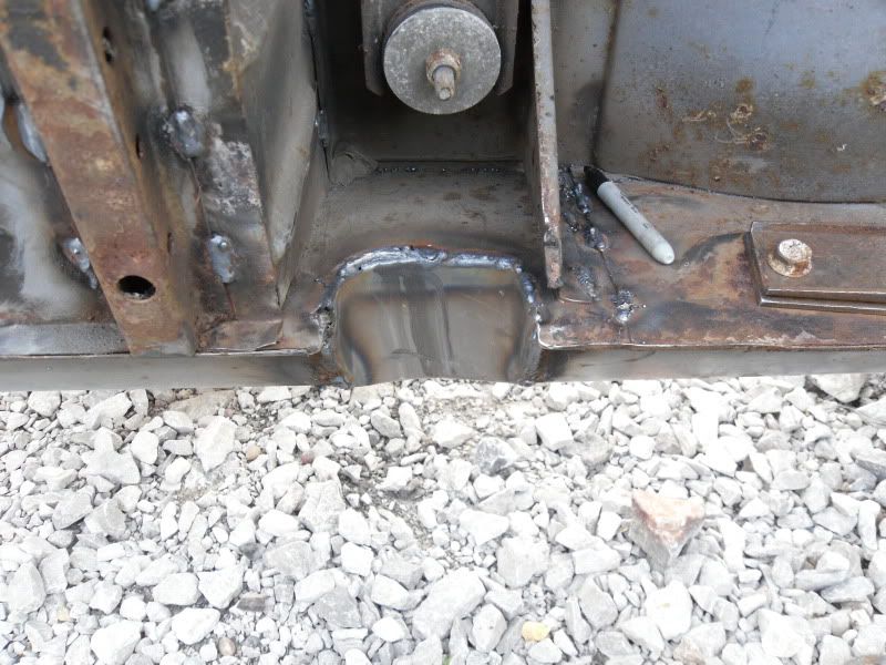

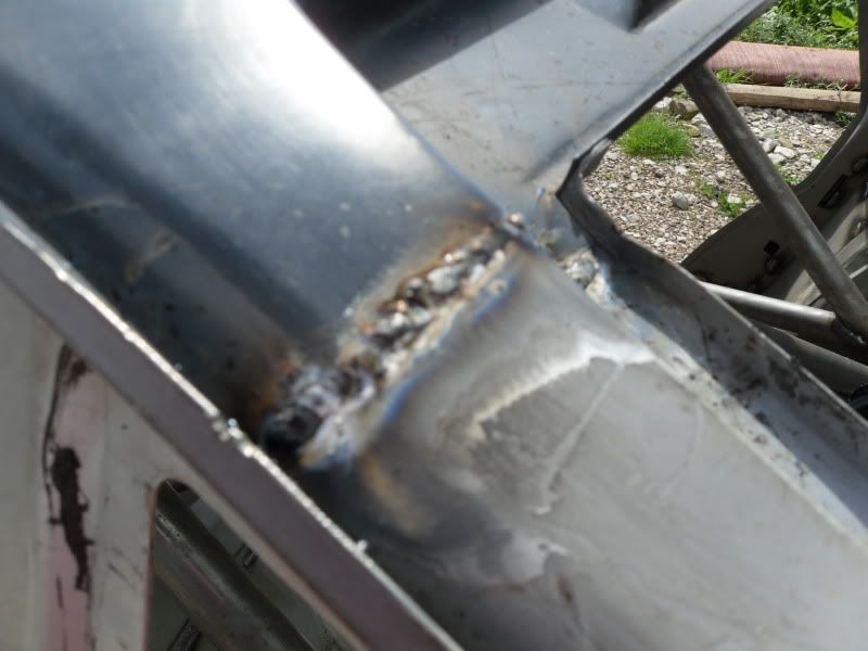

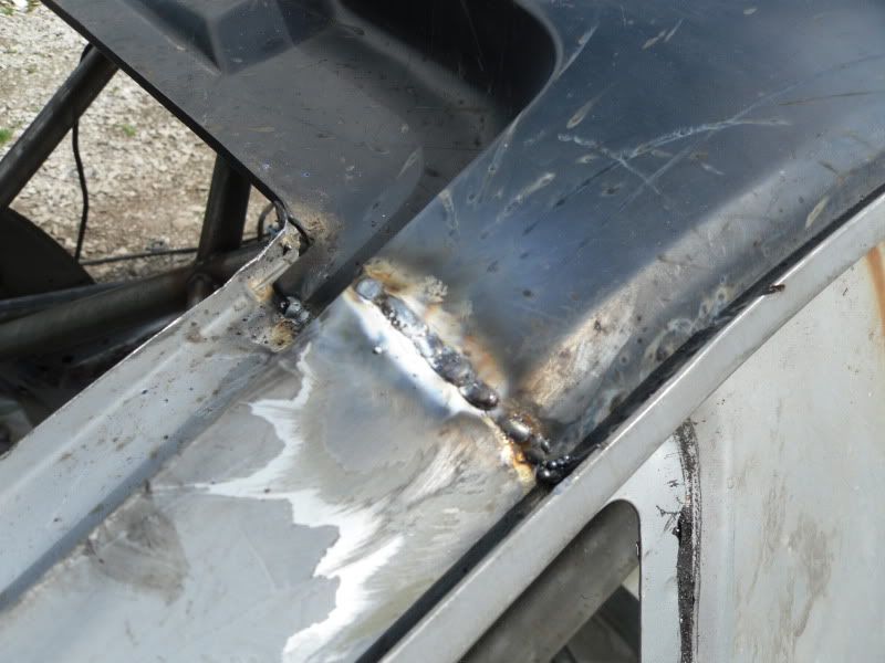

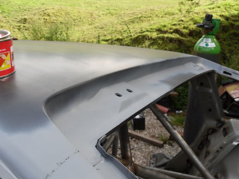

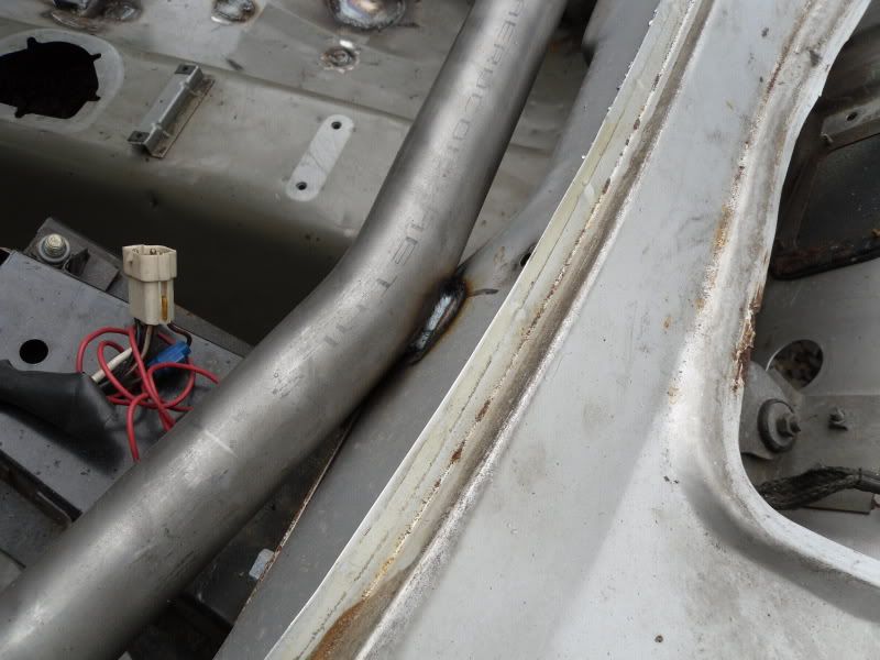

                              The welding here is crap, the problem is, at the factory, this joint is Braized, well I don't have the facility to re-braize it, so I have welded it, but because of the impurities, the weld looks awful, nothing some of Isopon's finest won't sort out.......
                              Dressed up, ready to fill over........

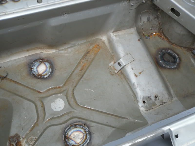

                              Spot welds........
                              Little bead of sealer.......
                              Coat of Grey primer to protect till next weeked when I hope to get some proper primer on......

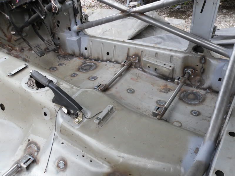

                              Handbrake plate............
                              Pedal box strengthener..........

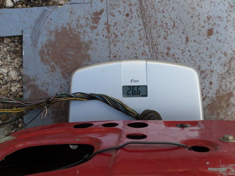

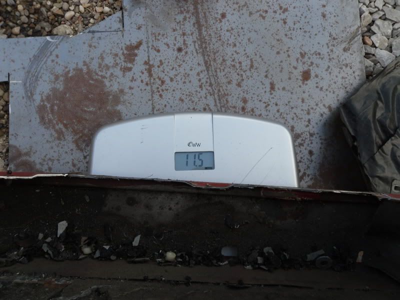

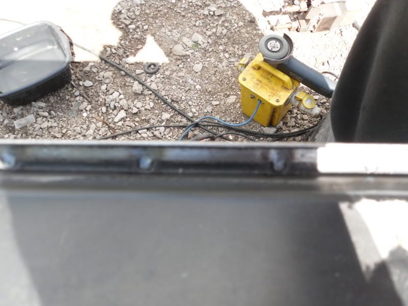

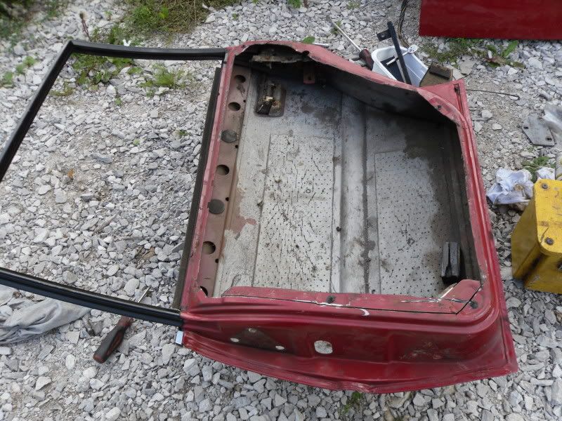

                              I then found myself with a bit of time, so started on the doors, I weighed them first, WOW,..........
                              Front door, a colossal 26kgs!
                              Rear door, 18kgs!
                              Those of a nervous disposition, turn away now...........
                              down to 11kgs, more to come yet but polycarbonate wiow to go in so I reckon that will be final weight..
                              3 more to do, not today though.
