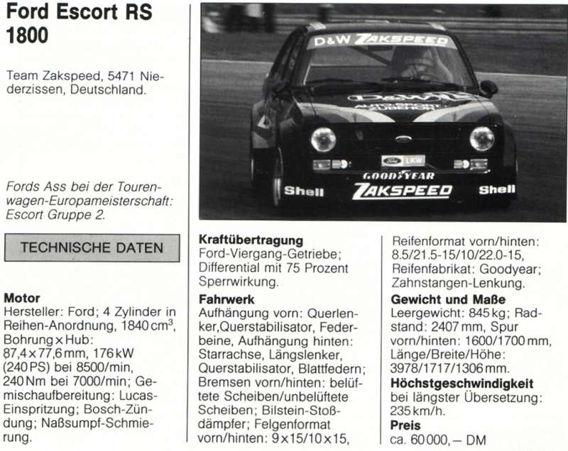

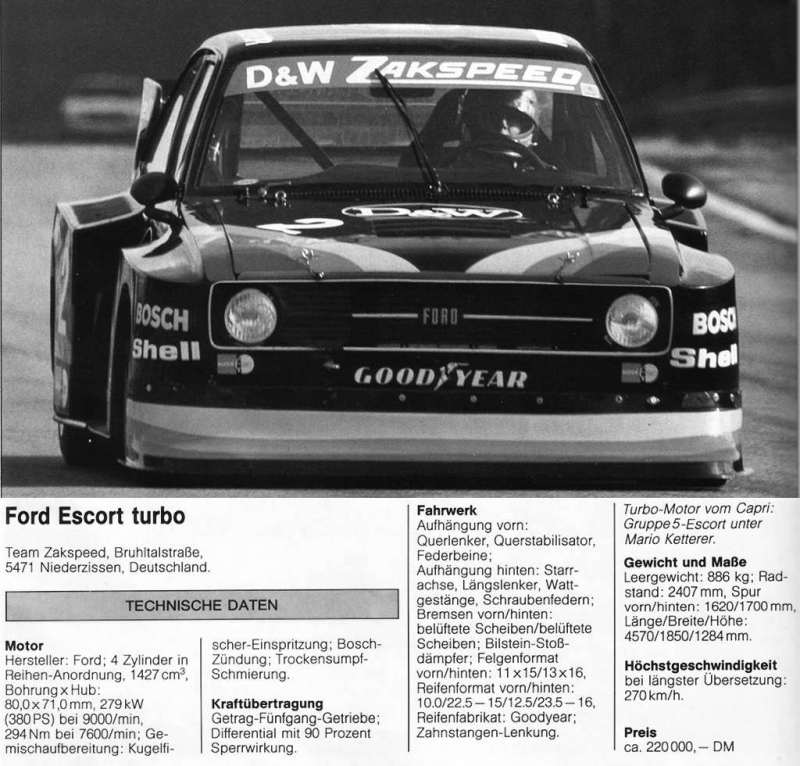

            How is your German Gary?
            Tech spec below
            Group 2
            Group 5

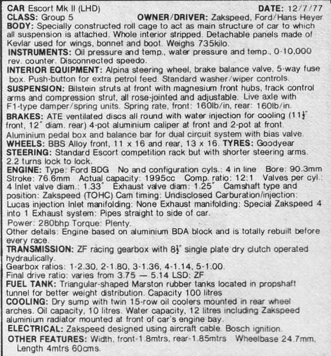

              Found this in a old CCC Mag
              Group 2
              Group 5

                Interesting ads. Notice the Grp 2 cars were running the spec I mentioned; no ZF box, single plate clutch (but dry-sumped), etc. (I recall that the FIA did relax the rules in the late 70s to allow dry sumps -Appendix J made quite a mess when it came out, and was subsequently modified).

                  Very interesting , I thought the GP5's used the 1700 turbo engines. But the german spec says the 1400's where in there keeping the cars in the under 2000cc class.
