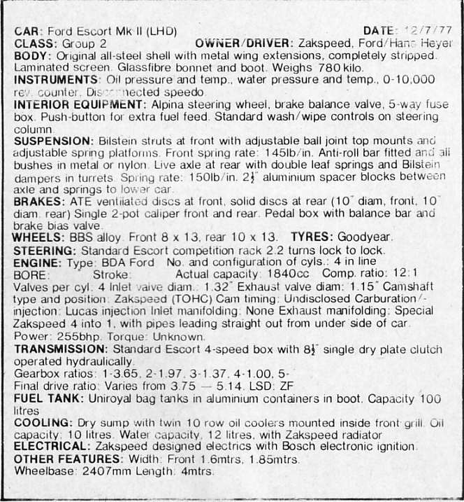

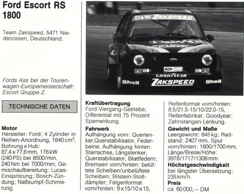

Mmmmmm. Interesting point this. The car is advertised as a Grp 2, but it has a dry sump, and a ZF 5 speed box, both which, under Appendix J Grp 2 regulations, would make it group 4. I must admit I'm not sure - could depend when the car was built.
If its a Zakspeed car then thats a GP2 car, GP4's had the boxes
