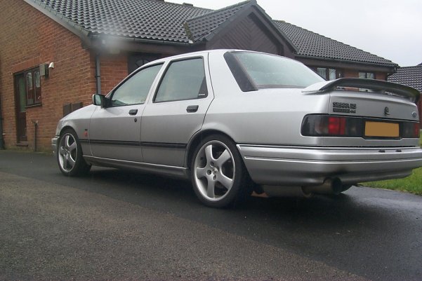

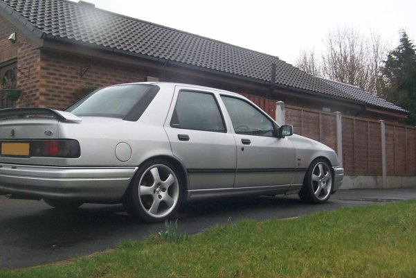

    Here's a pic of the cossie with its old 17" OZ Polaris alloys.......

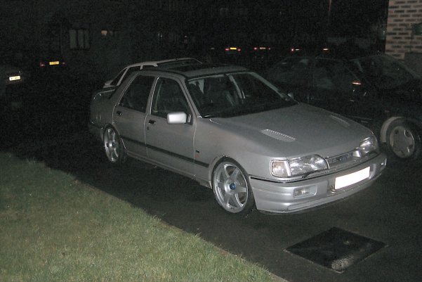

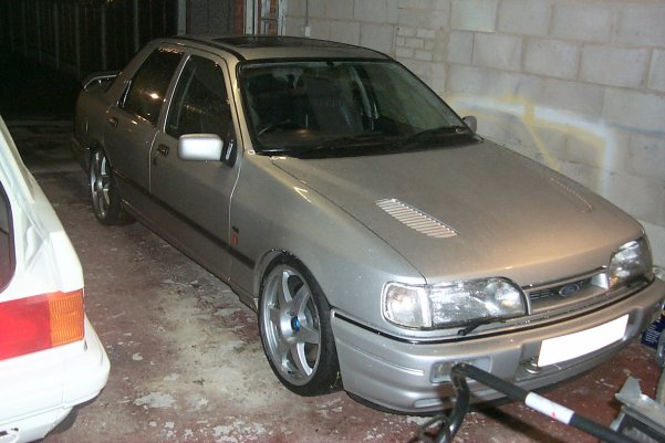

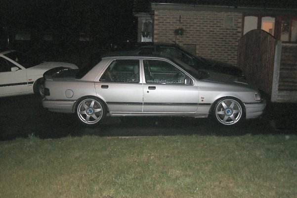

    And here it is with its nice shiny new 8x18" Compomotive MO alloys with Eagle F1 225/35/18 tyres

    I like them much better than the Polaris rims m8. Make it look a lot tougher.

      It looks even better in the metal too
      Pictures dont do it as much justice as in real life
      The Compomotives where purchased to go over the AP's as the Polaris needed 10mm spacers......

          Good choice Daz,look the nuts.

                The reason why the MO's where chosen is because of the AP 330's.....with a standard offset and 8x18" they fitted straight on using 225/35/18 rubber with about 10mm between the wheel and the shocker......if he had used 40 series profile rubber then it would have caught on the arches.......the rubber was hard to fit to the tyres taking 3 people to fit each tyre and 1/2 hour to do 2 wheels and there was a set of 5......best part of £1600 as well
                I would expect the Speedlines to fit straight on as they are a motorsport wheel as well...

                  Looks much better.

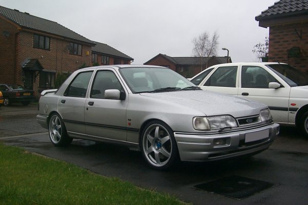

                      Heres some daytime pics but due to the weather there not much better than the night time piccies

                        Yeah i like them m8 they look the Mutts
