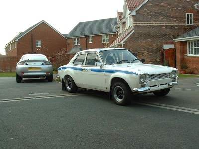

    Sad I know but I spent ages getting the carbs balanced so here's how it sounds now. Still not fully set up but...
    It Liiiives!
    Also here's a pic of how the car looks now. New shocks go on this weekend to drop the front for tarmac type shenanigans

    Sound nice mate!
    yer never can fault the sound of twin carbs
    music to my ears
    Car looks well also

      Cheers Steve
      Gonna take it out for a shakedown this weekend so hopefully I'll get some footage of it on full chat - circa 8,500 rpm
      That's a serious beastie you've got there. Looks superb

            V. Nice, will look better when you get the tarmac springs on tho'
