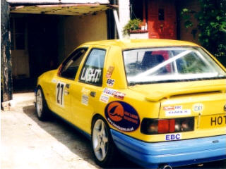

    Ok, took loads of fiddling as me and my pc dont get along but i got these to work.
    They should be Custardcosworth's cossie

    Looks the bollocks Fin, i bet it goes well

      wooohooo bud,the way to go!!!!!!!!!!!!!!!!
      don't u think "turbosport.co. uk" would look good down the sides ...mmmmmm about 12" high and 48" long wouldn't look to far out of place.......and in blue too?????
      free advertising for free stickers to cover up all the scratches down the sides
      cheers again chunk
      fin

          and big F### off touring car,sun strips!!!!!!
          half way down the screen!!!!!!!
          in blue with yella writing,i'll have 5,with amount of screens i go thru!!!!!!!!!!!!!!

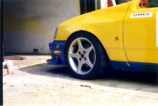

            Re: The custardcosworth pics
            got a few more for you:
            i think it is a go?

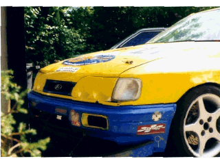

                    STICKERS!!!!!!!!
                      Tech spec. custard, we like the tech stuff, u got a site? where/what do you use it for? looks like it works wateva u have, functional. more pics! some one get this man some stickers damn it!!!!

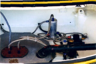

                        hoped to have some more for u today........let down with trailer ...so many things to test ,check ,break
                        ah well,looks like i'm gonna have to take it careful on its first day out,28th @ goodwood.
                        anyway a bit on spec

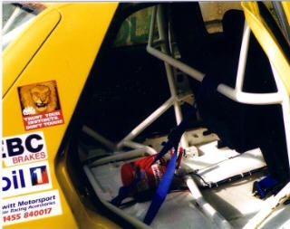

                        shell:-
                        motorsport shell without sunroof
                        fully seam welded
                        strengthened gear box tunnel & foot wells
                        reinforced chasis legs and tyre well
                        reinforced rear turrets
                        reinforced front turrets
                        12 point welded in cage,triangulated to front turrets and intergral strut brace
                        interior:-
                        nothing!!everything removed even the handbrake
                        door inners cut out front & rear/perspex windows,front with sliders
                        reinforced firewall to seperate fuel cell from cabin.
                        6 point buckets(now out of date)
                        6 point harness
                        passnger foot rest (purely for comfort!)
                        drivers foot rest
                        handheld fire eater in passenegers footwell
                        plumbed in fire exstiguisher,driver and exterior cut offs
                        battery master shut off ,driver and exterior cut offs
                        digital dash with datalogger
                        complete rewire,everything not necessary removed...all remaining electrics wired thru shut off and all with independent relays.
                        carbon fibre centre consol(where vents were)
                        with switch panel
                        start/stop/run switch
                        indicators
                        ecu
                        dash
                        3 fuel pumps(we'll get to that later)
                        fans
                        wash/wipe and an aux switch.....which will be for a water injection system(that i'm gonna make for £40!!!!!!!)
                        boost bleed valve
                        break bias knob
                        omex rev limiter
                        omex sequential shift light(this is so cool!)
                        boot:-
                        fia approved bag tank
                        2ltr swirl pot
                        main fuel pump(standard at mo)
                        twin facet fuel pumps to prime swirl pot
                        all -6 areoquip
                        rear:-
                        2.25 adj bilstein rose jointed coil overs
                        strengened rear beam,all rose jointed,with solid diff mount
                        fully adjustable arms with rose joints
                        no rear arb
                        no bushes...solid mount to rear frame

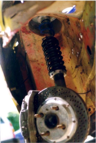

                        front:-
                        2.25 adj bilstein coil overs
                        concentric top mounts
                        adj compression stuts
                        adj track control arms
                        adj drop link arb attached to chasis just behind the rad
                        no bushes
                        brakes:-
                        rear standard apart from mintex M1444 if i rememmber rightly
                        front ap 4 pots with 300mm X 28mm discs and bells same pad as above.
                        areoquip -3 thruout
                        brake bias adjuastable pedal box with .70 on rear and .625 on the front.this was a to fit
                        diff/gear box are both standard,though i've got "thicker" drive shafts....what ever that means!

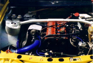

                        engine
                        (here we go....i was dreading this bit....but saying that if u've got this far my hat comes off to u!!!!!)
                        H T Racing engine complete rebluid as follows
                        head and cams are standard
                        wire rung block with standard gasket
                        Mahle 4X4 pistons.comp at 7.2:-1 with valve cut outs
                        fully lightened and balanced
                        pistons,rods,crank,flywheel and clutch
                        grp A bolts through out
                        high pressure oil pump....shows 60psi at idle!!!!!!!!
                        big wing sump,with fabricated baffles approx 9ltr capacity
                        twin plate,6 paddle clutch (this is a monster)
                        oil cooler,seperator and external catch tank with take off to atmos
                        swirl pot,cone etc etc
                        dark greens,stage 3 chip,3 bar etc etc
                        4wd turbo with 360 bearing
                        3" system scorpion with 3" tail(try to keep it as quite as poss)
                        i think thats it!!!!!!!!
                        oh yeah standard gl sierra rack...saves 20 kgs over the normal rack an d allegdedly 5% extra horses!!!
                        oh yeah....filling cabinet door front splitter,it adds 10 kgs but it looks damned silly!!!!!!!!
                        touch wood every thing is go for monday.....
                        engine not run in,so will be taking it easy
                        untested gear box/diff/engine and brakes
                        anyone want to buy it???
                        comes with 6 spare wheels and 10 slicks
                        custard
