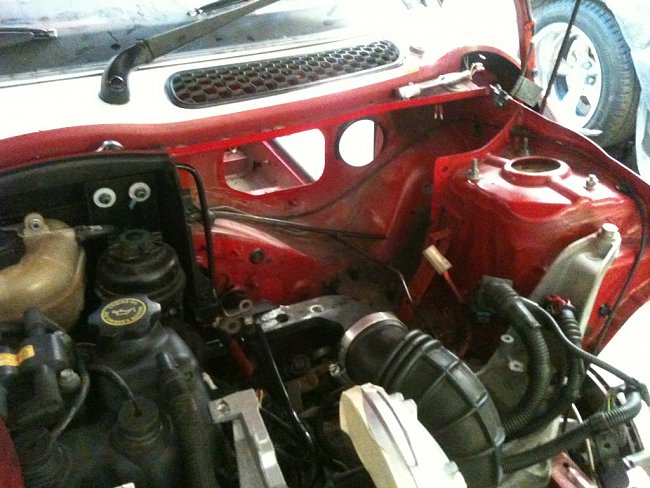

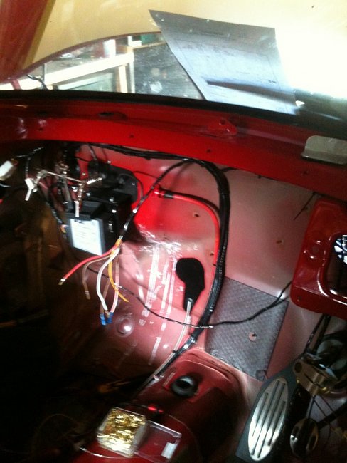

    The reason for lack of updates on mine and David Whites car, is that during the off season we have been doing a little upgrade on a friend of ours race car.
    It's gone from this
    Sent from my iPad using Tapatalk
      Ended up here
        And started to look like this
ID:	1997516Click image for larger version
ID:	1997518Click image for larger version
ID:	1997522Click image for larger version
          Re: Ex Mini Challenge R53 Cooper S

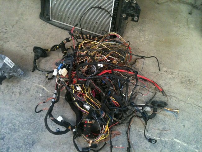

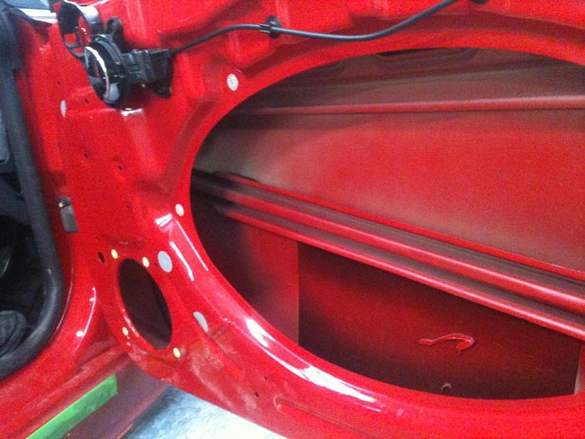

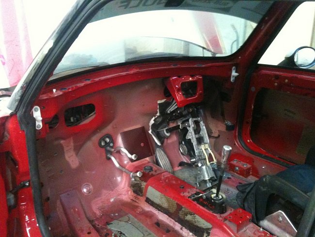

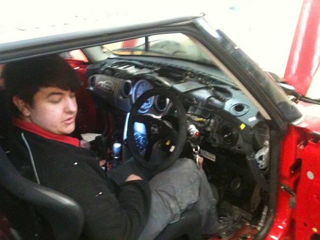

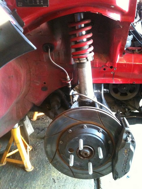

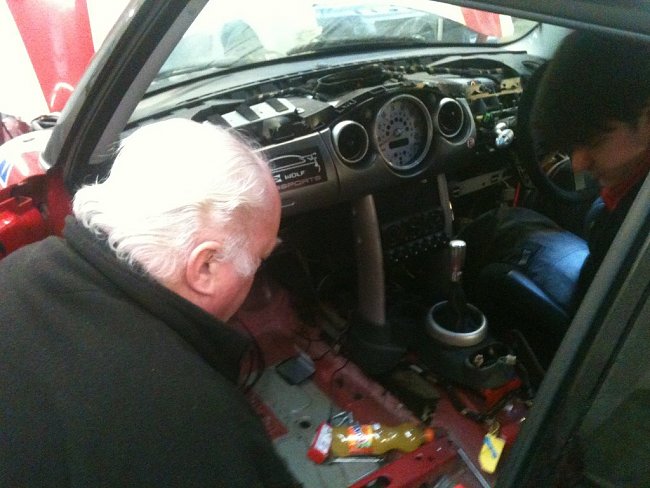

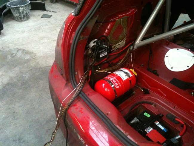

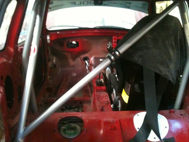

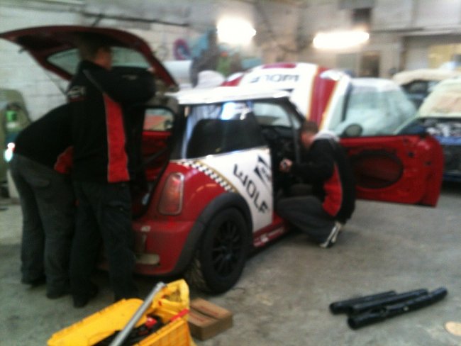

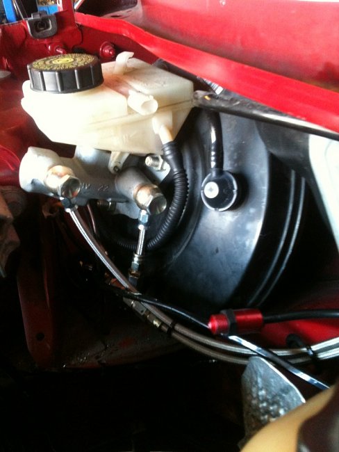

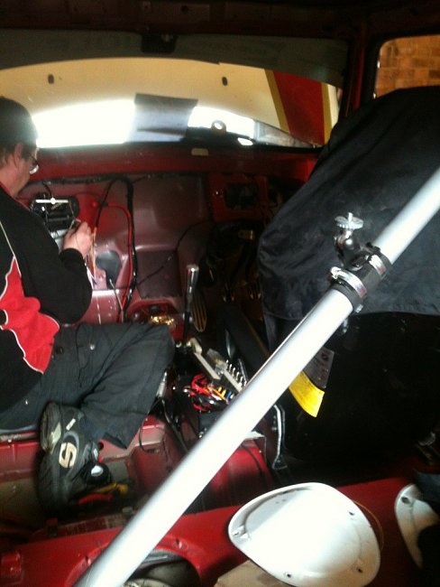

          To get the weight down, Perspex has been installed all round, the complete dash removed, the extinguisher repositioned for better weight distribution, a smaller battery installed, the existing wiring loom removed and a new one installed.
          The exting control units have been removed which meant all the abs is now redundant. This then meant re plumbing all the brakes, with an inline pro portioning valve to the rears.
          The engine is now controlled via a DTA S40, but the biggest headache for me was the fly by wire throttle set up, but Allan at DTA came to the rescue. To remove more weight , we have even removed all of the complete dash set up.
          We are hoping to have the car ready for the 1st race of the season at Brands on the 24th March
