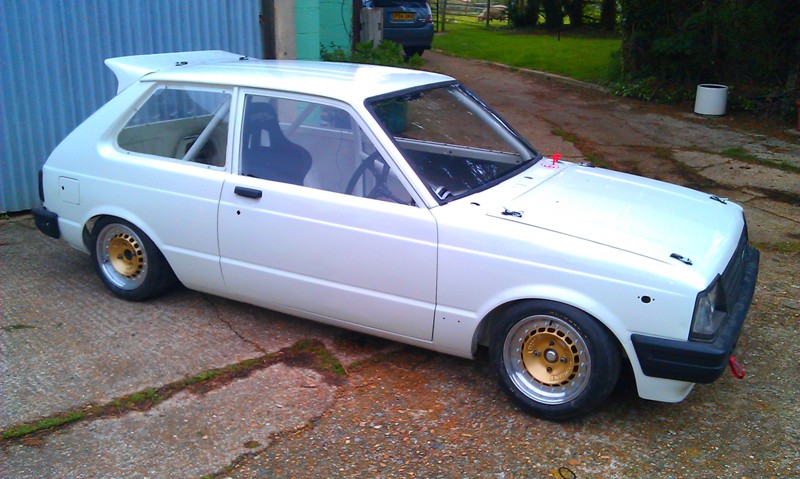

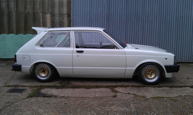

    Now its getting close to being finished i thought i would post some pics of my starlet.
    I bought it a couple of years ago as a slightly rusty rolling shell, that had sat in a barn for years, with the intention of a quick basic build to get me out racing. As with most projects it has taken far longer than it was supposed to. I was hoping to be out for the start of this season but should be ready soon. The plan is to do some QMN meetings and maybe some SEMSEC meetings down at Lydden depending on how the non existent budget goes!

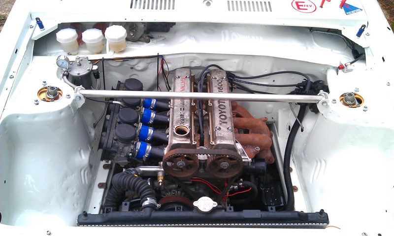

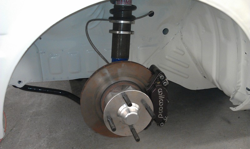

    It has a standard 4age at the moment so wont be that powerful but is fairly light so that should help. It has an english axle on gaz coilovers and Leda cortina legs up front as they almost bolt straight onto starlet steering arms.
    I still have a list of jobs to finish, like tidying the wiring and actually getting it running, but its getting shorter.
    Hope you like it!

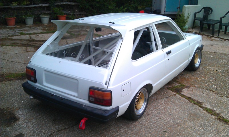

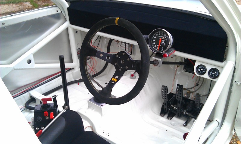

              Very Nice i look forward to racing you soon ,i will be interested how you get on with the pedal box ,i have been thinking of getting something similar is it an OBP one?im not sure you will be allowed the rear spoiler in the QMN though

                I did consider engine options when i started building the car but even on big carbs a 4k would prob only be 120bhp. i dont think that would have kept up with your crossflow!
                I realise im gonna be bumped up a couple of classes because of the engine but if the rest of the car is good this year i will probably build an engine over the winter. I think 180bhp is fairly realistic from a basic build so that would give me a bit more of a chance.
                The top mounts were an ebay bargain. I had to buy the unidentified struts they were on but for a tenner it was worth the risk.
                  I cant wait to get out there!
                  The pedal box is from Compbrake. It was an easier option than trying to wedge an escort bias box in there. Ive not used one before and its taken a little bit of fiddling to get it to work properly but feels ok now.
                  The rear spoiler was available as a TRD option from your toyota dealer in 1984 so should be ok to use in QMN
                      Really (rushes to get the Irmscher options for the nova)

                          Sorry but I think you'll find that it has to be factory fitted, there were some problems with the Seats over similar spoilers a few years ago.
                            • 25249
                            Re: Toyota Starlet kp60 race car
                            nicks right unless that spoiler was a factory fit option for the starlet the scruts will chuck it out or put you in class A
                            Classes B, C, D and E Spoiler may not be higher than 50% of the height of rear window, unless the
                            spoiler fitted is an original production part as fitted on the production line when the vehicle type was
                            originally manufactured
