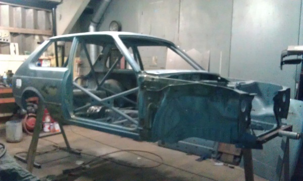

    Very nice car I should have mine finished soon (also 4AGE) Im thinking of entering the Toyota sprint series next year maybe worth a look for you as well.
    Heres a couple of pics of mine build thread on here somwhere.

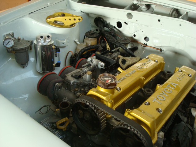

      Cracking car mate, i love the RDS kit. Ive been following your build thread with interest as its so similar to mine. Im looking forward to seeing some action photos.

            The ali hubs are from rally design so a good cheap weight saving.
            I bought the calipers from a guy who had used them on a radical race car. The fronts are spot on but the rears are also 4 pots so will be a bit of an overkill. i used them because they are lighter than the fiesta calipers i have on my escort so hopefully i will just dial them out on the bias box and proportioning valve.

                    Im running AP Princess 4 pots up front and cosworth rears manual bias adjuster (standard pedal box for now) but a like the idea of sheding more whieght.

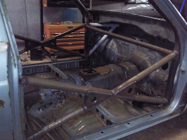

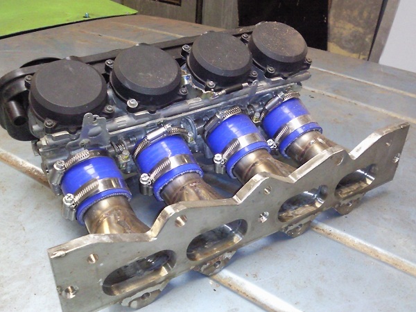

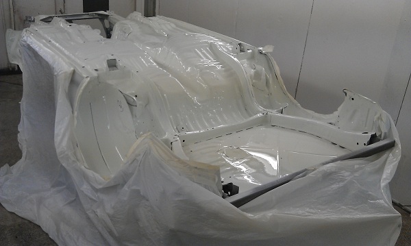

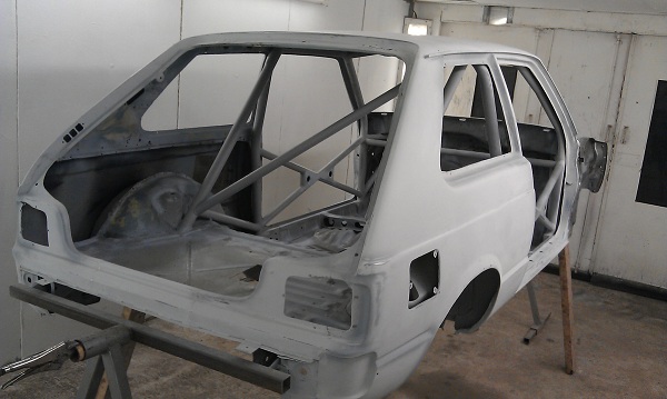

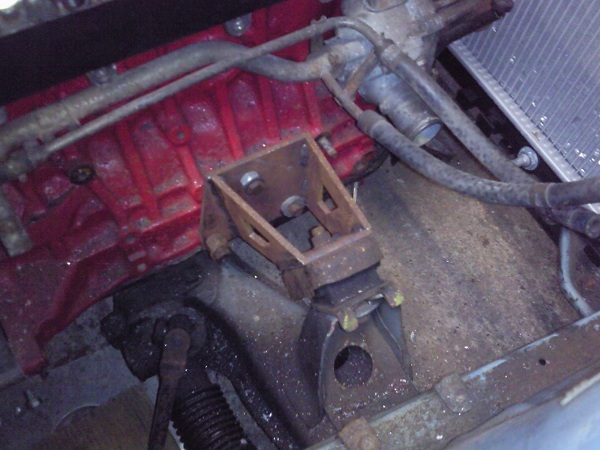

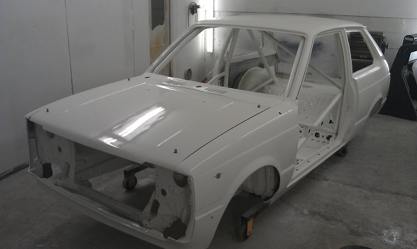

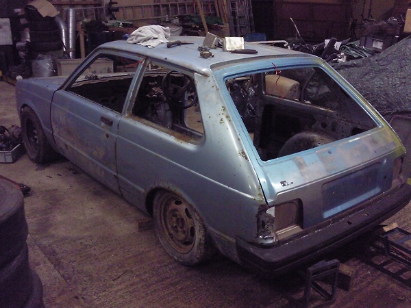

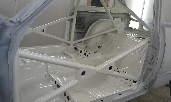

                            I never got round to doing a build thread but these are a few pics i took during the build.
