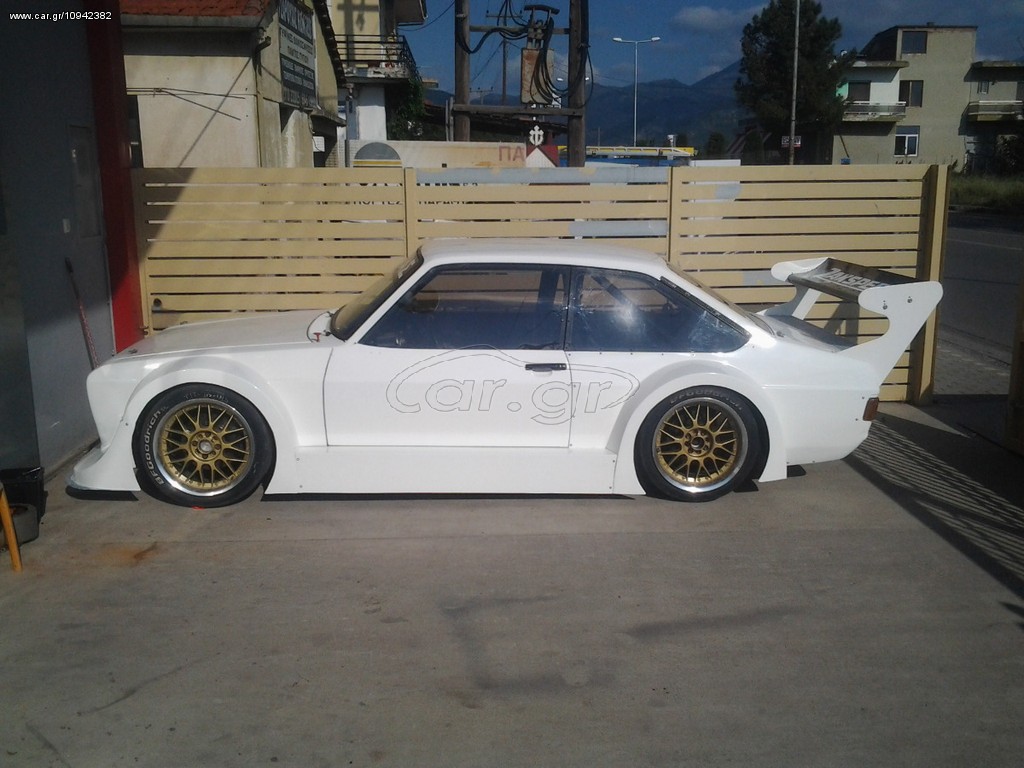

          Nice work. The one above is for sale in Greece.

            Absolutely a Nice car TimGR, any more pictures or info, have this one been red whit an BMW M5 engine?

              Not the red one, I know that too, a real beast. The white one is a Cosworth. Advert here in full:

                  Thanks TimGr, love the wheel arches on this one 👍🏻
