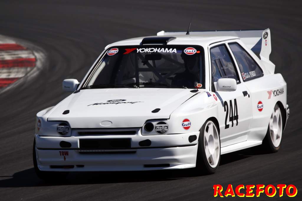

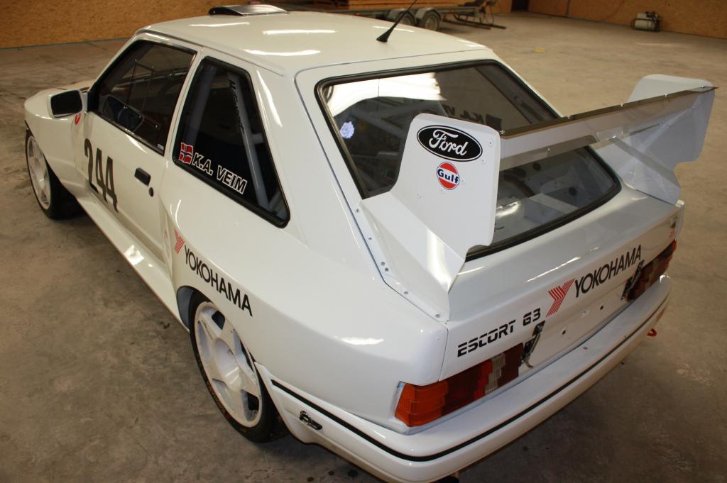

      The care is always under construction, and have been tested some times, i finished 7 th of 14 in my first race whit bad brakes and a gear box that jumped out off 3 rd gear so, i was quite happy whit that, the next race i only had problems whit the engine so it now needs an complete look over.
      I had the car on corner weighting before the first race, and i was sure that the car had gained some weight, and tougth it had to be at least 1100 kg, but it was only 965 kg, but i had to put inn 78 kg off weight, since the minimum weigth off my car inn my clas had to be 1120 kg whit me inn it acros the finish line.
      The first test of the new built car.
      Running on slicks and to smal master pump on the front brakes.
      Here you can se some race picks when the car is in action on VĂ¥ler and Rudskogen Race tracks.

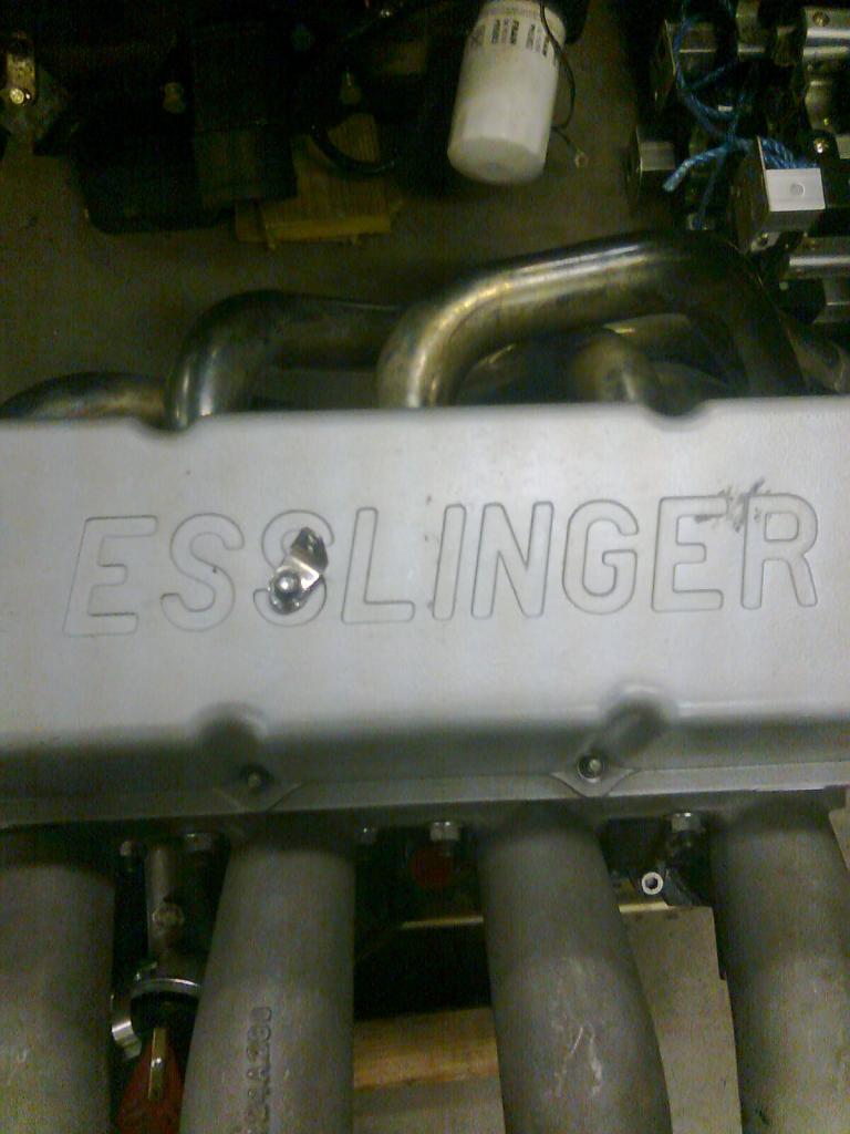

        Not to much have been done here recently. Due to engine failure there hve not been much joy.

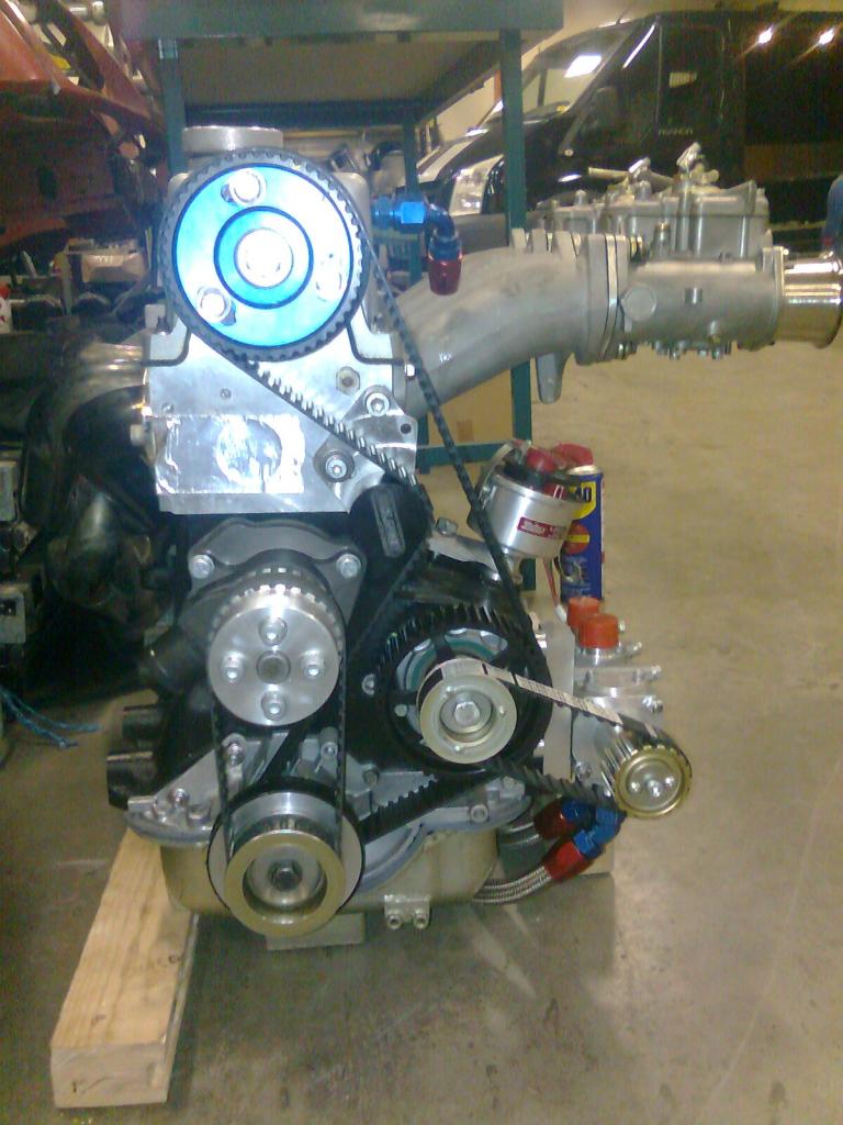

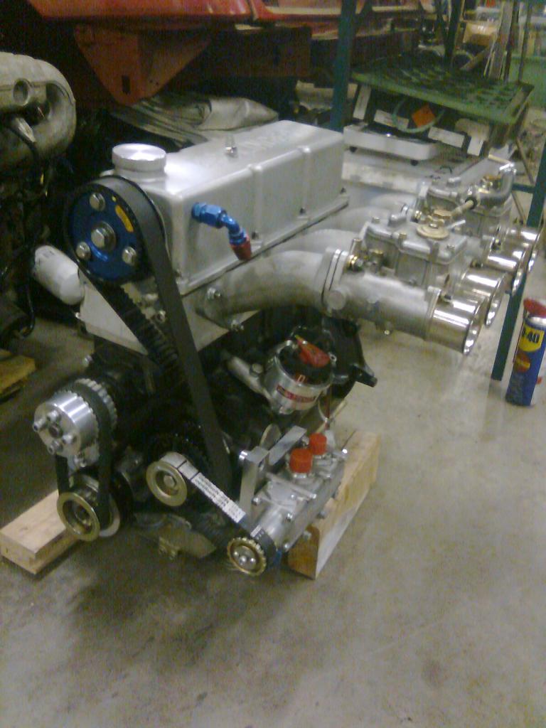

        But things are now locking a bit brigther for 2014, i have bougth an new engine from Ringspeed, 2,5 Us pinto, and an new gear box quaife 60G. so hopefully i will get some more time behind the stering wheel next year.
        The new engine
        So for this winther its al abaut making this new engine and box fit into the car, and some oter modifications to make it bether

                Cant wait to try out the new engine, sounded great on 50 s

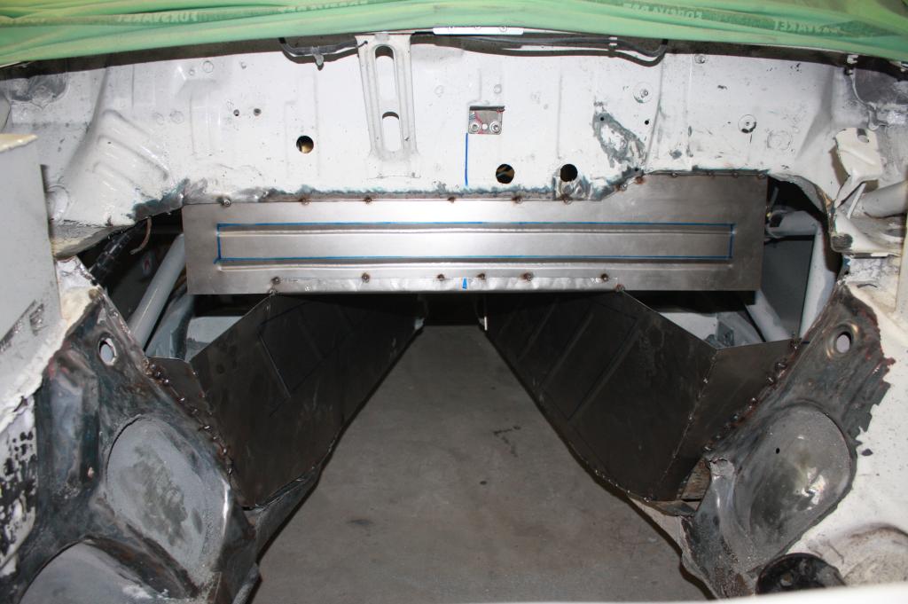

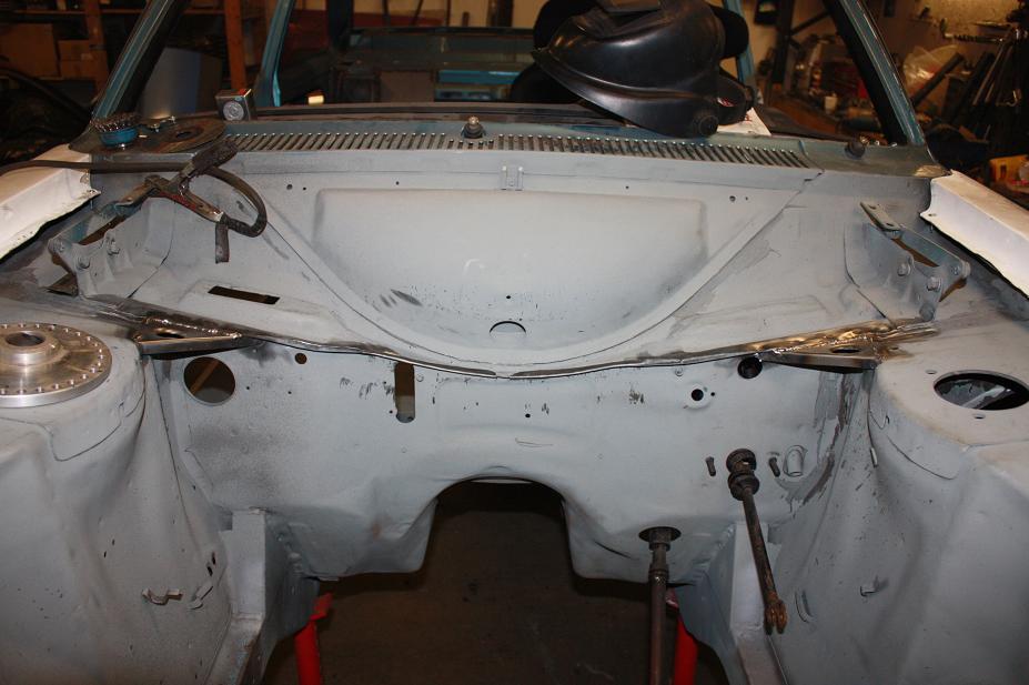

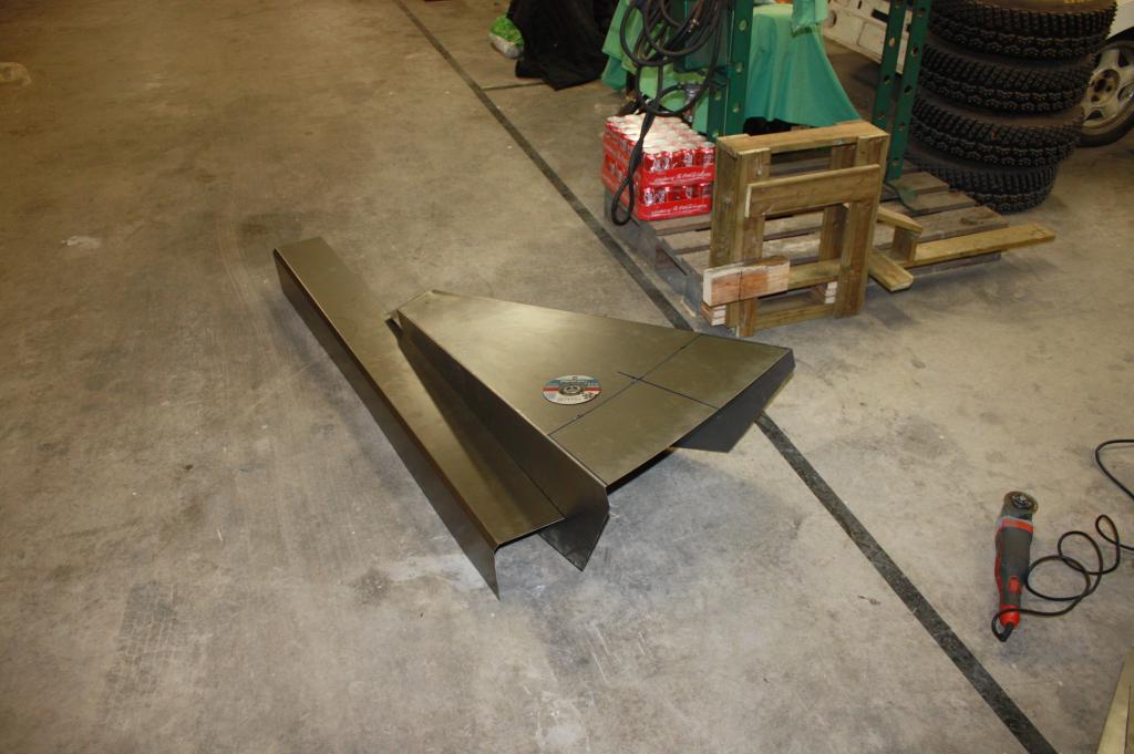

                  A litle update.

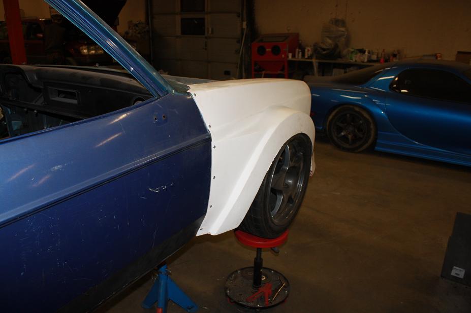

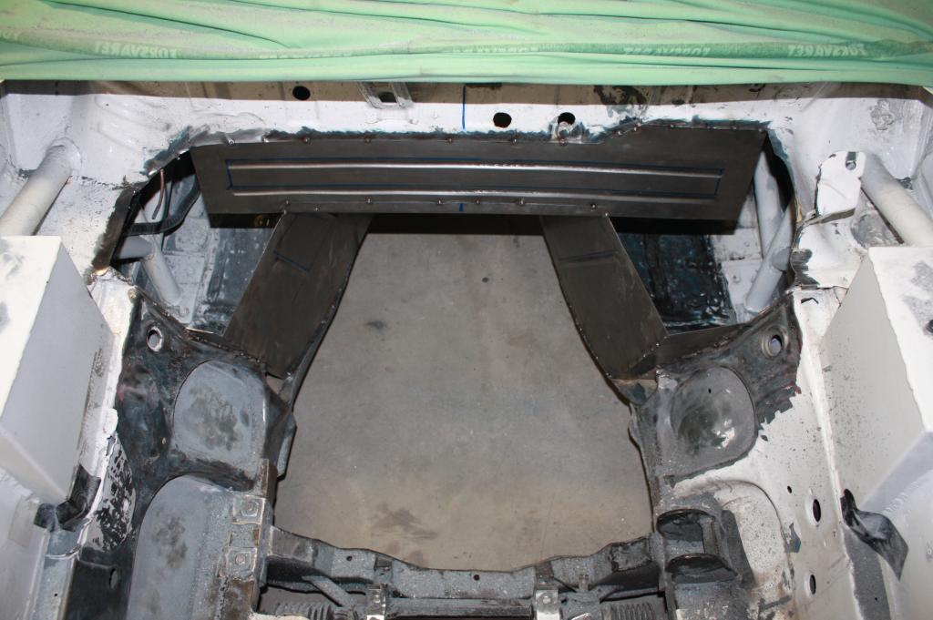

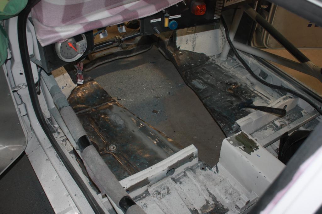

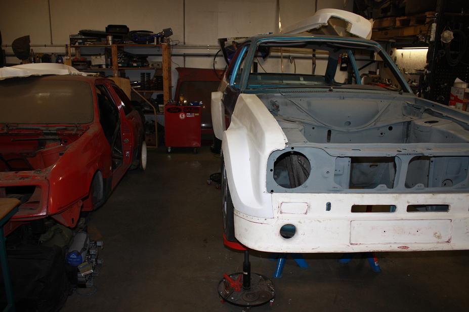

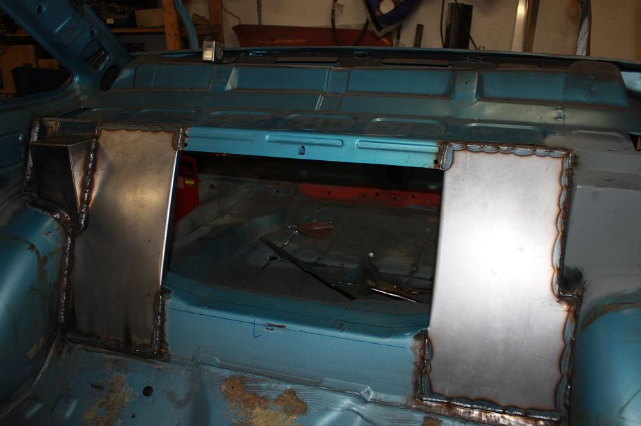

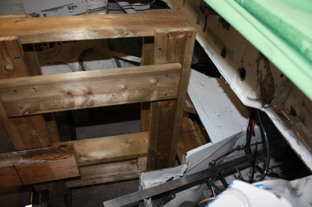

                  Been busy making rom for the new engine.

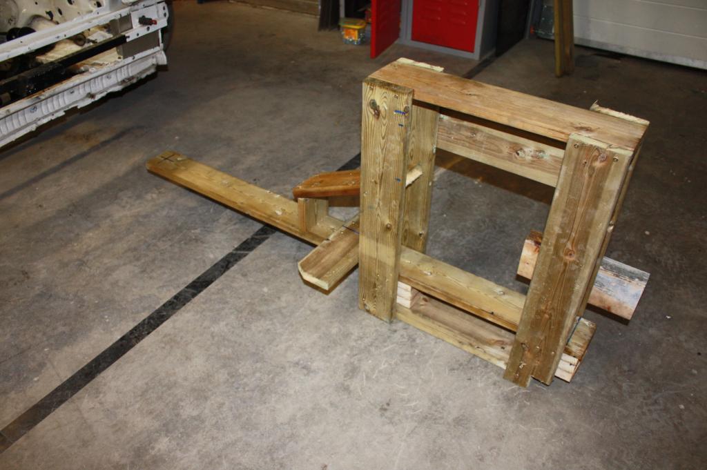

                  Made an dummy engine for the jobb, since it will be going inn and out a lot.

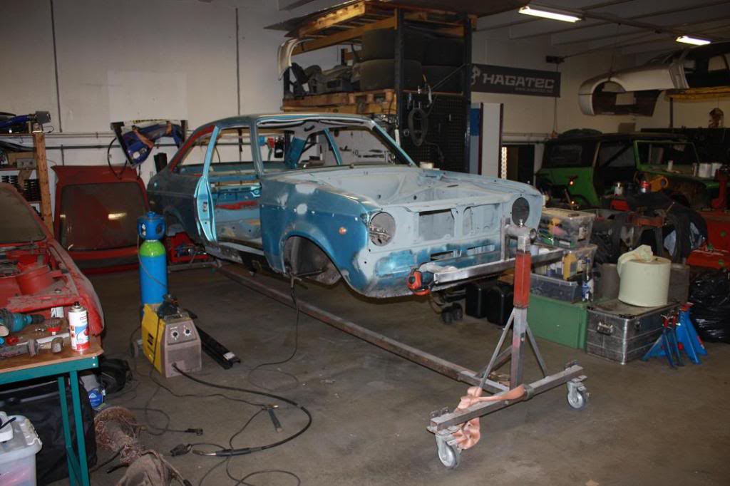

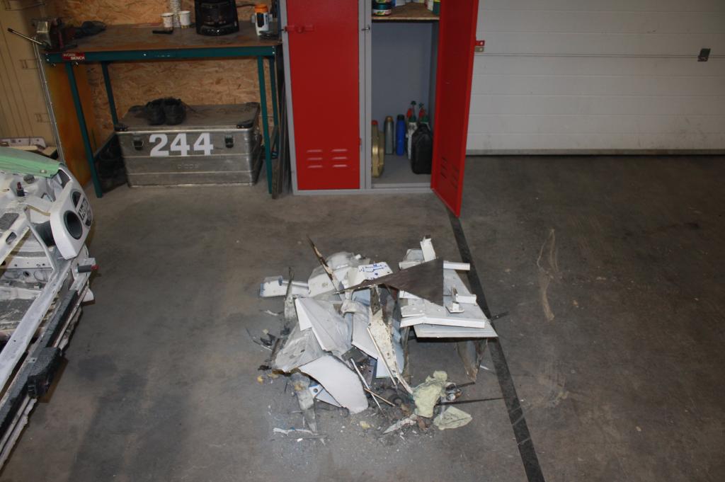

                  Cuted away a lot of old steel
                  made up an new gear tunell and exhaust tunell
                  And have started velding it into place
                  Still a lot to do, but hopefully i will be finished before 2014, whit the gear box tunell and exhaust tunell. (i hope)

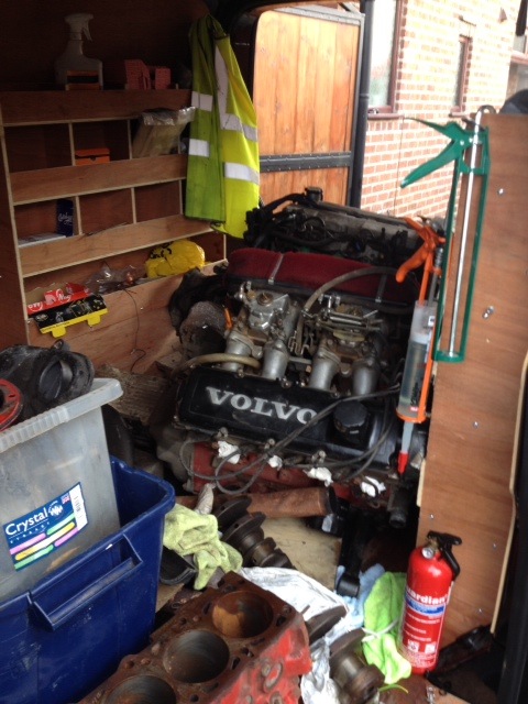

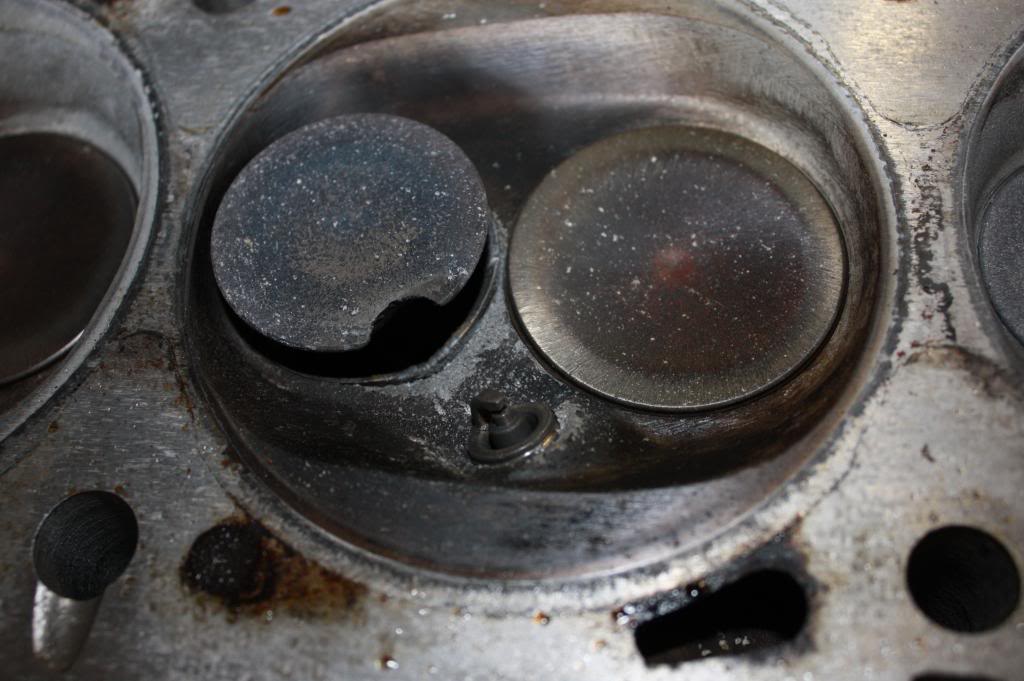

                      Hi there

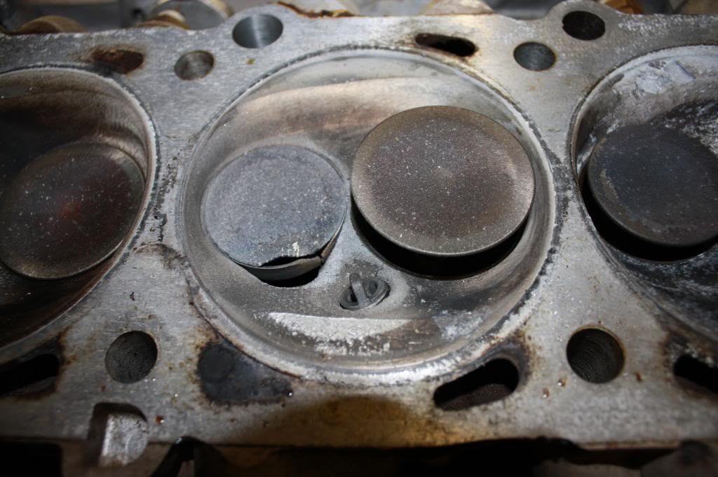

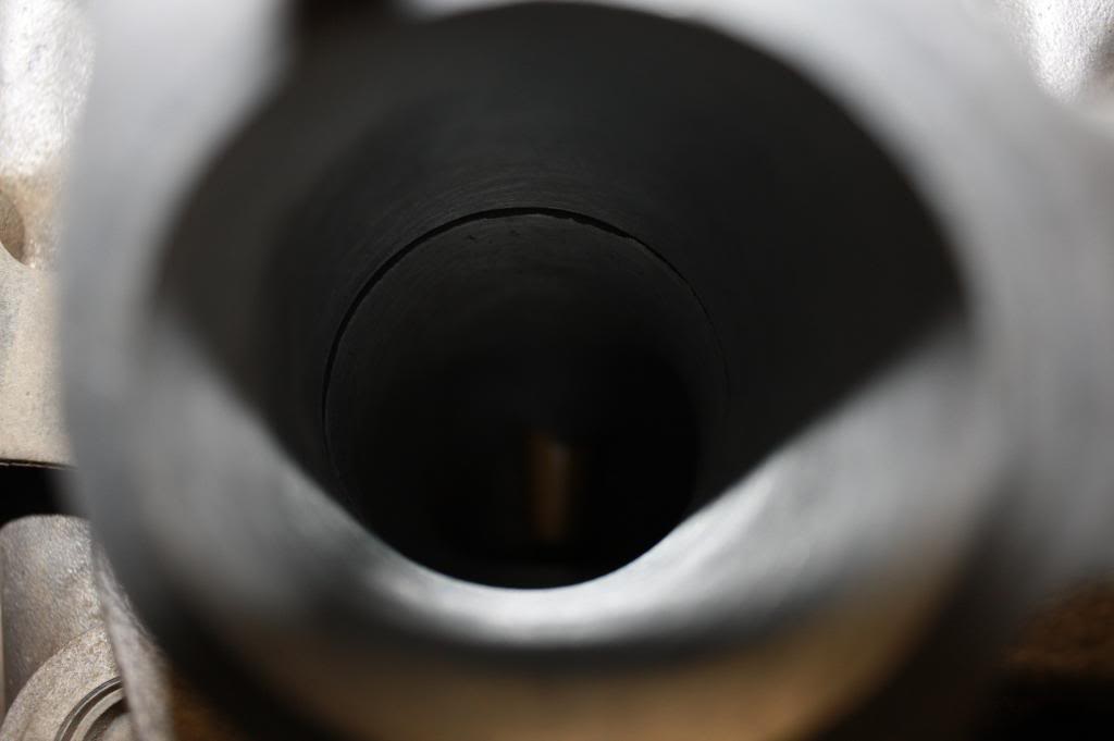

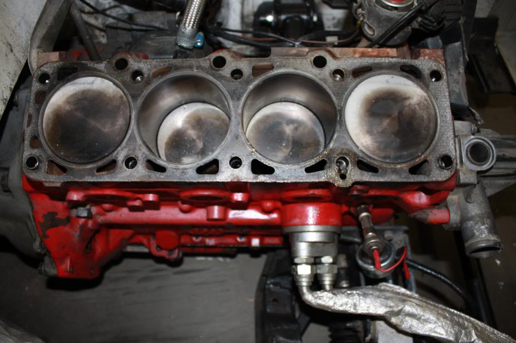

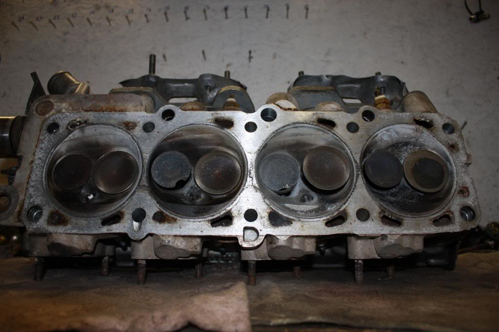

                      It was an 531 head, built in Sweden by Bengans racing.
                      The head was badly damaged due to a sick fuel pump and a water pump that lost the belt.
                      Sold the Volvo engine i August.
                      It was a great engine when it was working!
                      Some pictures of the damages.

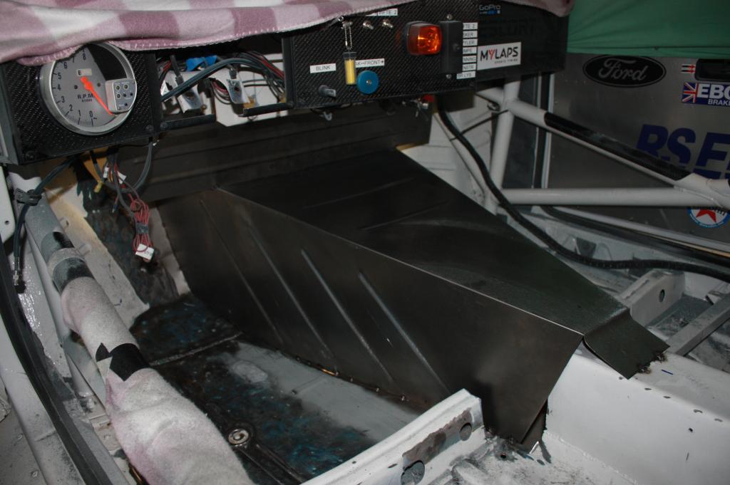

                                Been busy in the workshoop lately. almost finished whit the new tunnel.
                                Some picks.
                                Also got the new gear box for christemas
                                Tight fit for the manifold
