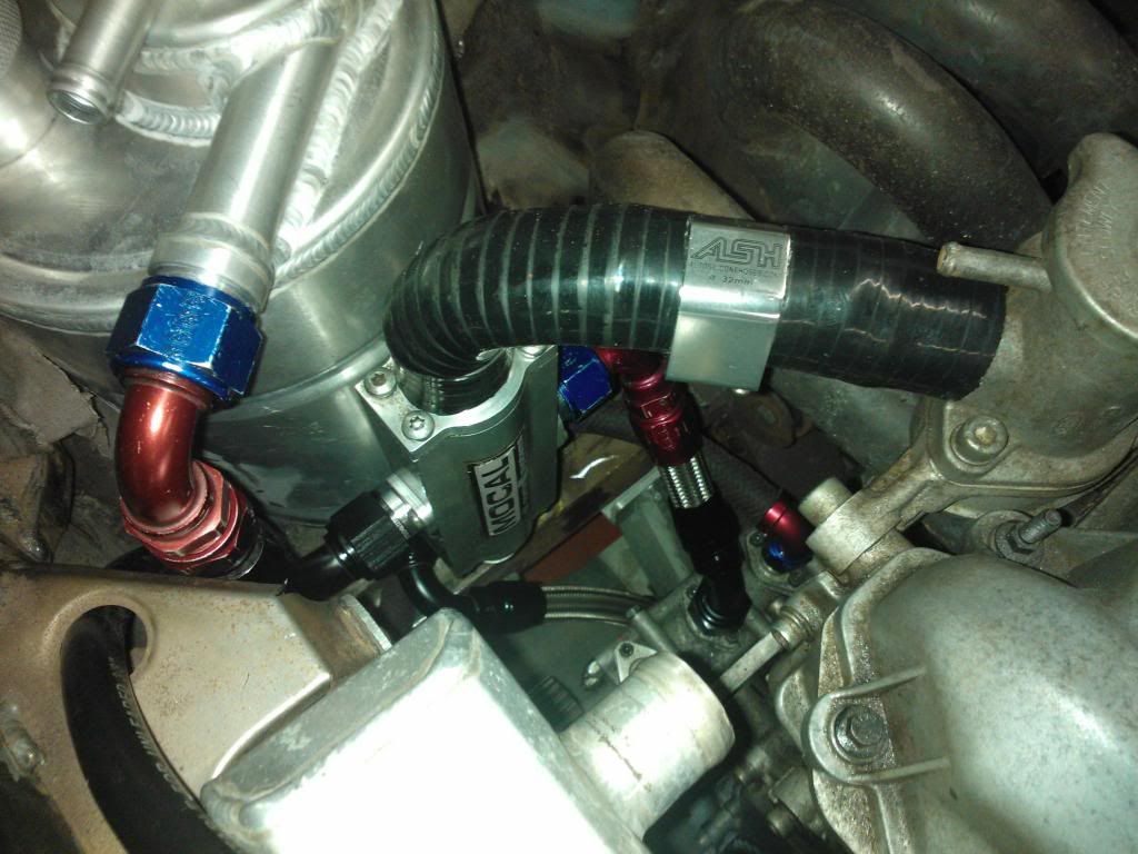

                        So some plumbing parts arrived and the -12 fittings for the oil circuit on the Laminova as it was -8 when I got it from a Caterham application. I have ordered a 90degree bend for the bottom of the laminova as a 180 hose off the bottom looked rubbish. I was surprised you can get them but found out that they do them by pure chance so ill fit that when it comes down the bottom which will let me complete the circuit back to the top of the radiator. Scary how little braided hose is needed as id say its less than a 30cm in total. I used some spare hose and now have 1.5m of brand new -12 hose left. I invested in the Torques -12 spanner and vice thingy. The vice thingy is well worth it actually. Gutted about the use of scratched -12 fittings but they came with the engine and a £30 each I couldn't not use them. Looks like I can make a mount for the Laminova on the strap that holds the dry sump tank onto the wing/holder so that's working out nicely.

                          Cant get the image to appear.
