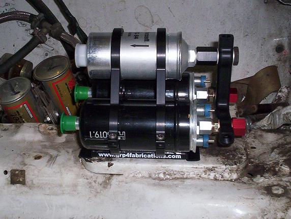

          I noticed several mk2's around recently using this pump system. Any feedback on here on it?http://www.atecautotechnic.co.uk/uk/...ssembly-4.html
              It looks similar to the one I got from Grp4 Fabrications, definitely worth it for a neat and compact installation

                I saw that one somewhere else on this forum,but that's a better image and very helpful. What's the total cost including the mount and the pump, filter etc? I don't understand why people use inlet and outlet filters can you explain why its not just inlet?
                I just had a look and its about 700 euro. Ill assess my options!

                  Re: 2.0 Duratec Tarmac Mk2 Escort
                  Yes it's not cheap!
                  My engine builder (HT Racing) said an outlet filter was more important and there was no need for an inlet filter, and I also used XR3i spec fuel pumps instead of Bosch 044 pumps as I don't need that much fuel for my spec of engine

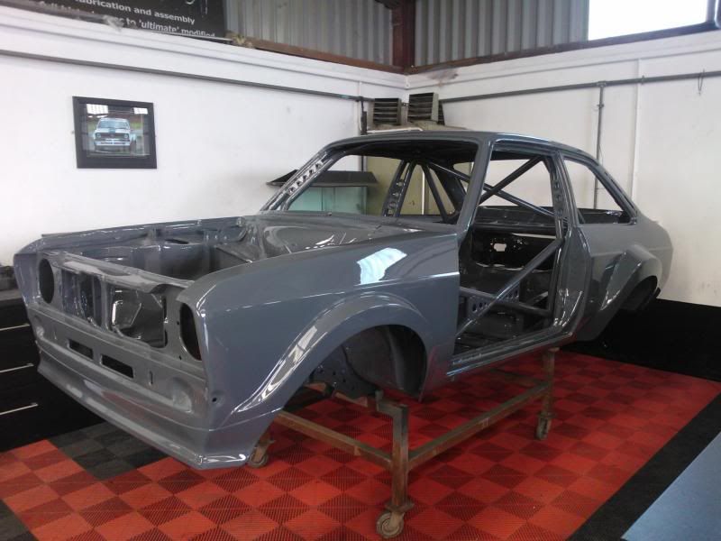

                    Sorry for the lack of update but workload and personal life took me to the decision to engage some experts to move the cars progress forward. As you can see this has been one of the best decisions yet. VW Pure Grey in case your are wondering!

                      #25
                      Lovely work, love the colour too
                            its easy to clog injectors, pumps themselves wear and containate the fuel, hense you must have a filter after the pump, but injection fuel pumps are easily jammed with debris too, i know to my cost as i lost a whole event from swarf/rubbish trapped inside a new fuel tank being sucked up the pump and jamming it, i wasnt amused, a whole days travelling. tow car fuel cost and an entry fee all for 30 competitive seconds! so from then on i always filtered fuel going in and out of the pump
