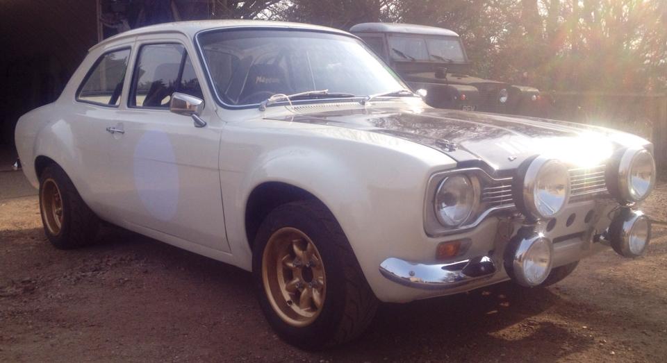

    Hi all, well the car is just about finished all but a rolling road set up and front legs to be set up.Now its built i want to start using it for a bit of compitition work ideally some sprints and hill climbs but what class do i run in?Its a crossflow powered carcaged with bucket seats, no back seats.1968I can join a local club and apply for a national b but its just knowing what class i can enter the car in.......anybody else have a simular car that they use to compete in?Thanks

    That looks very nice
    You should be able to enter a road legal class if its mot'd and insured. Then u wont have to worry about being fully compliant to the blue book.

      cheers fella, Spoke to a fella in the club i was gonna join and he said that i would have to run in modified production as i had no rear seats.

          Thats lovely! You wont be in Sports Libre unless you've swapped the engine for something never intended for use in an Escort, or substantially modified the chassis and altered mounting/pickupnpoints for the suspension etc.
          You'll be fine in Mod Prod I would have thought.

            yeah mod prod, if your suspension mounting points are original, put the interior back in and you can move to road modified. mod prod is ok but it tends to be slightly more powerful and lighter cars as they don't need to be road legal

              Cheers fellas, the car is now turreted so not sure if that's allowed in the mod prod class.

                should be able to, mod prod allows you to move suspension mounting positions providing the original suspension type is retained, i.e. live axle

                  You can't change the spring type so have to have leaf springs to run in mod prod.

                    ah that's a bit cack, sports libre it is then unless he can put the leafs back on

                        Still running leaf springs :-)
