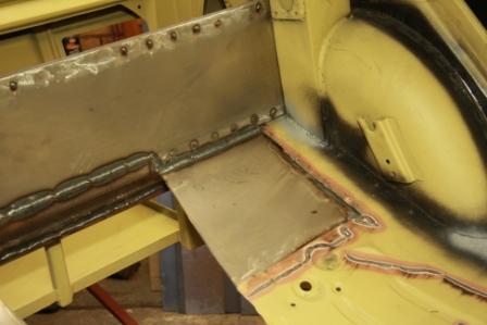

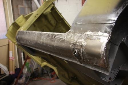

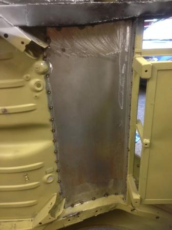

I don't think you will ever get a perfect fit with F/G arches. I fit mine as flush to the body as possible, then glass the inside of the extention onto the extended inner arch. That way adds stength and helps water proof and stone protect under the arch. I also fill the outer so you cannot see the rivetts but I know some like to show the fixings.... Personnal choice. One thing I did on the last car was to fill the area between the outer skin and the trim panel with expanding foam. Added loads of strenth to the main panel for next to no weight increase. Means you have more trouble if you come to weld it though. Has to be one of the last jobs, but definatly saved the main panel on more than one occasion.
