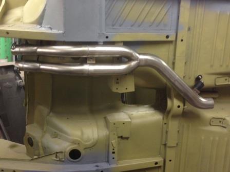

    this is the front section. I am looking forward the mocking up and building the manifold. Hopefully it will be under the noise limit in the regs!!!!!

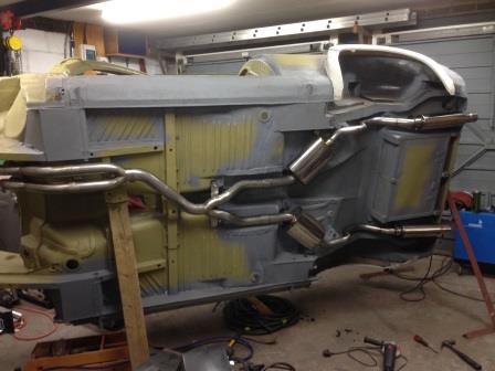

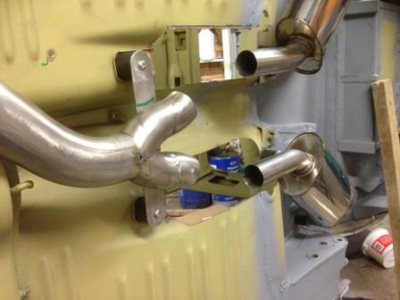

      Re: Sunbeam Tarmac Rally Car
      Hello great build keep at it it will be worth it, why are you using 2 back boxes, just wondering.

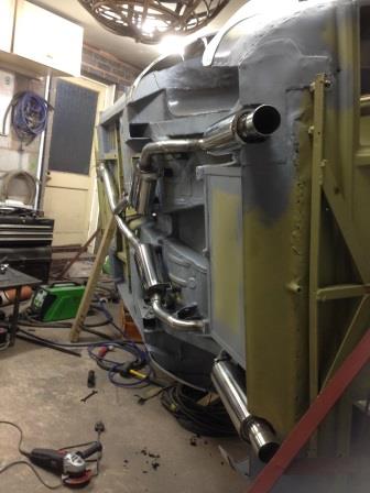

        The early works cars had 2 rear boxes. I wanted to run a large bore exhaust for future power increases ( possibly even turbo) plus I know it's a little heavier but it does look pretty swish.
          Exhaust is finished now and has been removed and stored ready for final build. I will put the front section back on again to build the manifold when I pre-fit the engine. But for now I have moved onto something else...

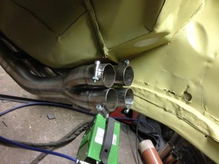

            Few pictures of the exhaust.

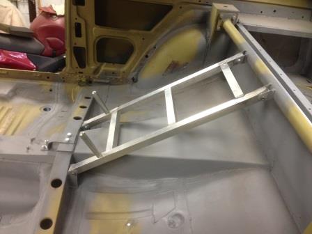

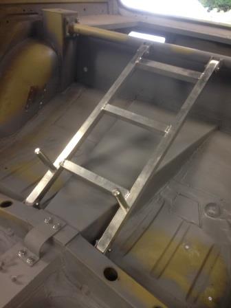

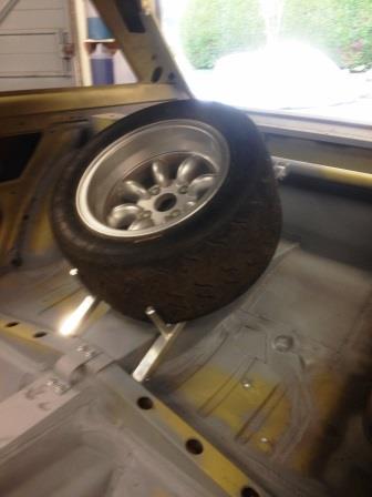

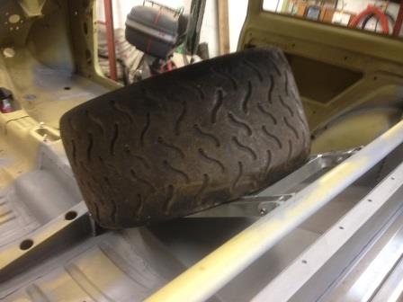

              The Alluminuim box section I ordered arrived the other day and I could not resist having a play with the TIG on AC. I know I should have carried on with the shell but these are all jobs that will need doing. I made up this wheel carrier. The idea of 2 pins as stays is I am still not 100% sure 13" or 15" wheels and this system accomodates them both. Just need to put some anker points in now for the rachet straps..

                #82
                Sorry, this one's a bit out of focus....... taken with a phone instead of a camera
                The difference between men and boys... is the price of their toys!!!!
                  • 2437
                  #83
                  Nice idea
                  Could you not get it lower though a heavy thing to have so high in the car
                  Hexham and District Motorclub
                  • rallysunbeam
                    • Apr 2008
                    • 134
                    #84
                    I could get it so the it fits flat on the rear dif tunnel but it would only work with 13" wheel and I may still go to 15" The major thing is though, where it is the whole thing comes out through the rear hatch easily. Any other position would place it lower than the rear fire wall and you would need arms like Popeye to stetch in and lift it out.... Nice thought though... Thanks.

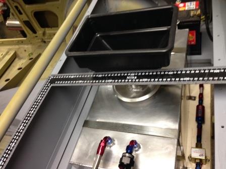

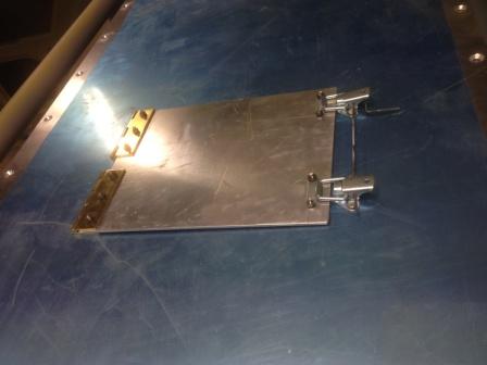

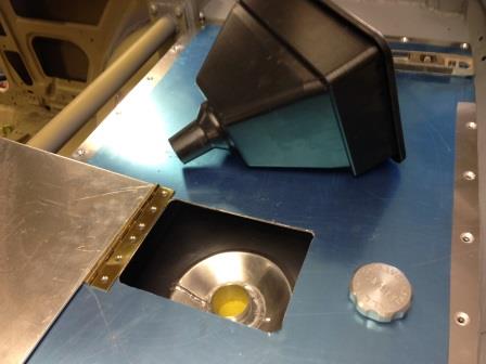

                          just read through your build,looks brilliant and im steeling some ideas for mine if you dont mind! i like the idea of closing in the fuel tank, i need to either do the same or find a way to fit a pump in the original tank to run efi. what tank will you be using and what will seal the lid you will have on top? cheers Arwyn
                          • rallysunbeam
                            • Apr 2008
                            • 134
                            #88
                            The tank came from Alloy Racing Fabrication, which was one of their standard parts. I just asked them to weld on AN12 fittings.... The top to the enclosure is metal with a hinged lid to fill the tank through. I'll put up some photoes....

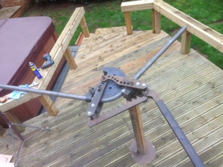

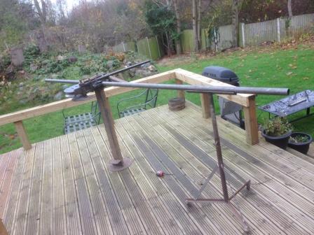

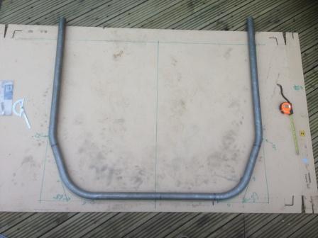

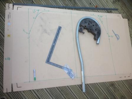

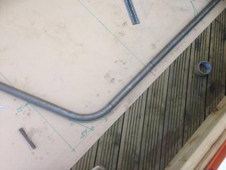

                              Busy day today as I started to make the roll cage and fitted the Navigator front seat rail.
                              Making the roll cage was a nervous time. I borrowed a bender and screwed it to the decking in the garden. Started by measuring and remeasuring to draw an accurate outline of the interior of the car.
                              Set up for 1st bend... scared.

                                45 minutes later after a bit of fettling I had the mail loop done. I cut it to length and tst fitted it to the car.
