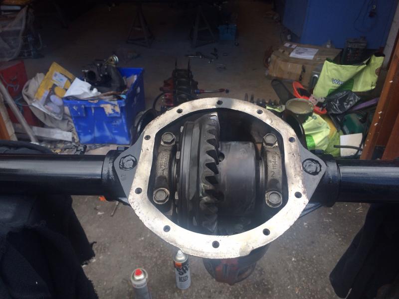

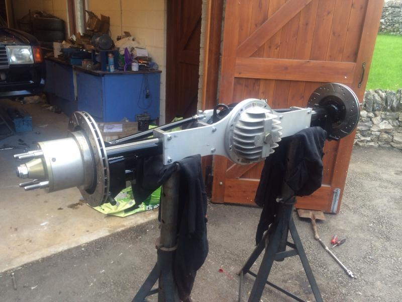

    One question, whats the threaded flange for inside the fully-floating-stub for on the axle? Calipers?
    Yeah, they are flanged for a varying choice of caliper brackets. They are a new development from Fostek engineering.

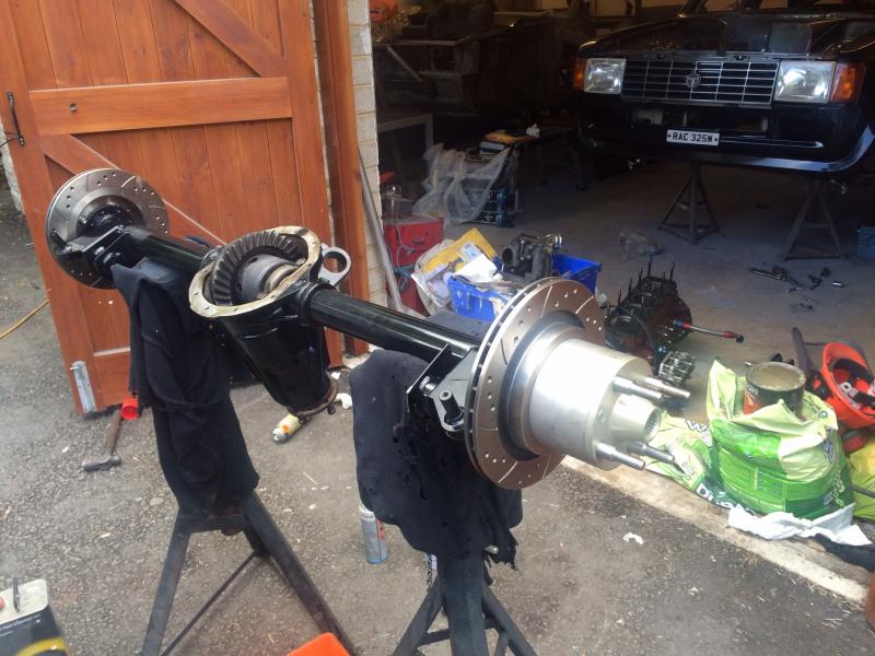

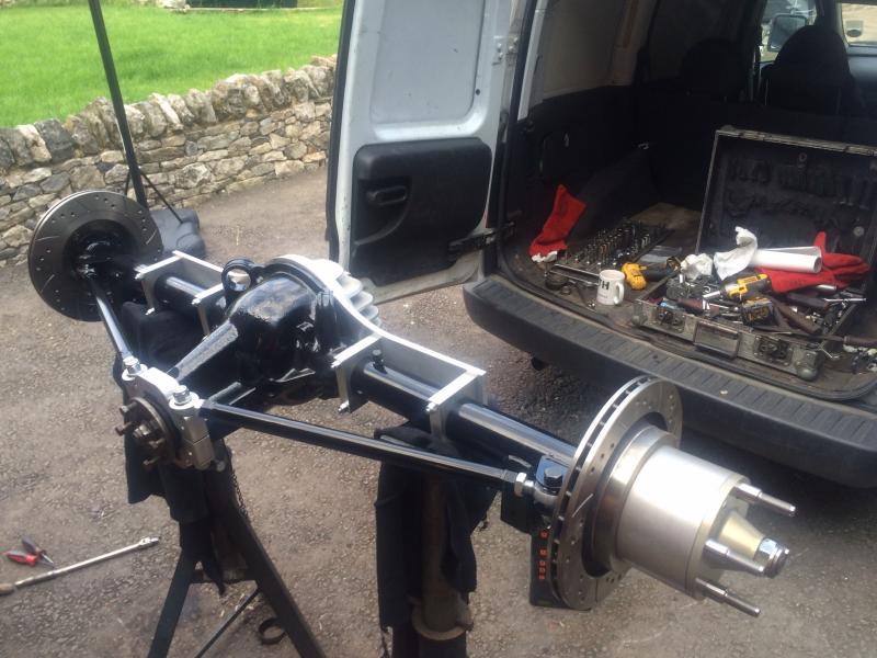

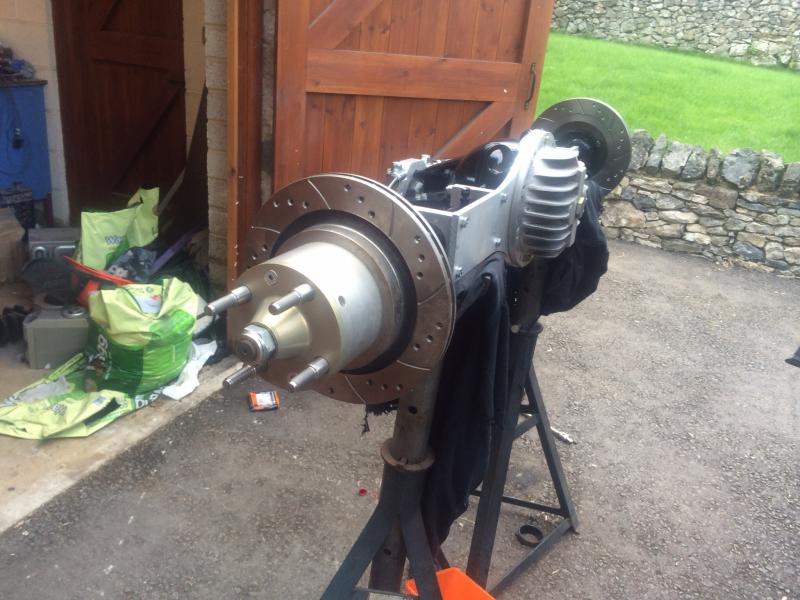

        So, made a start (almost finished it if I am honest) on the axle......................

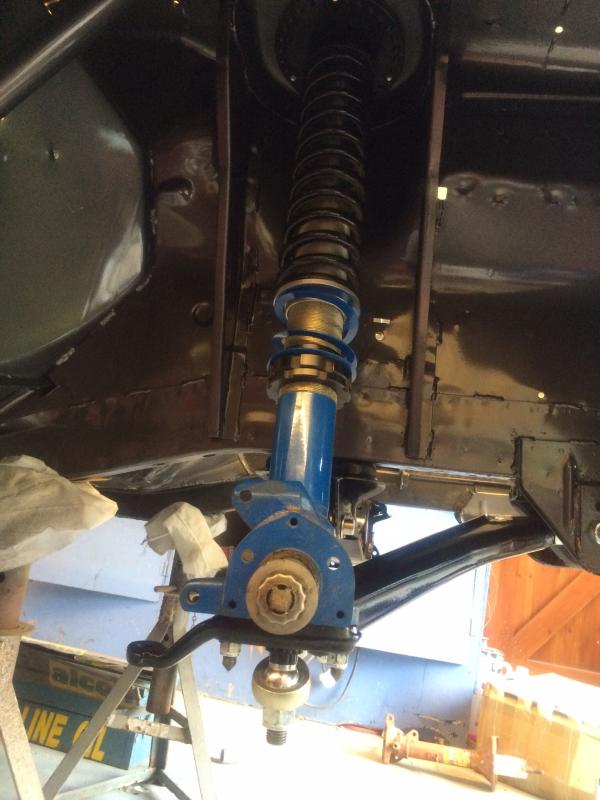

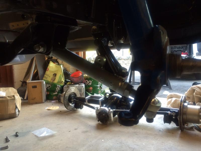

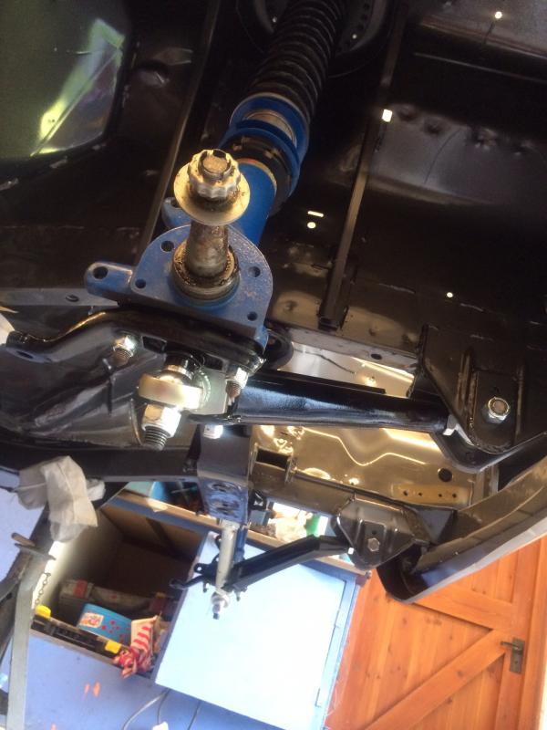

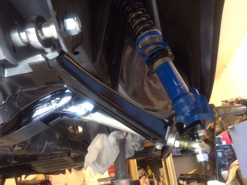

        Then threw some front suspension at her, the suspension is an exact replica of the works set up.................

              Love the build, I currently tarmac rally a sunbeam, can I ask where you got all the front suspension/steering parts pictured and also the brace for the pigs head ?. Ive had real problems with steering racks, you going works spec 2.2 ratio or something a little lighter ?.
                  Hi, sorry it's taken so long to reply..........
                  The front Suspension came from Jim Little, he calls his company a Little bit sideways if you google it. To be honest, it fairly expensive, but there was a guy on the ASOC forum selling the same kit unused for a considerable saving, I almost bought it as a spare set. 2.2 rack but Corsa power steering.
                  I fear understeer...
                  • Sunbmw
                    • Feb 2009
                    • 290
                    #24
                    Re: Sunbeam stage rally car...............
                    Oh yeah, the axle "Toe correction kit" as they are known came from Phil and Mick Squires.

                        Sorry for the delay, much appreciate the info, just going for corsa power steering myself. Keep the build pics coming, its good to see.

                            Hi Sunbmw, What width is the axle, (half shaft flange to half shaft flange), to fit those arches?
                            • Sunbmw
                              • Feb 2009
                              • 290
                              #29
                              Hi Roy, it is 57" wide flange to flange.
