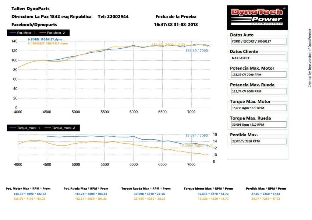

                  Some photos of the last race 2 weeks ago:
                  The water pump belt failed (or decided to get off the engine) and I had to retire.
                  This is the latest power plot before the race. Blue lines are the newest, the yellow one was the one from the previous race.
                  I still have to carry a lot of weight because of the power (Remember the regulation of 7.5 kg per HP)
                  If I can flatten the power curve at the top where it gets to around 125 I can unload 75kg, which is would be great cause it is really affecting the car's cornering and braking behavior.
                  I'm thinking about limiting the current advance curve, do you think it is possible to achieve it like that?
                  I really don't have much time to work on any other heavy change in the engine between races.
