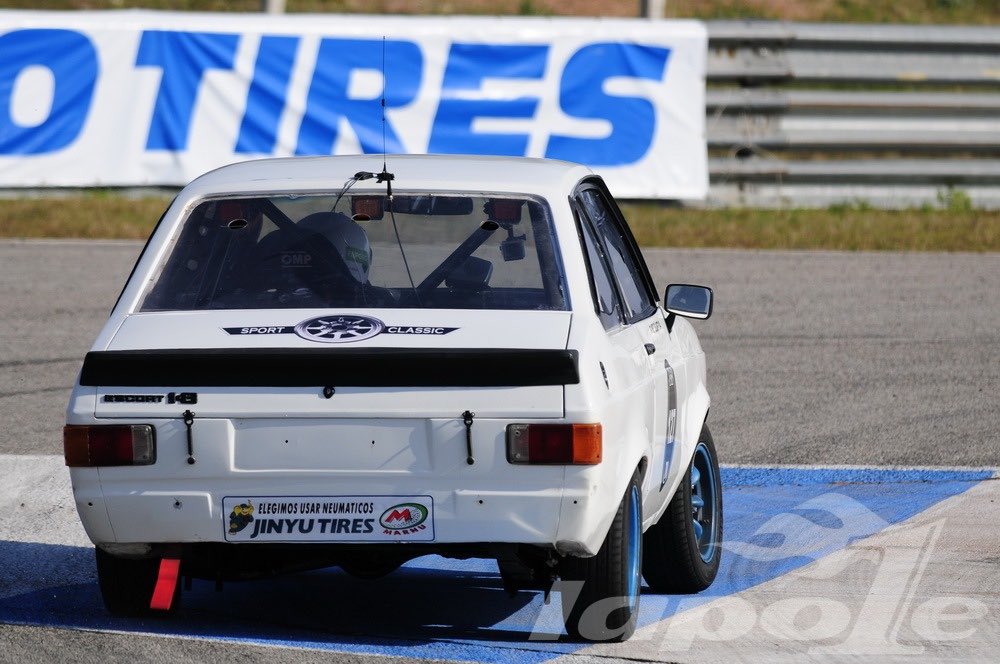

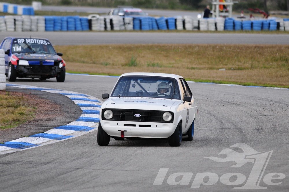

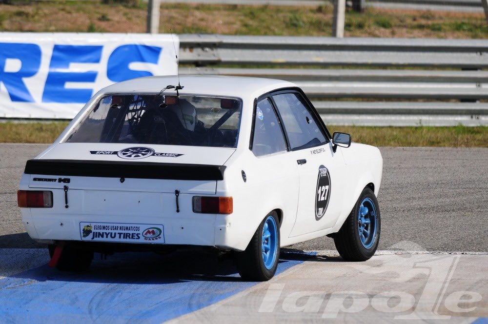

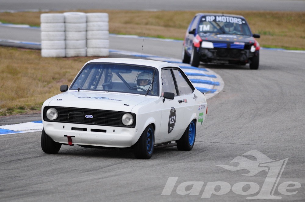

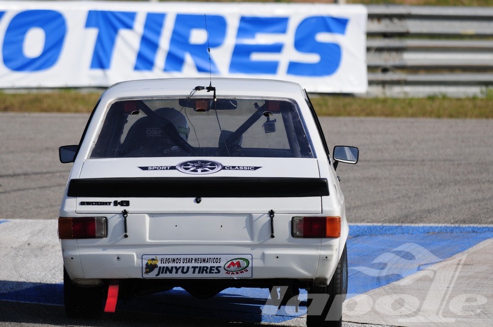

              Some photos of the last race for references on body roll and to make the thread more interesting

                      its looks pretty good i would have said,maybe drop the front ride height a bit,
                      it looks as if your on around 3deg camber,5deg castor,i found less of both worked better with softer springs.
                      as minilight says change one thing at a time and see how it feels

                        As turbospud said on the photos the car looks to be "sitting" ok.
