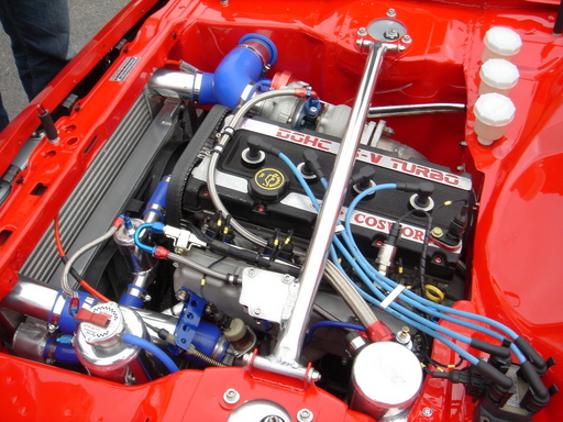

    Then the bug really hit me and i finally gave into moving on and going Cossie turbo power. Im a carb man through and through,but you just cant beat the rush you get from the power of a turbo'd car,they just dont ever loose their sheer grin and fun factor.
    My car's not a race car as such,more of an all around type car so to speak. Been heavily into drag racing over the years and only recently got into doing track days. The old school track day at brunters last year was my first ever track day. Which i really enjoyed.

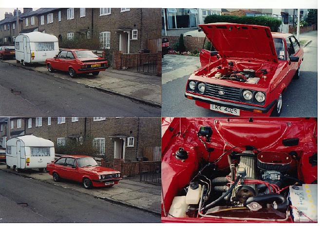

          Re: Kevmk2 - Mk2 Escort - YB Cosworth Turbo

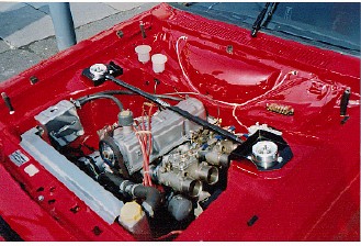

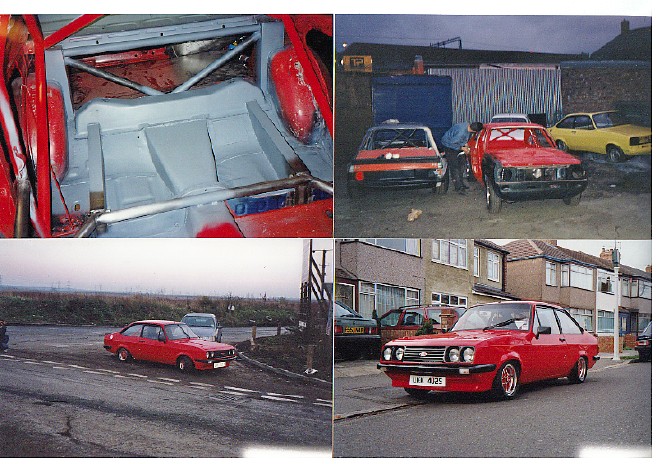

          Heres some pics of when i brought it
          Then during and after the restoration
          Then when it was 2.2 pinto powered Mmmm 50's

                And heres a spec sheet i made earlier
                Body:
                Stock RS2000 Shell,Fibreglass bonnet and bootlid.
                Doors drilled for lightness with starret Cutter.
                Grp4 Style Large Gearbox Tunnel.
                Single Wiper from Fiat Uno.
                Colour Radiant Red
                Engine:
                Bottom end:
                Cosworth YB.
                Ford Motorsport 200 Block
                Coopers Rings
                Cosworth Forged Pistons 8:6:1 compression ratio
                Knife Edged Crank
                RS500 Rods
                Oil spray jets
                H.T Racing Big winged baffled Sump
                Long Studded head bolts.
                Bailey Oil Seperator.
                Dynoed @ 405bhp and 450 Ft Lbs Torque (Field Motorsport Dyno)
                Top End:
                WRC Head Ported and Polished
                Double Valve Springs BDG Spec
                Lowered Platforms in head
                BD14 Inlet Cam
                BD8 Exhaust Cam
                Phase sensor on rear of rocker cover for dizzyless ignition
                Turbo:
                T34 Hybrid With Restrictor pipe fitted but unrestricted (waisted inside)
                Forge -34 Actuator .63 Exhaust Housing.
                Injectors/Fueling:
                8x Dark Blue injectors
                WRC Inlet Manifold
                O-Ringed to head
                Mountune Fuel Regulator (5.0 Bar)
                3 Bar Map Sensor
                -6 Braided Fuel hoses throughout the car,run inside.
                Bosch 044 Fuel pump
                Holley 110 Gallon per hour lift pump
                Alloy Swirl pot.
                Cooling:
                The Rad and intercooler are made for cosworths,my mate jason made them fit an escort.
                Pace 50mm Rad.
                Radtec RS500 intercooler.
                2wd Cossie Fans.
                Silicone Hoses throughout.
                Bailey Swirl Pot.
                Pace one off Header tank. (thanks dan)
                Electrics:
                P8 ECU with Anti lag and pectel piggy back board.
                Zetec Coil pack.
                Ford Motorsport Plug leads.
                Motorsport wiring loom.
                Twin Ignition modules.
                Exhaust:
                Mongoose 2wd Sierra downpipe cut and shut to fit.
                Hayward and scott stainless centre section.
                Mongoose 2wd Sierra Rear box modded to fit.
                Transmission:
                2WD Flywheel and AP 4 Paddle Clutch
                T5 Borg Warner Gearbox
                Pro 5.0 Mustang Shifter
                One Piece Prop (bespoke)
                Hydraulic clutch.
                Axle:
                Atlas Axle Shortened By H.T Racing
                Quaife Grp1 Two Piece Halfshafts With ZF splines
                Zf Motorsport LSD with twin clutch plates. 70% lock.
                3:7:5 Diff Ratio
                Suspension:
                Front: Gartrac Bilstein 300/70 rated short legs with 2 1/4"350lbs springs.
                Rose Jointed top mounts (eccentric).
                Alloy Hubs.
                Rose jointed adjustable Track control arms.
                Rose jointed compression struts.
                No anti roll bar.
                2.0 Degrees Neg camber.
                Rear:
                Leda 24 point Adjustable 2 1/4 Coilovers with 14" 150lbs springs.
                5 Linked with rose joints.
                Brakes:
                Bias Pedal Box made by H.T Racing
                All Brake lines Braided and run inside the car.
                Hydraulic Line Lock.
                Front:
                310mm two piece Vented Discs with AP Racing 4 Calipers.
                Ferodo DS3000 Pads.
                Rear:
                XR3i Front discs and calipers mounted on axle.
                Ferodo Standard Pads.
                Alloy Fly off handbrake.
                Wheels And Tyres:
                Compomotive ML 7x15 Grp4 Style
                195/45 Toyo Proxes TS1 Tyres.
                Interior:
                Sparco Evo Seats.
                Willans 6 Point Harnesses (FIA SPEC)
                Stack ST700SR Tacho/speedo with boost display and fuel pressure.
                Racetech Oil pressure gauge
                Racetech Water Temperature Capillary gauge.
                Smiths Fuel gauge.
                All mounted in carbon fibre.
                12 point Safety Devices Roll Cage. Welded in.
                Ralloy Alloy centre console with relays and switches.
                Rs 4 Spoke Steering Wheel,on quick release hub.
                Dash top flocked by Central Blast Cleaning.
                Standard Rs2000 Door cards.
                Alloy firewall.
                Large diff tunnel.
                No heater.
                Underside of car painted red body colour.
